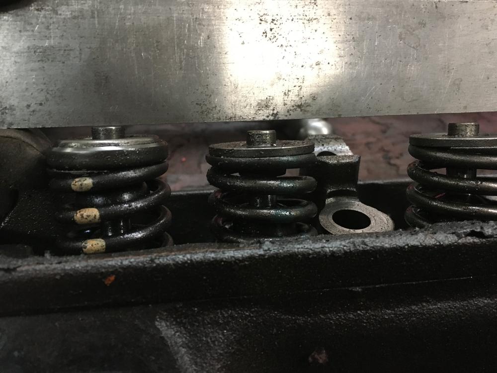

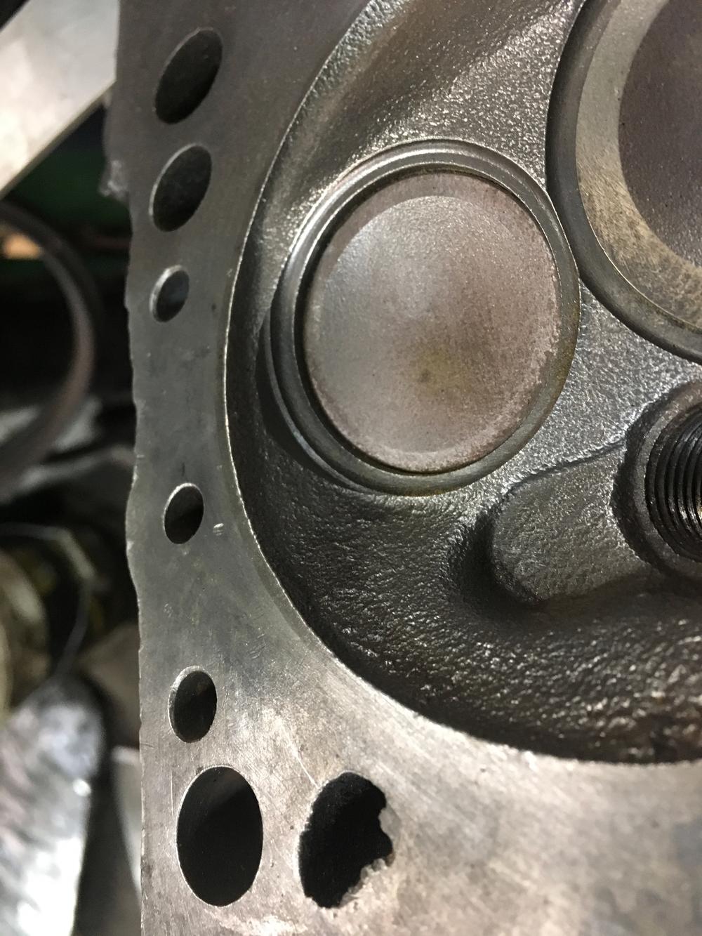

A commonly expressed opinion on these forums is “This thread is worthless without pictures…” so, here you go. The first photo is of an exhaust valve and how far sunken it is. Note: the combustion chambers were thoroughly wire brushed in preparation for magna fluxing the heads to check for cracks.
An obvious question is “How can I tell if my engine has this issue without removing the cylinder heads”? The answer is to remove the valve covers and rocker arms, and then place a straightedge along the tops of the valve stems. They should all be pretty close in height, and if the exhaust valves are significantly higher, that would indicate a problem. Here’s what I’m talking about. Ruh Roh… Not good!
