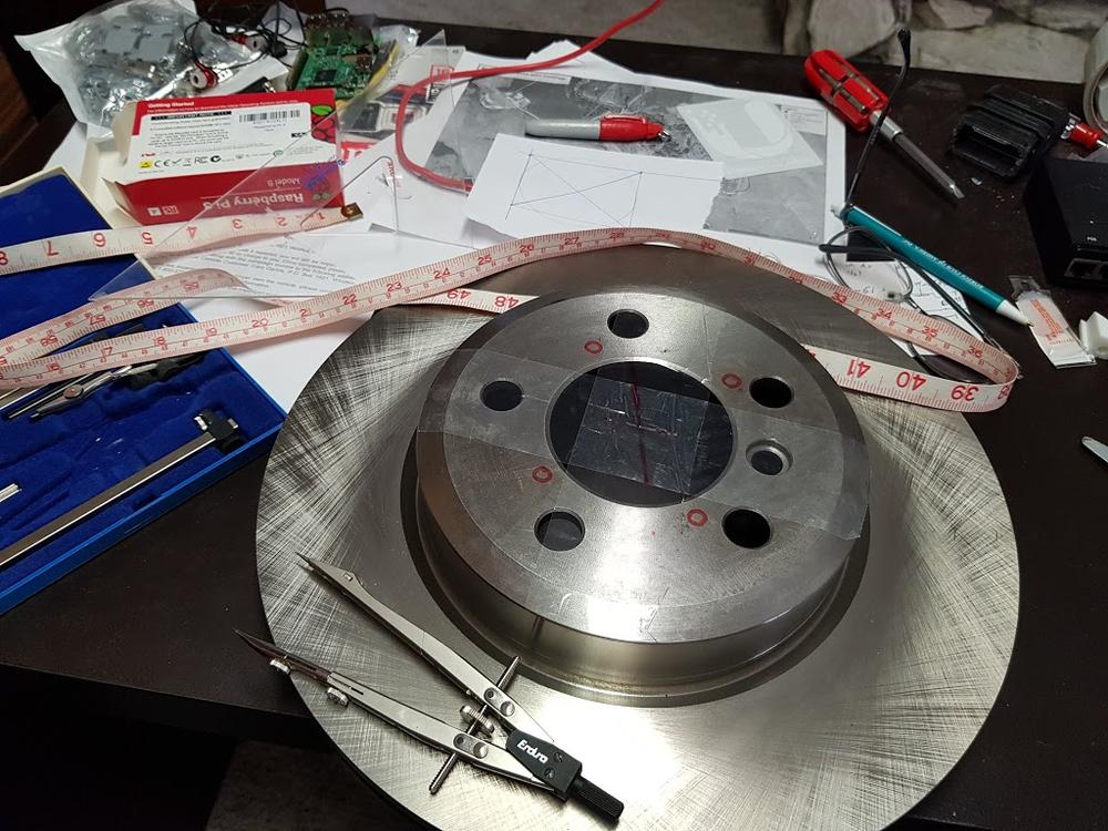

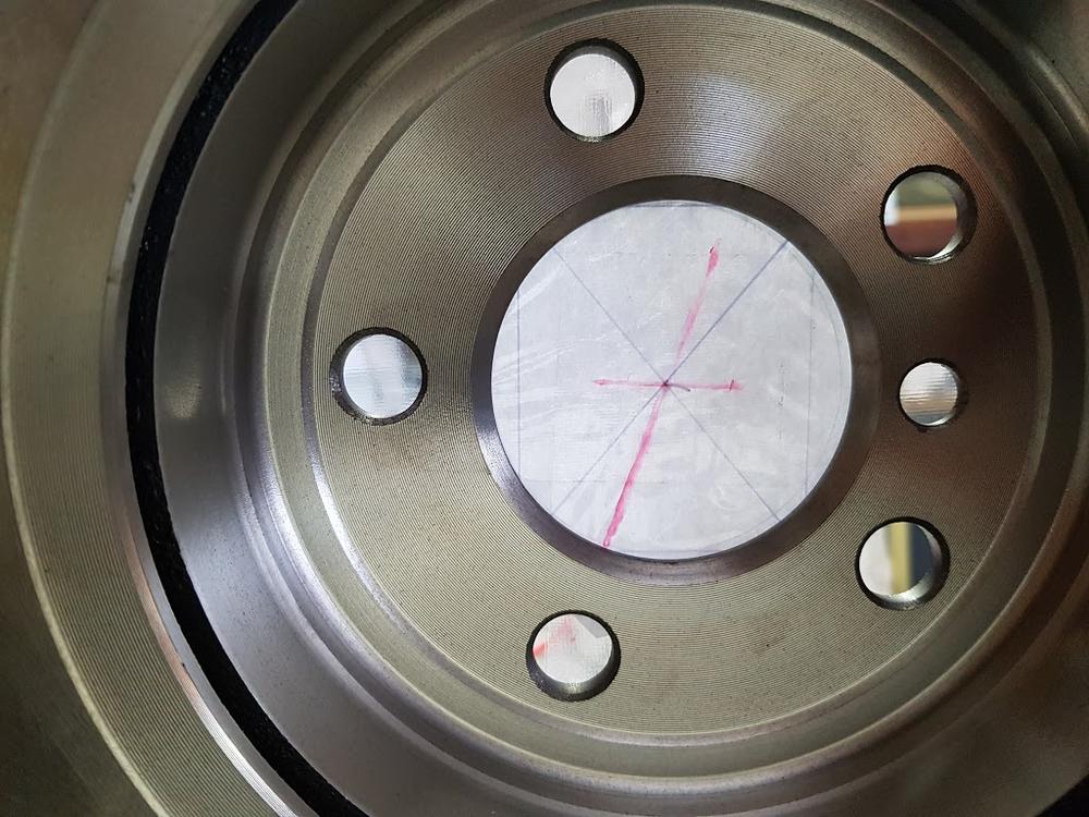

rockhead
Locate the center, overlay template, missed it by a couple mm, then ready for center punch and drill

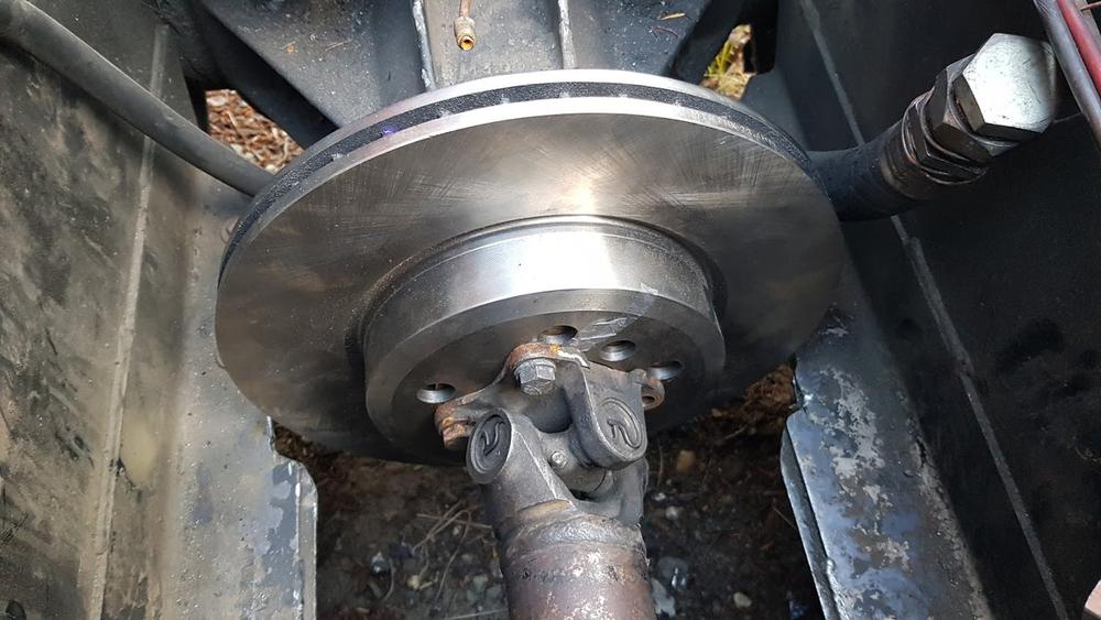

rockhead
Ruh roh disc is yoooooge, chop shop time, and then ... 1 (stripped) bolt away from self propelled again:drive2:

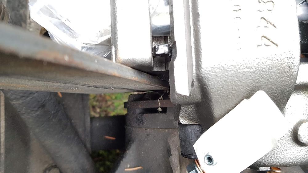

rockhead
The caliper drops into place like it belongs there :clap:
The alignment of the backer and the caliper is amazingly close to just 1/4" plate:wink:

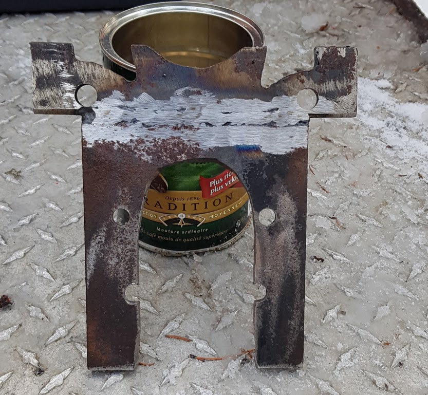

rockhead
ohhhh and from fabricating shop of rude crude and lewd the caliper bracket
