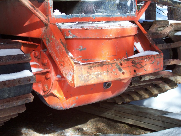

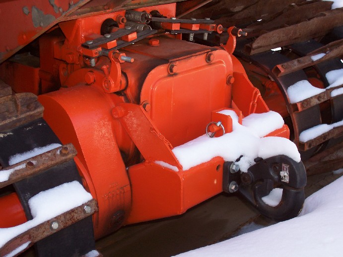

OC-4, OC-12, and OC-15 steering differentials used in Thiokol Snowcats.

Thanks Mtncrawler! Those photos will help all of us who aspire to add another snow cat to our collection with easy identification. Perhaps another member can post contact info for parts/rebuild service for each of those rear differentials?
I would like to make a correction to the above statements.
The Imp uses a C-4 rearend, not a OC-4. The "C" stands for Clark, who was the manufacturer. The OC-12 differential was named "OC" for Oliver-Clark, who was also the manufacturer. I am not familiar with the -15 differential, so cannot comment on it. :confused2:
I hope this helps people looking for information on these differentials. I've seen a lot of confusion on how they work and how they are to be operated too. Some confusion is also found on the oil that should be used for band lubrication and heat reduction. Peterson's Equipment has probably done more repair and overhaul of these rearends than everyone else combined. In talking with them, they caution the use of lighter oils then what is specified. :confused: I have read the manuals and talked to operators for information on the proper handling of the steering systems. Let's get some comments from experienced people on how to operate and "not" operate the steering of these differentials.:thumb:
Thanks!
The first pic is interesting I have never seen an oc-4 diff with drop boxes. Was this to handle longer axles, more wieght for the Spryte?
The drop boxes for the OC-4 are chain reductions. The drop boxes for the OC-12 are gear reductions available in both 2.44 or 1.83 ratio.

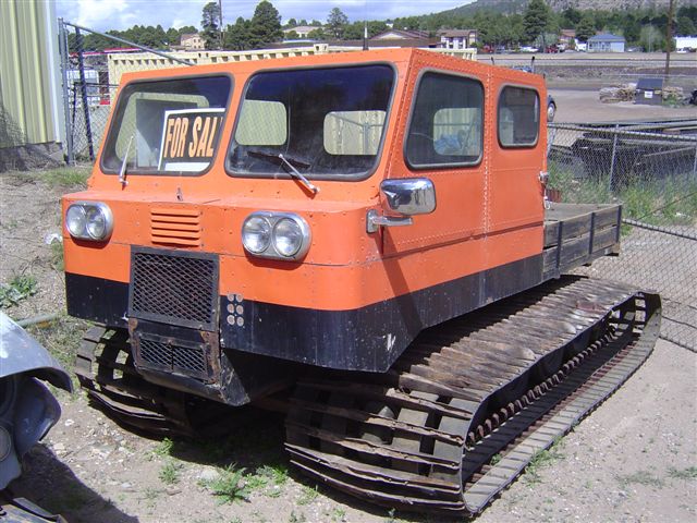

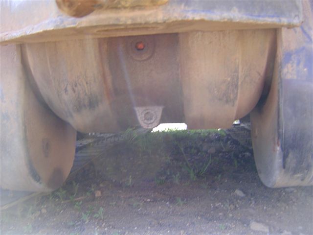

My good friend Bob P. Found this Thiokol. Here is a pick of the rear end. Looks like an OC-12

On my OC-12 pictured on page one of this thread you can see all the dirt attached to the oil on the oc-12. The whole top plate was loose. Which is why it was leaking oil. Each bolt needed to just ever so be tightened. There were a few real loose ones. My question is, is there a gasket that I can buy for the top or do I just use a tube gasket material?
