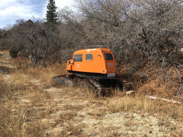

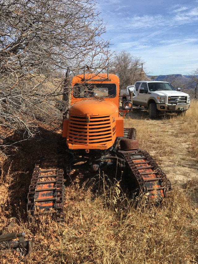

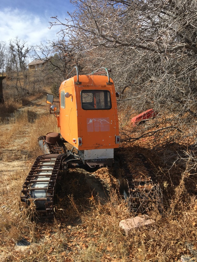

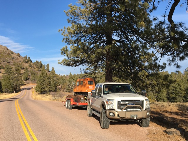

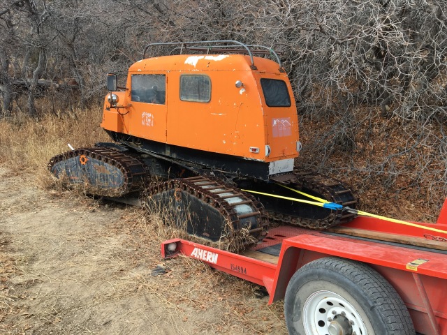

Excited to report that this 1950 Tucker 443 was captured on Kolob Mountain Utah after resting for the last 23 years. This Tucker was originally sold to Sausman Motors in Jackson California. Whereabouts unknown for the next 30 years it was purchased by Joe and Mary Priest to live year round on Kolob Mountain from 1980 to 1995. Kolob has no winter access so this was their access to the world for a 10 plus mile commute to the nearest plowed road. In 1995 due to their age they left the mountain and the Tucker has sit quiet for the last 23 years. My friend and I captured it a few weeks back and it now lives in Las Vegas to be given some love to be snow worthy again. It will return to Kolob Mountain to be enjoyed by the next generation.
I look forward to the forum and learning from the wealth of knowledge I have already seen on this forum. I have so many questions..... stay tuned!

Welcome aboard. Nice find you have there. There is a wealth of Tucker knowledge here. Looking forward to seeing it running again.

Nice find!!! that machine still looks pretty narrow,like my 1949 machines, the 1953 i have has a wider cab. They must have changed the width shortly after 1950. I see the fifthwheel assemblys are cast steel,check them over good ,my 1953 has a crack by one of the spring hangers. That tucker looks like it was pretty taken care of by its previous owners. Don
Wow, great find! They are still out there! This looks like the rare and coveted taper back. I bet you get a few people wanting to buy that. Looking forward to seeing what you do with it. :horns:
wow, great find! see they are still some out in the wild,
your best source for wisdom and knowledge about your Tucker, is Jeff McNeil, at Tucker Sno-Cat, he heads up the Vintage department and pretty much knows everything there is to know about these machines.

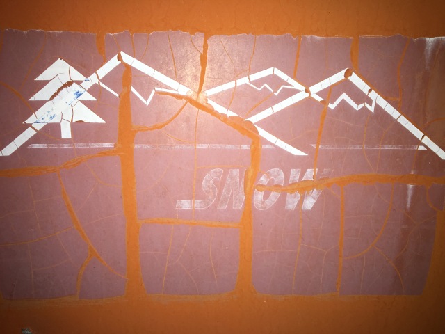

The faded decal looks familiar on the back door of it says Sierra snow taxi I may be able to dig up some history on that
mr loggah, the body was widened during the production run of the 1950 models.

The rear image just says snow.... love any history you may have....

I own a 1950 serial No. 150125 taper back 443, do you have serial No. for yours, there are 4 to 5 of these machine and about the same number of the wider body 1950's
I'm having trouble posting images but that is the Sierra snow taxi decal the gentleman who operated that business was from my area and he had an early 50s Tucker i will get in touch with him maybe he will have some missing history for that cat

the roof rack looks like what the phone companies installed, you said it was sold to Sausman motors originally, if you have either a serial number or engine number, the original owner can be identified and more of it's history can be traced. Interesting, Sausman Motors is not shown as buying a Tucker Sno-cat in 1950.

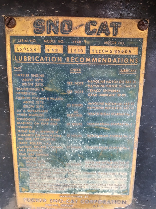

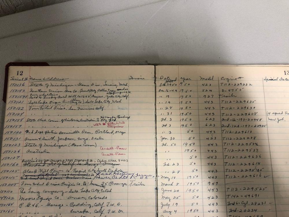

My serial number is 150124.... from the book Clyde from Tucker sent me it appears 2 were sold to Four Wheel Drive, San Francisco; however above in pencil it is written Sausmon? Motors, Jackson CA.
Notes on the side say the one I have has a 4 speed transmission.....Kind of cool!

great, info, does look like 150122 has the pencil in info and 150124, pretty sure FWD ordered it and sold it to Bell telephone, as Bell was a major buyer of tuckers way back when
kewl to have the 4 spd, there were several other 1950, 443 sold with the 4 speed transmission also

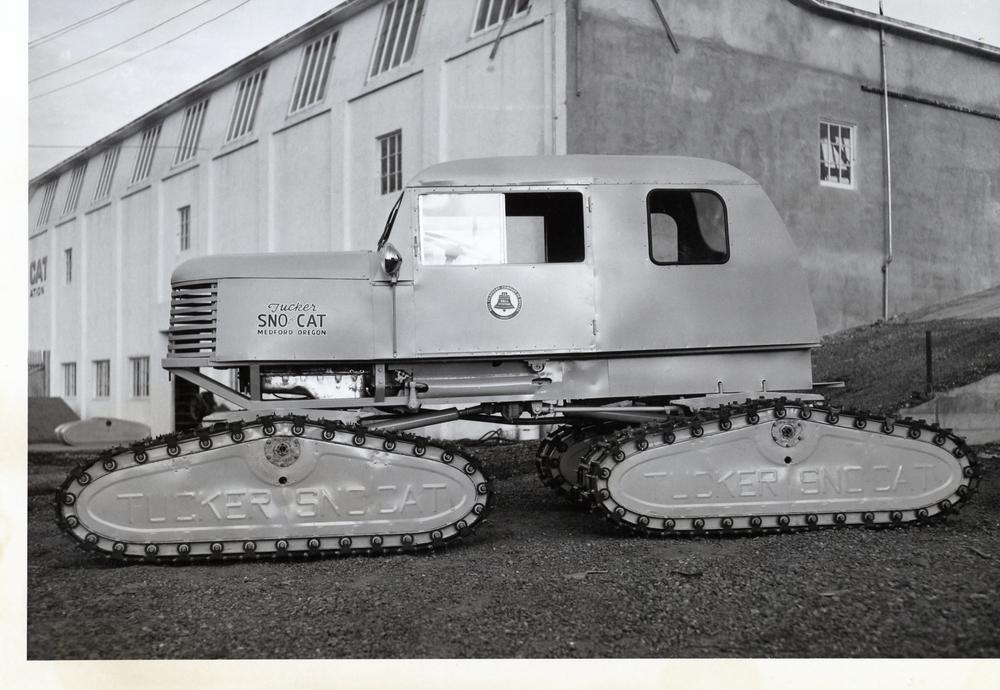

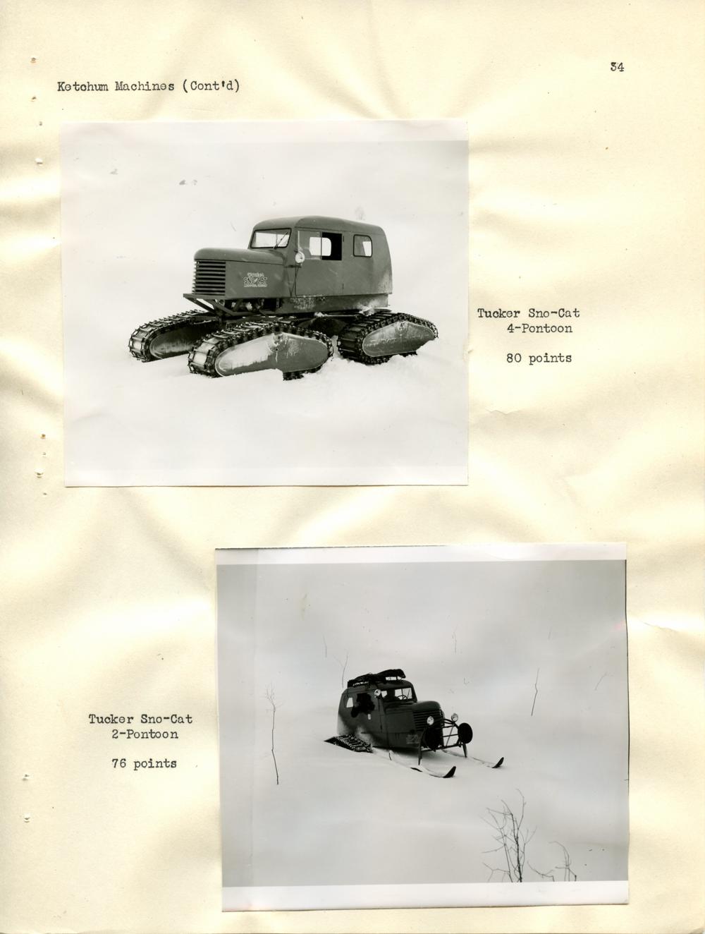

a few tapered back photos from the time period

Imolson
the photo of the taper back with the bell logo should be your tucker sno cat
bell telephone only bought 1 tucker 443 in 1950 and the roof rack is a bell telephone add on. have several other bell cats with the same rack on them
believe my info to be correct, good luck with your tucker
Princess- Can you elaborate on the steering linkage seen in the bell telephone pic. It looks like it has a custom sheet metal guard/cover? I did not notice that in lmolson's pics but it could be disguised with the black paint.
simple, first the pontoons are not the original ones,they have been changed to a later design and the steering has also been altered at sometime, all fairly common in the life of a Tucker, thus, that is why it is so rare to see a untouched Tucker, owners did whatever it took to keep the machine useable.

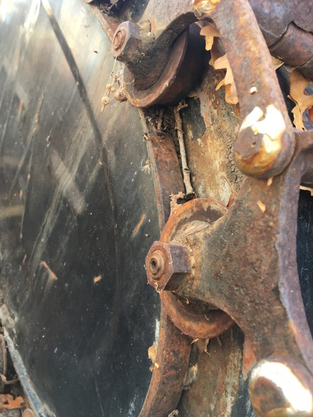

First question: Track Rollers are an assortment of sealed(i think?) Greaseable and Nylon? The flanges seem sound and the bearings are without play. In the attached picture the one on top is the original greaseable roller, but what is the one on the bottom? Sealed? I plan on replacing the nylon, but any other pointers on assessing the rollers?

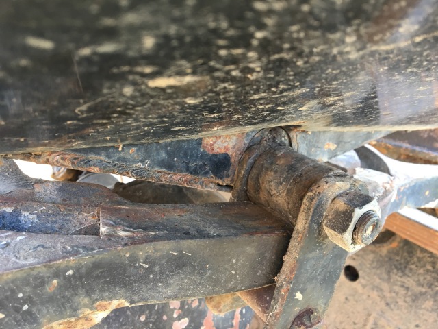

Second Question:
The front fifth wheel has a shackle in the front (see second picture) it appears this slides as the bottom is flattened. Is this suppose to roll? Any upgrades to this?

The upper photo roller is the early design which you have to take the screw out to grease. The other is the later design which has a ball check and you need a fitting on your grease gun which you press tight against the female grease fitting on the roller. You may be able to get by with a needle fitting on your grease gun. For long life with the rollers, use Lubriplate Low Temp grease. The front fifth wheel roller should roll. Take it apart and if it is flat on the bottom replace it. I would drill and tap the horizontal bolt and cross drill it so that you can lube the inside of the roller. The nut on this bolt should not be tight enough to prevent the roller from turning. Drill the nut or use a castellated nut and cotter pin.
