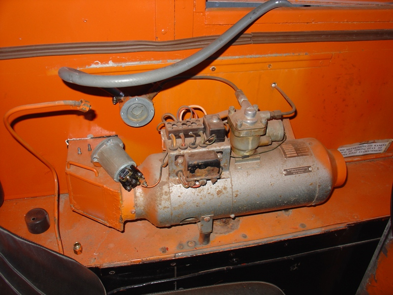

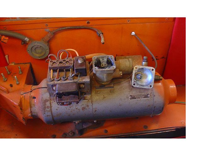

Does anyone have an original gas heater for the Snow Trac? I just purchased #291 and would like to put a gas heater back in it. Were they made by Eberspacher? I would like to purchase one if possible and manuals too. Thanks in advance.

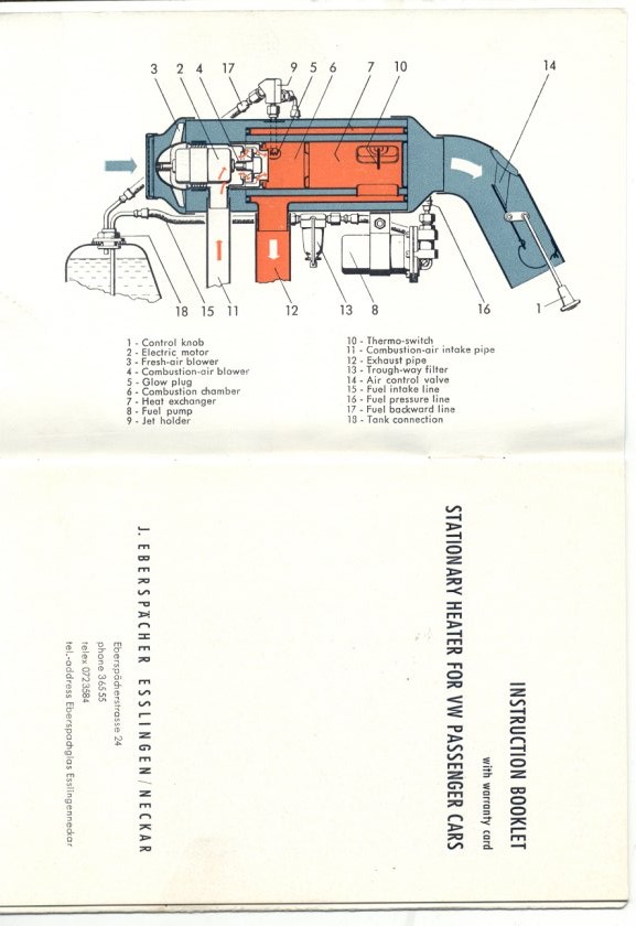

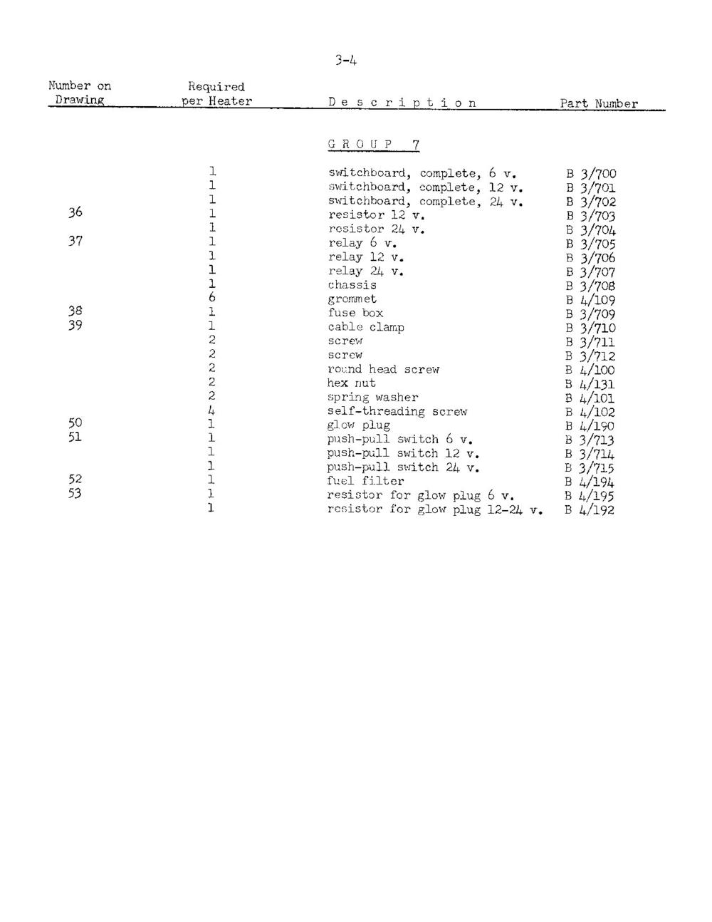

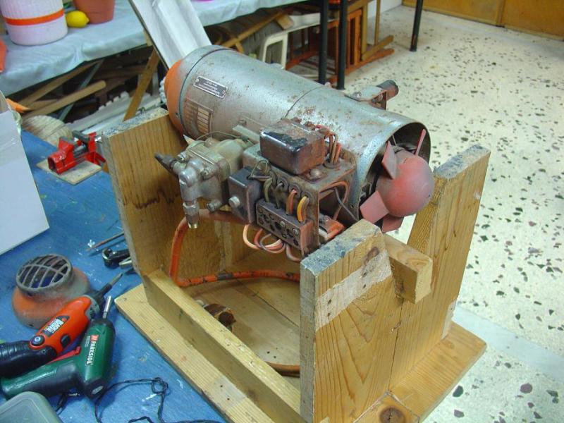

I am in the procedure to fix the gas heater BN2 (Eberspacher) in my Snow Trac. It works but i need to replace the 12V fuel pump Hardi E57. No feed fuel to the gas heater, and I couldn't find the diaphragm Solenoid Valve kit.
Anyway i am not the right guy, as an auto electrician technician with experience in diagnostics, to chech or to repair the installation of electrical systems.
But i know the right guy for this job................ to be continued.
Nikos
THE BN2 GAS HEATER
Page 1, 2, 3, 4.

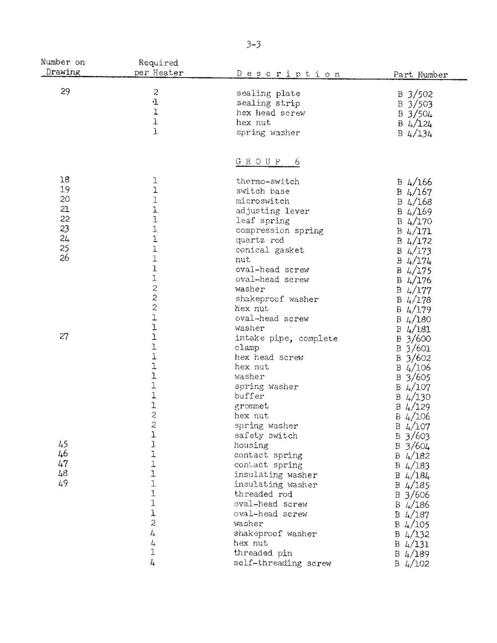

page 5, 6, 7, 8,

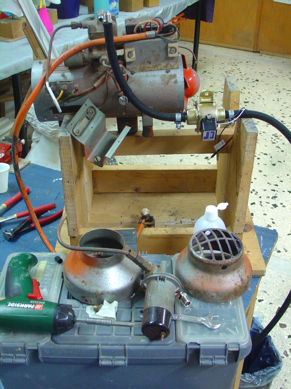

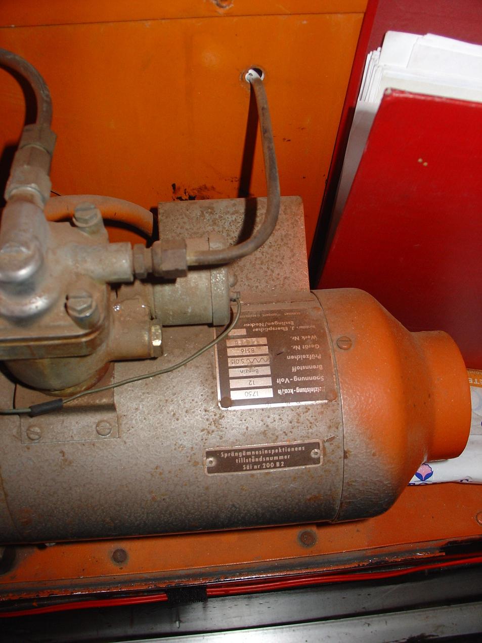

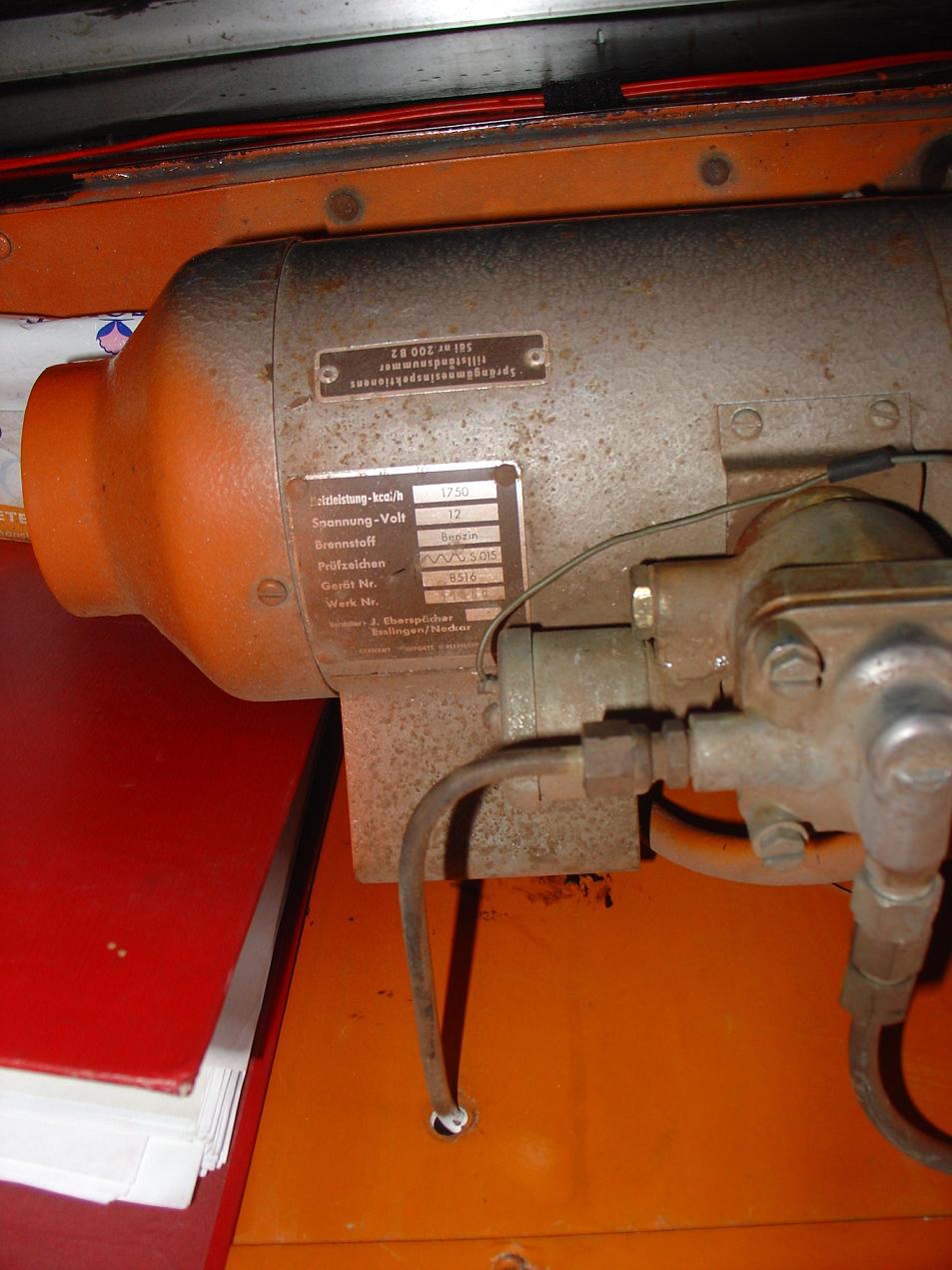

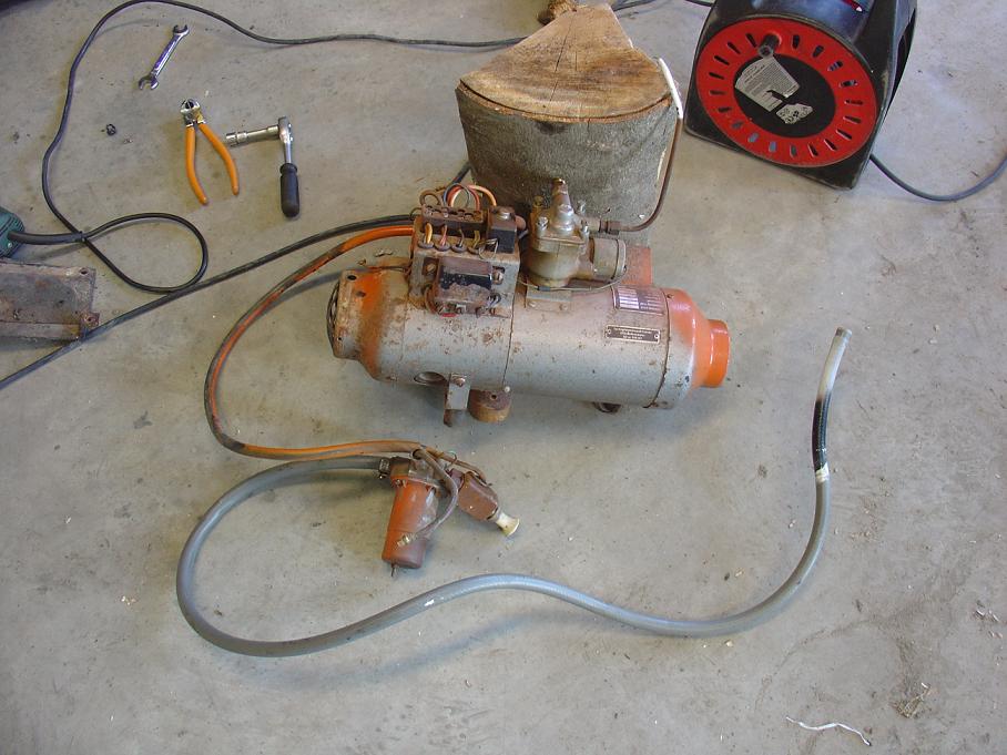

The ID Plate. As you can see the Eberspacher heater is 12 volt.
The heater is another part inside the cabin of the ST4 that i would like to make it function. I dont know if i want to use it, even if the fuel tank with the 0,5 gallon it is outside of the cabin.
Anyway its a great opportunity for me to study the manual, and a chance to see or to realize how it works, and thats why i will try to start and replace the fuel pump and some of the wires with a guy that his father was the main technician in that kind of VW heaters.:hammer::hammer:
I know that in the market there are too many modern functionally equivalents heaters like Webasto 12V etc but at this time I am not thinking about anything. I am here with the Eberspacher.
Nikos

Nikos, thanks for taking those pictures, they tell me what I needed to know. I think you will be able to get the old heater running, they are very simple and safe. I have worked on hundreds of gas heaters since the 70's, mostly South Winds but the Eberspachers are a good heater too.
I've seen dozens of VW's burn because of the fuel line inlet to the carburetor on the engine, but in all my 40 plus years of VW and gas heater service I've never seen a burned gas heater! I know people are worried about these heaters but they should be more concerned about the VW engine and always carry a charged fire extinguisher.
Thanks again for all your help, looking forward to getting #291 back on the snow.

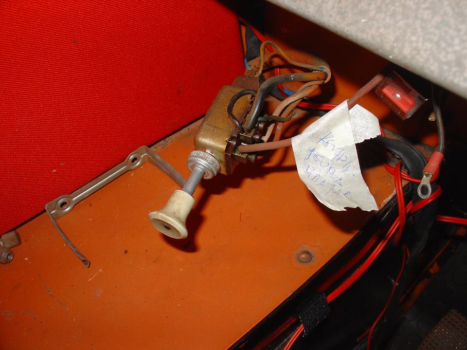

About the controls. The heater is controlled by pulling the Knob on the dash.
(The orange wire in the foto) Surely there is a timer for the run, The Air Blower and the Glow - Heater Plug are working fine, but i don't know exactly how it works with the fuels - with the new fuel pump. About the thermoswitch, the overheating switch, the Jet carrier, the spiral coils of the resistance, and the juction box for the electric cables and the other details about the run time, i must ask the electrician.
I am working so hard in a project, until the end of March, and that's why i didnt realize that the snow is gone.
But the winter is still here. It is raining outside, and it,s snowing on the mountain.
Nikos
The controls - the orange wire.
