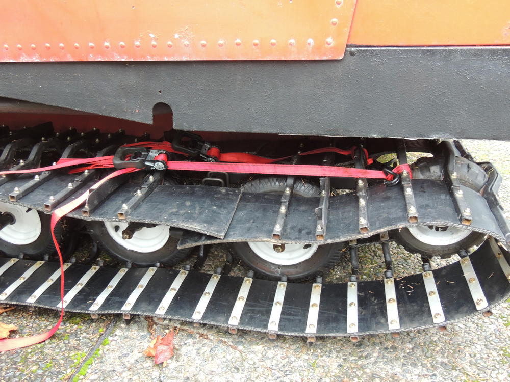

I’m in the final phase of a track rebuild on my 1404 Imp and could use a bit of advice.
I’m using a two-grouser overlap to join the belts and am struggling to get everything tensioned and lined up so that I can install the appropriate bolts. Ratchet straps do a great job of pulling everything together and the outer belt was a piece-of-cake. The inner belt, however, is a completely different animal – there’s just no room to get to where you need to be. I’ve tried moving the joint to the back of the cat, the middle, and the front and it is all the same story – I can’t get the hands, vision, or leverage I need to even begin to put things together. As with most things there’s probably a trick (or two) to make this easier, but I haven’t figured it out on my own. Anyone who’s been down this road before care to offer some advice?

I've got a couple sets of track jacks as well, but they really only work when you use a hinge-type connector. Since I'm using the two-grouser overlap approach to joining the belts the track jack has to span something like four grouser positions (i.e.,12" to 16") in order to reach the last solid grouser, and they're not nearly that long. I initially thought that was going to be a problem, but el cheapo ratchet straps do an excellent job of tensioning the tracks and they're actually easier to use.
The challenge I'm facing is access rather than tensioning -- how do you get to the bolts on the inner belt? I'm thinking that maybe I can roll the joint to the bottom side of the idler wheel at the front of the cat and then access the joint from below. Maybe put the center of the grousers up on a 2x4 to give a little more clearance. I've got some time to try that out on Sunday -- I'll let you know how well (or not) it works.

Joining the outer belt is relatively easy -- I ended up doing it in the middle on the top because it gave me some nice long straight runs for the ratchet straps.
The inner belt was more difficult, but I found that I could eek out the space I needed by moving the joint to the bottom of the track just behind the idler wheel. There's room to get to the bottom and top of the splice without a bunch of contortions. Had this not worked I'd have gone w/ Pat's suggestion of removing the last bogie in front of the drive sprocket -- that would have given quite a bit of room.
The belts are a little more loose than I would like, but that's a self-inflicted issue. The original belts had 54 grousers, but I bumped it up to 55 since other folks had that number (grouser envy...) and it makes the pattern of a paddle grouser every fifth one come out even. I moved the idler out to the forward position to take up some of the slack, but the belts are still a bit floppy. If this proves to be a problem then I'll bring the idler back a bit and go to a three-grouser overlap for the joint. For today, however, I'm going to sit back and enjoy the feeling of accomplishment.
