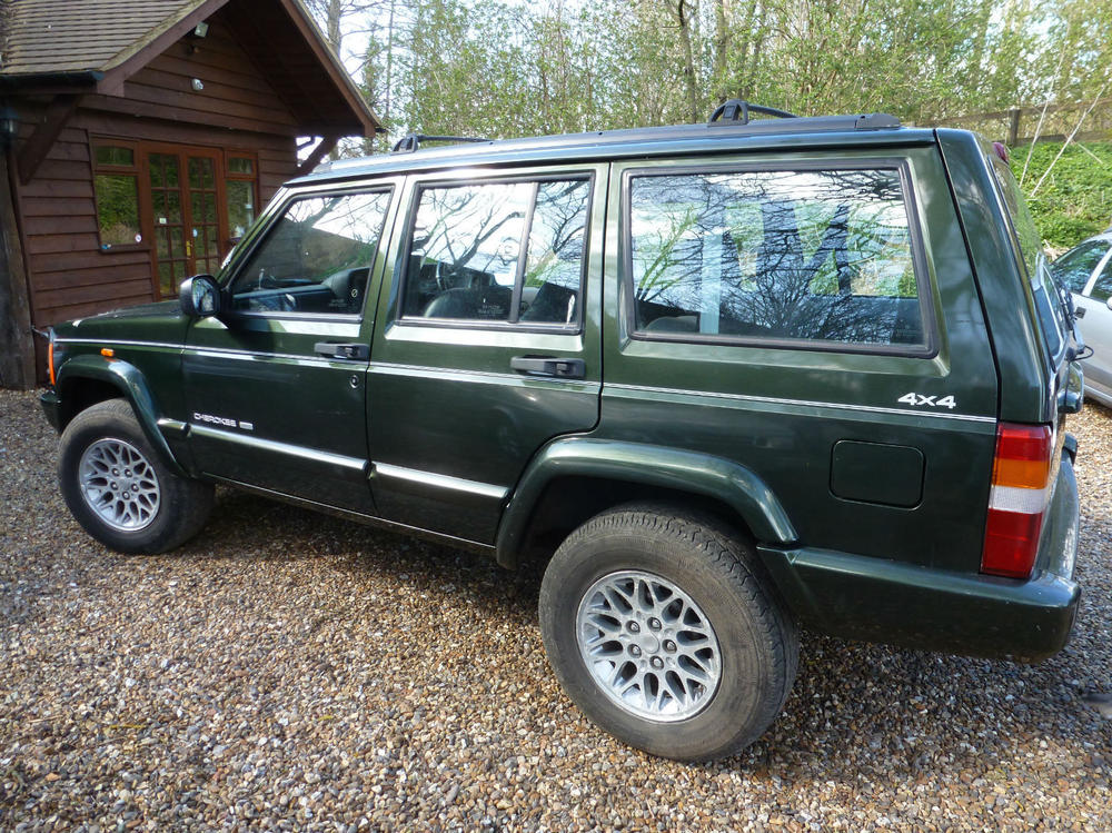

Just bought 2000 2.4 diesel and got it cheap but have noticed when on a long drive the clutch seems to slip ...i am guessing it is something getting hot and getting techy ....am i looking at a new clutch or could it even be piss poor oil in the gearbox???
110,000 on the clock manual trans.
Never owned one before its just a toy any advice would be great thanks.

Gearbox oil will not make the clutch slip. At 110k (miles or km?) on the clock a worn clutch is not out of the question. Take it apart, change the disc, pressure plate and surface the flywheel. Then you can see if there is a leaking main or trans seal, and easy fix at that point.
Thanks i was thinking a new full clutch kit and they are not over expensive....110k miles.

Galvy, in the engine bay pic I don't see a clutch master cyl, tho maybe it's there but out of sight in the pic. If it has manual clutch linkage maybe it needs adjusting so the clutch pedal has free play.

Well on further inspection i have found a oil leak on the transfer box and i have a plan thanks to my newly formed friendship with my brother....
Brothers friend has a re-con gearbox with transfer box sitting in his workshop ,they are coming down next weekend dropping out the old putting in the new with new clutch seals ect and bleeding the whole system for me.
Cost is only going to be the clutch kit and the other parts and labour is dinner beer and a few laughs....happy days.

That should fix everything, Galvy. take a good look at the flywheel face while you're in that far.
