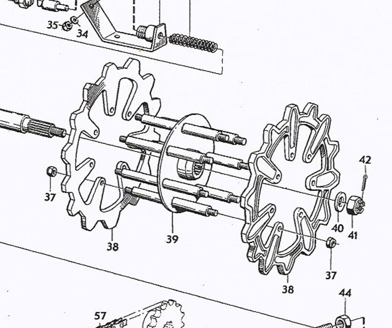

I posted in another thread that I may have found a source for newly cast bronze drive sprockets for Snow Tracs. The part number is ST52. It shows up in the diagram below as #38 on the drawing.
Depending on the year of your Snow Trac, there were a couple differnet drive sprockets so you should check your sprockets to see if this is the correct one for your unit. I believe this sprocket was used on all the later models Snow Tracs, starting sometime in the mid-to-late 60's and going through the end of their production in 1982.

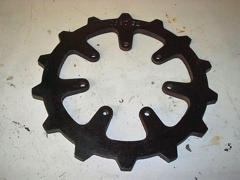

IF YOU NEED NEW SPROCKETS please post to this thread and I will send you the contact information for the guy I am working with in Canada. He used to be the importer for Snow Tracs. He has a Heavy Duty version of the sprockets that he used to have cast and he sold as a replacement part. He is currently working with a foundry to get pricing.

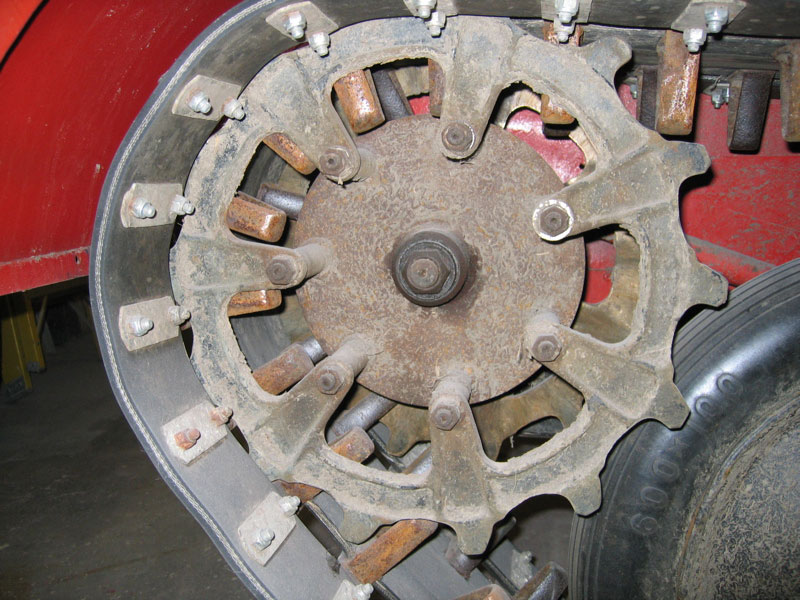

Picture #1 below: My worn out sprocket.
Picture #2 below: The H.D. Bronze Alloy sprocket.
Picture #3 below: Image from the parts manual showing the sprockets (#38, which is actually part #ST52).

Looks worn only on one side. Can it be turned to run on the other side of the sprocket tooth. Also looks like it could be cut out of flat plate by any machine shop with a tracer out of any material you want. That would be a lot cheaper than a casting.
They have already been reversed they are worn on one side, and worn BADLY on the other side.
As for going to a machine shop, I thought of that because one of my best friends owns a shop with several CNC machines, etc. However the problem is that these are made of bronze because they are designed to wear. If steel or a similar material is used, the tracks will be destroyed over time. Consequently it is easier and cheaper to replace the sprockets than to replace all the grousers on your tracks!
I would suppose that some sort of a hardened aluminum could be used for the sprockets, but it seems to me that any aluminum would wear much faster than bronze. I don't expect that this will be cheap, but a proper casting should last for a decade of normal use without causing undue wear to the track parts.

Base diameter is 15 3/8" (acoss the gear at the bottoms of the teeth)
Acoss the tip of the teeth, 17 1/4"
Tip center of tooth to the next tooth center 3 1/2"
Tooth thickness is 3/8"
Margin at top of the tooth is 3/4" and the space between teeth is 2"
14 teeth total, with 7 drive tabs on the inside for bolting to brake drum. (two band track) each of these has a lug on the back, so it isn't really that flat on either side.
