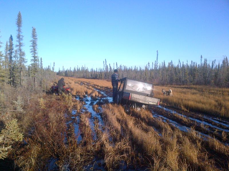

The name says it all. Was taking a load out to a river crossing and got swamped in a marsh.

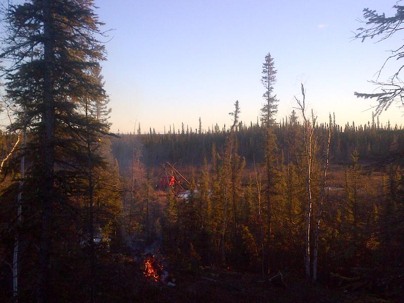

One more teepee at the front and another come a long and we'll try to pick it right up off the ground then load a bunch of wood under it, change the oil and let it freeze there before I drive it back.
That sure ain't no way to end the week. Good luck and hope it freezes up that you can drive it back out.
Bad way to end a week and a really bad way to start a weekend. I'll be out there tomorrow for the day, hope to get the oil changed and see if it'll start. It will freeze, we are well above seasonal norms now. It's usually near negative 10 now. It is really amazing what you can lift with a teepee, just remember to bring a latter if build one they aren't that easy to climb.
That looks allot like the nightmere I had with my J5 in it! It looks so brown and brushy nearby that I'm suprised that you found a place that deep. Was it a creek channel or just a muck hole? The saying "If its green go around, if its brown smash it down" has kept me out of trouble so far. It looks like brown all around you there, I'd felt pretty safe too. Is that a muskeg your driving?
that looks like south central Alaska like, maybe trapper creek area. out there they have these huge peat bogs where the permafrost has melted. and now the vegetation and soils are floating on top of big pools of water left from ice lenses melting. out at alexander lake we used to run a snow master across this floating mat and there would be a wave pushed up in front. one mist be careful as if you punch through the matt the water and mud below can seam bottomless and easily be in excess of 8 feet deep. its kind of funny when you fly low over the kinik goose bay area little sue and bug sue drainage there are many smoke stacks sticking out of these bogs and lakes where dozers fell through and were abandoned during the oil exploration days. this kind of stuff is where john deere 350 and 450 thrived with their wide pad configuration.

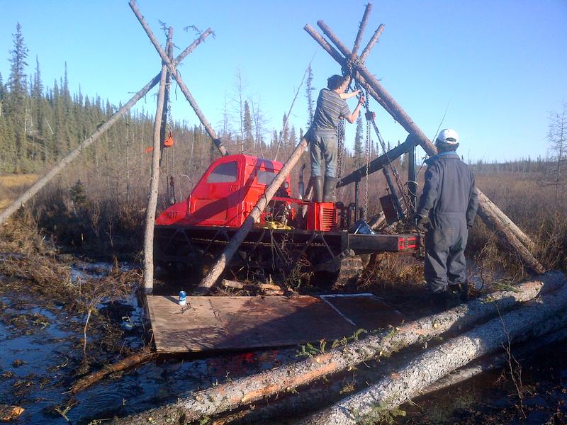

So in total 3 full days of work with 3 guys each day. The terrain is probably a lot like Fairbanks or a little north of there. It is sub-arctic boreal which means black spruce country. Permafrost keeps the water from draining into the soil so the water table is very high. It wasn't quite like the floating peat bogs, just lots of water under that willow and grass matting. I was in chest deep water to pull the oil drain plug had about 30L of water come out before the oil. Good thing too because last night temp dropped to freezing. We did change the oil but the distributor was moist and dirty so I might just pull it back to town once the road opens. Believe it or not but that is a winter road that we are on, it gets built every year.
So basically it was built one teepee to get it up, didn't work. Built another teepee lifted the front and the back from each teepee using a 1 1/2 ton come-a-long at the front and a 1 ton hoist and 3/4 ton come-a-long at the back. That's all we had, it would have been nice to have 2 2 ton come-a-longs. Once both it was suspended we lay a bunch of logs parallel to the tracks about a foot to 4 feet out from the machine to distribute the load and provide a big foot print, then put big logs under the machine perpendicular to the tracks to support the weight of the machine, then another set parallel and under the tracks themselves to give us some height out of the water.

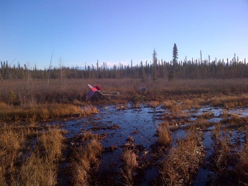

I didn't get a photo of the machine after it had settled into the hole, as you can see from the first set of photos and the one of the rad that I just posted. Look at the water line on the rad. To get the first lift at the back I was up to my waist in water and reaching under the water to get that chain under the hitch at the back.

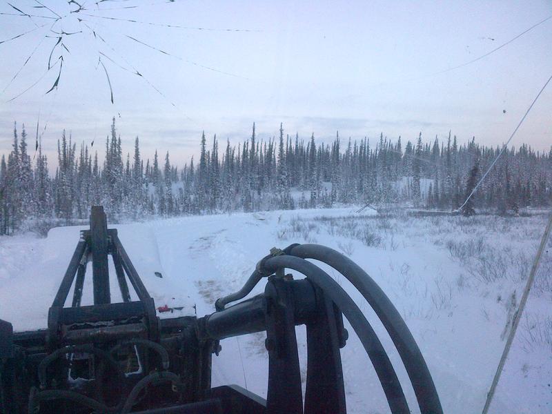

Aside from terribly cold weather and a really late winter road. I was finally able to drag the muskeg back to town. I'm just waiting for shop space to get her in and see whats what. The tracks didn't turn on the way back so I just ended up dragging it all the way back to town.

First picture was at 3pm just after the sun reached its max elevation. It was -30 degrees, the warmest its been in a few weeks. I had to cut one teepee down but left the other up. Poor Muskeg, hope she feels better after being left alone for so long.
