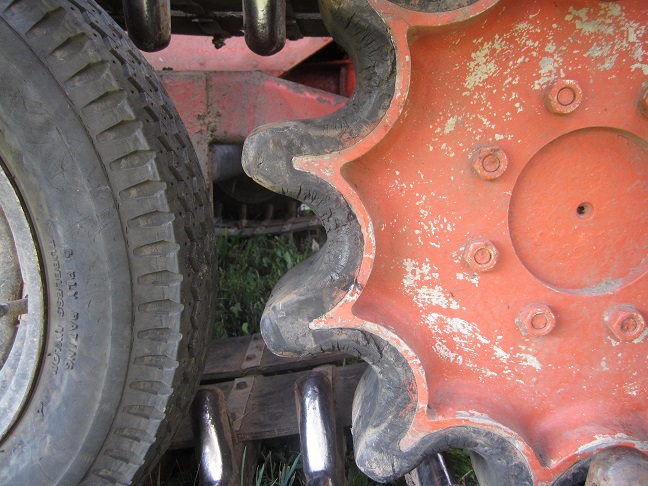

The sprocket on the right side has a loose tooth?!? I don't know if this is the right word for it, but the rubber top / point on one of them is sheared through quite a bit. Not completely, but I would say that it is certainly not nearly as strong as the others. What other things would I look for regarding wear? Where can I buy replacements / refurbished sprockets? How much do they cost?

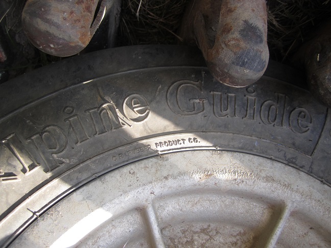

Well, I went to the vehicle today and have some more details - AND PICTURES because we all love pictures!
TIRE PRESSURES: As I was driving away, I thought, I wonder if the tire pressures are low?!? So I went back and checked them all. You guys will probably think I am an idiot for not checking this first, but they did not "look" low. Starting on the left front and moving to the rear: Alpine Guide tire - foam filled (pictures 5 & 6), tire #2 = 26 psi, #3 = 39 psi (my only tubeless tire), #4 = 21 psi, and #5 = 25 psi. On the right side, starting at the front and moving back: guide tire - foam filled, but the tire is a mess - see the 7th picture below, #2 = 20 psi, #3 = 20 psi, #4 = 19 psi, and #5 = 10 psi :(
This machine did come with a manual which I read through tonight. The tire pressures should be 36 psi. Does anybody disagree with that number?

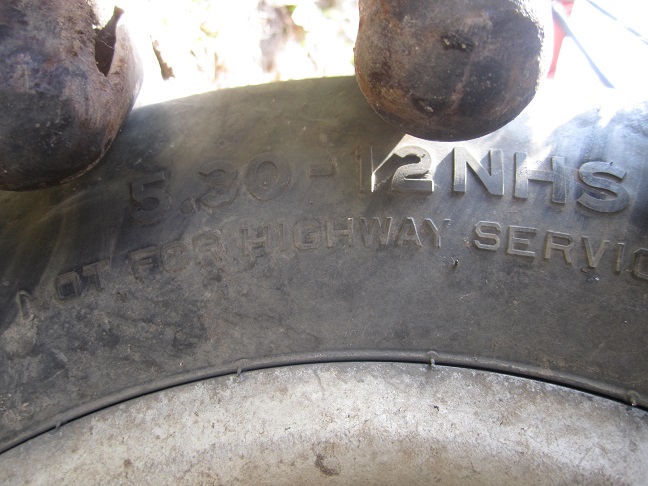

TIRE SIZES: What is the difference between 5.30x12, 4.80x12 and 4.30x12? I have at least 5.30x12 and 4.80x12 (pictures 1 & 2). The manual says the tire sizes are 4.50/5.30 x 12.

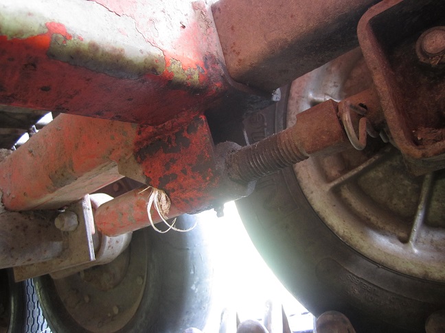

TENSIONING THE TRACK: The manual says this about the tension: "As a guide, the upper portion of the track should sag approximately 1/2 inch between adjacent wheels." My tracks (as seen in the pictures #3 & #4) don't seem to have any sag between the wheels which leads me to believe that the tracks are pretty tight.

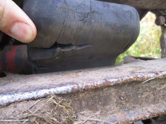

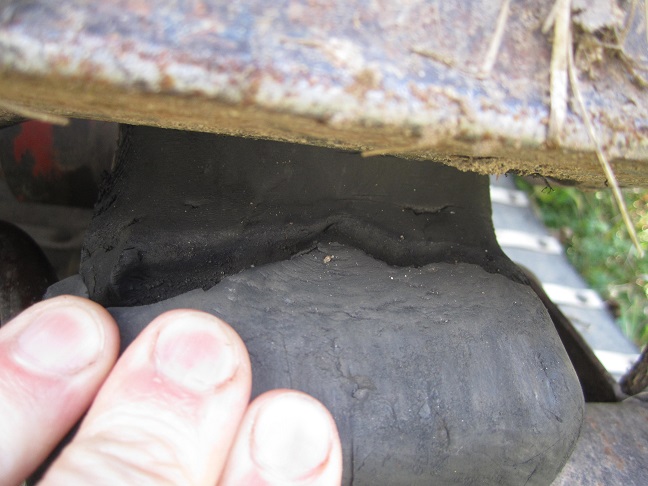

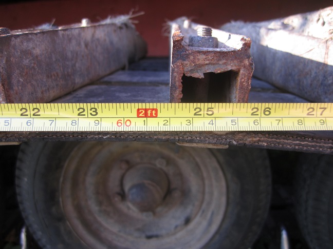

OVERSTRETCHED BELTS?: Pictures #10, #11, and #12 show the distance when measuring 1 space (one of the worst), then over 3 grousers, then over 6. I would say the average spacing is about 4 1/8".
CONCLUSION: Well, the "flat" tires certainly seem to be a likely culprit here, followed by the bad spot on that right sprocket (pics #16, #17, & #18).

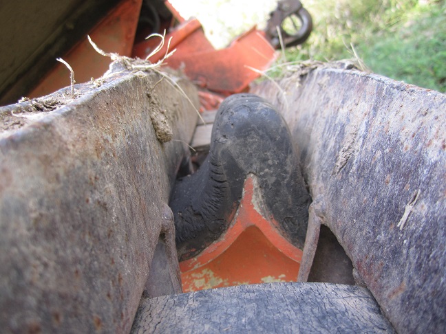

WHAT I NEED TO DO NOW: I think I need to buy another Alpine Guide tire. The left one was put on by the previous owner in 2006 and it looks great. Then I will have it installed locally and foam filled (for $65). Then, fill up all of the tires to the proper pressure and test the unit. It will probably take several weeks to get the new wheel installed. Does this sound like a good plan of attack? Anybody know a place that sells that tire for a reasonable price?
fogtender - If things seem to work well after the above ideas, I would consider getting all of the tires foam filled. $65/tire doesn't seem that horrible. What kind of tire (brand and such) and tube would you suggest I buy if I go that route? You will be able to see where the tensioner is and if I have any more threads left in that bolt. The reason that I think I am all the way out is that when I did it on the right side (picture #9 is the right side - #8 is of the left tensioner - maybe a few more threads left in that one), I kept turning it, but the thread would get any longer.
PICTURES: I have attached some overall pictures of the vehicle, close-ups of the tires, including the good "ALPINE GUIDE" tire and the bad guide tire, the left and right tensioners (THE RIGHT ONE IS ALL THE WAY OUT, RIGHT?), grouser spacing - over one that seems stretched, then over 3 and 6 to show that the overall spacing is not that bad (I don't think), the track fasteners, and the sprockets - in particular the sprocket with the bad tip.

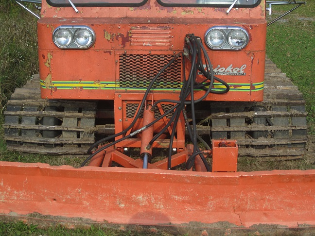

those are not the OE j style grousers the tracks have also been narrowed. the cat looks like a nice little package boggie at mn out doors can re cover your sprockets. I believe your issues may be in your road wheels being low, and also it looks like you have street tires not snow cat tires in some positions. the street tires may not have the required side wall to stand up to the thrust on turning that long track on a sticky surface, you may also want to taper the ends down a little to give a bit more slip on hard ground
