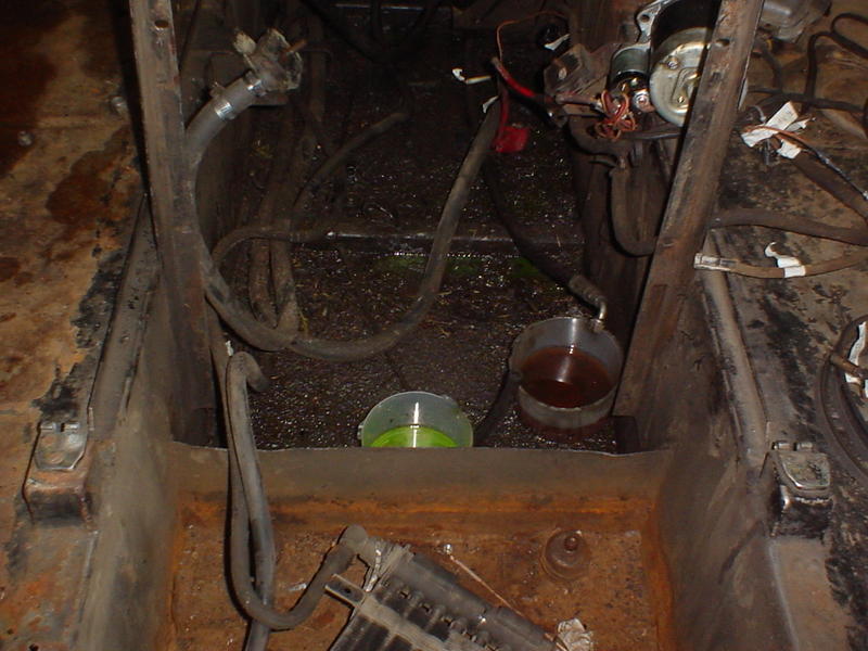

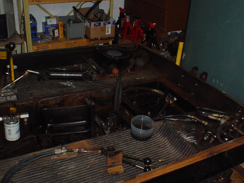

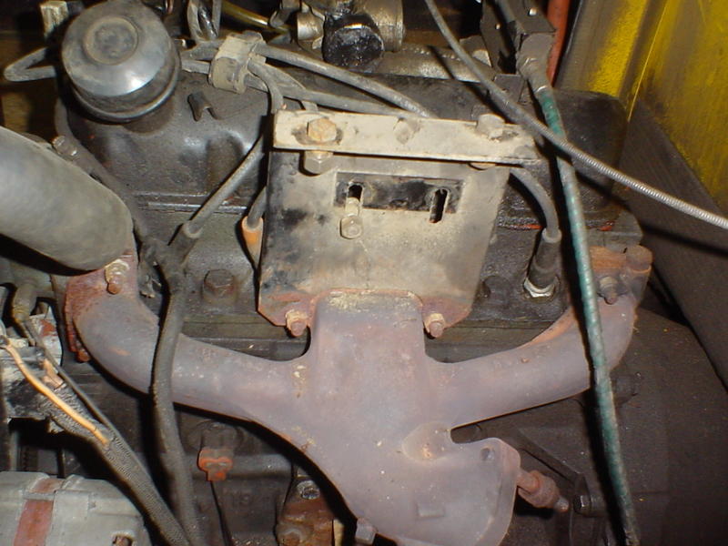

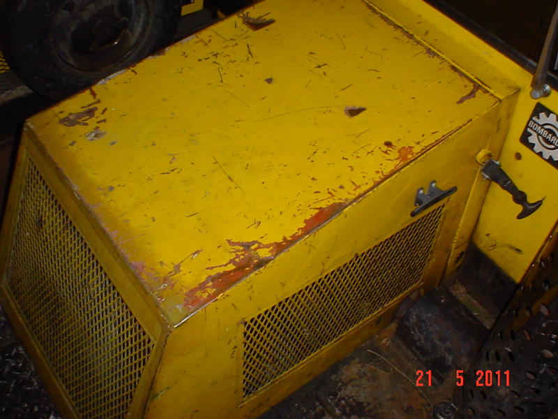

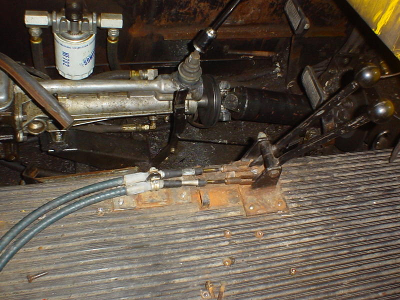

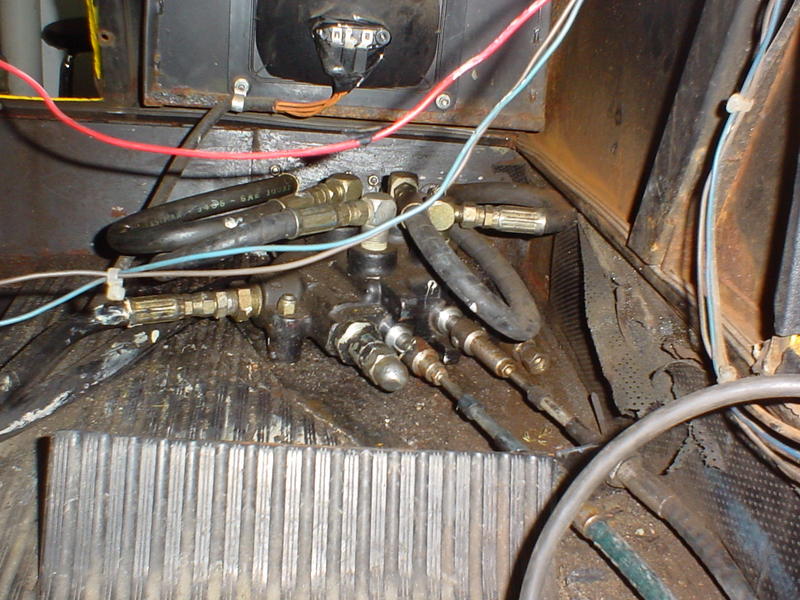

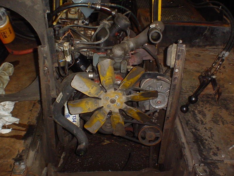

here are my first photos. My BR before with 1.6l 4cyl original Ford industrial engine with 4 speed manual tranny with cable clutch mechanism.

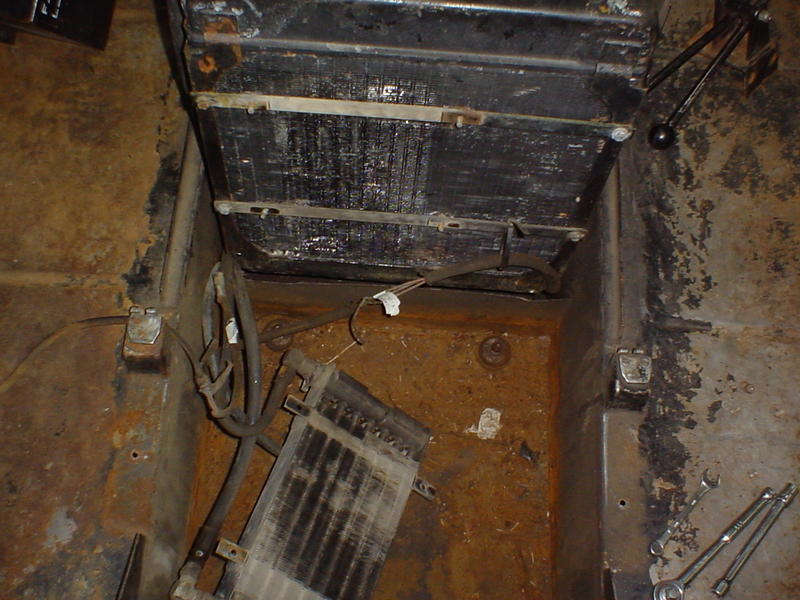

928mr2

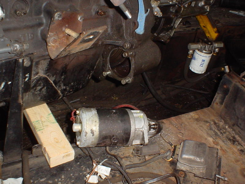

Next photos of disassembly and parting out

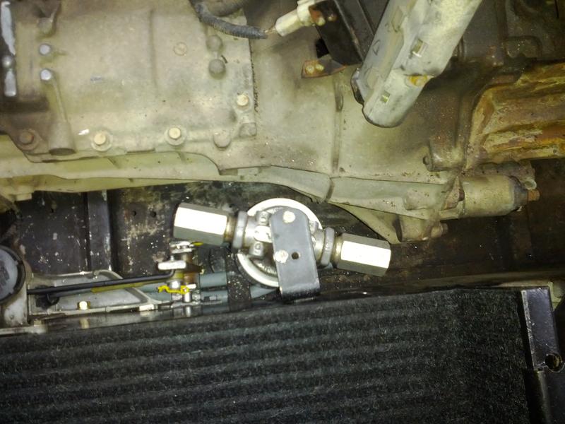

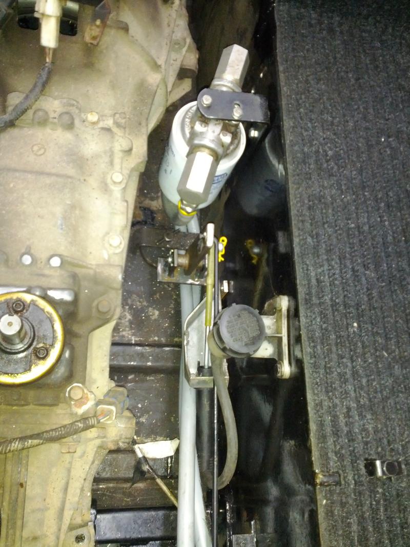

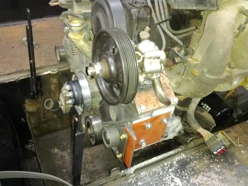

928mr2

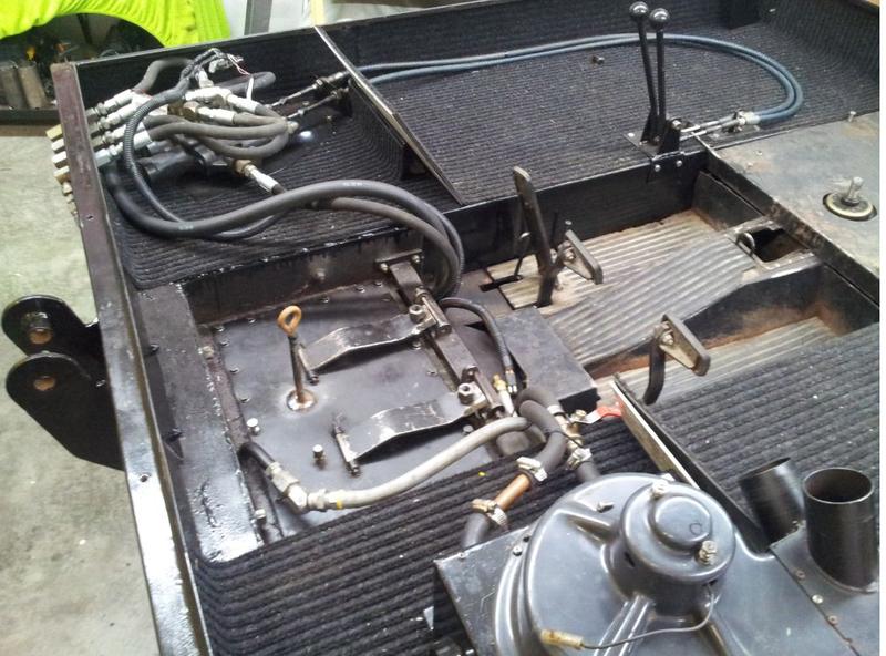

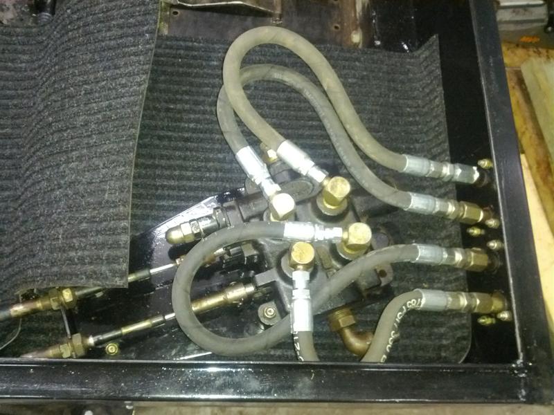

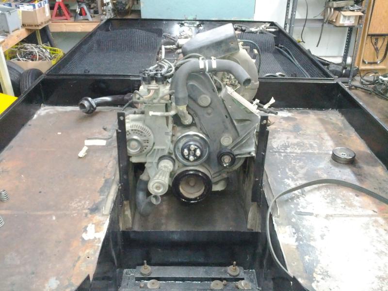

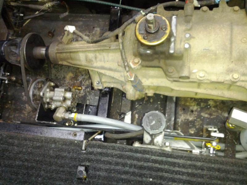

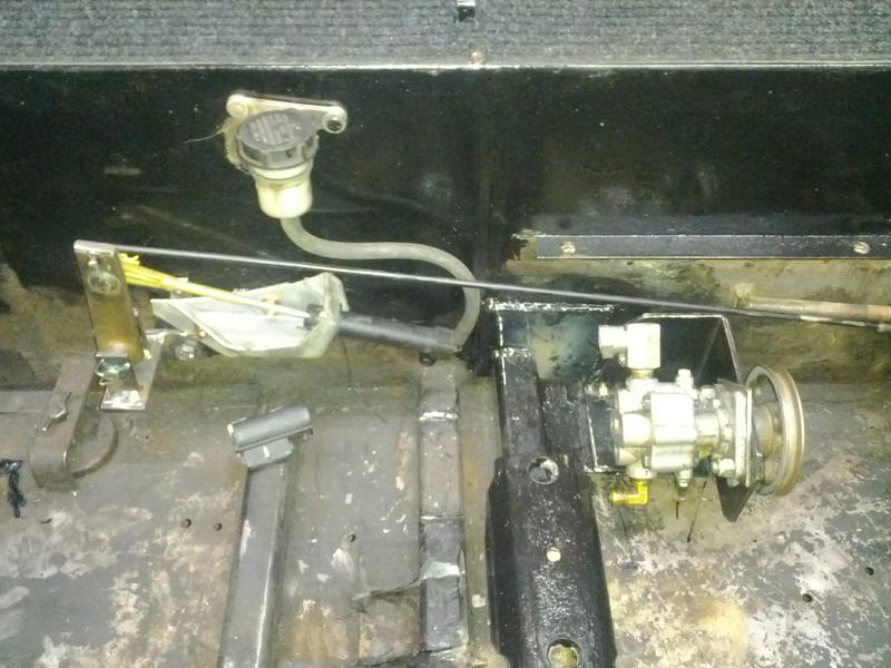

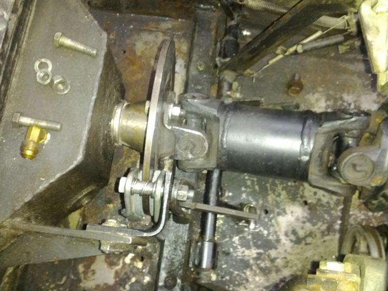

here are the photos of the mods. Engine swap from 1996 Ford Ranger 2.3l EFI with 5 speeds manual tranny yep manual, I prefered it for better reliability than automatic. It shifts very well and smooth from 1 to 5.
new hydraulic clutch drive mechanism also coming from the Ranger. shorten and balanced driving shaft, repositioned diff oil pump, repositioned tranny and engine mounts, repositioned radiators and oil filters.
changed the rad fan for a reversed one. Modified manifold.
Reinstalled the old hydraulic pump on new engine with flat belt pulley and new longer belt. Repainted chassis after welding and sandblasting. New carpetting and hydraulic hoses.

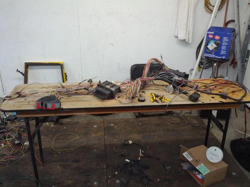

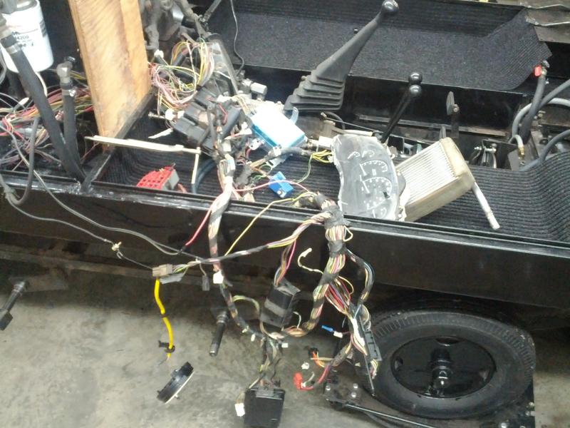

928mr2

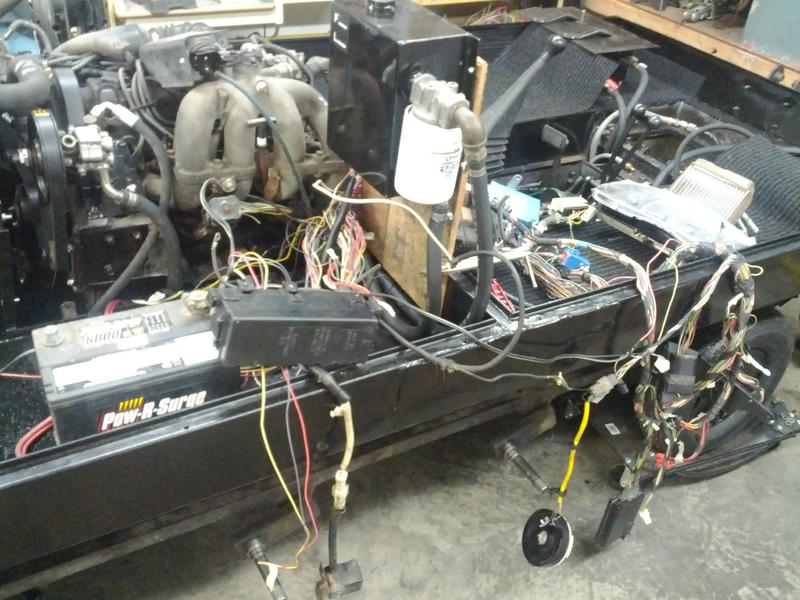

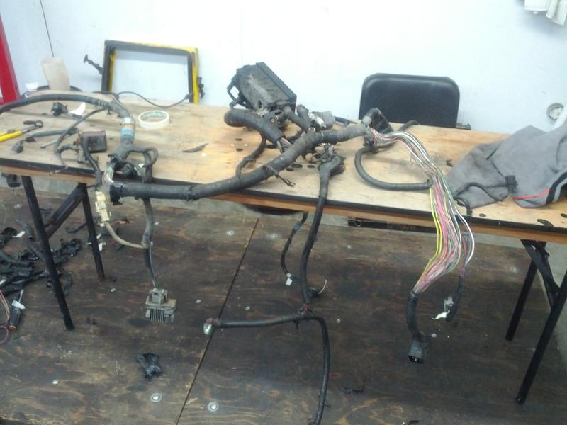

and then the harness of the Raner that I've epured and adapted to the BR. That step took around 40 hours of work and tests.

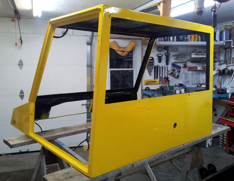

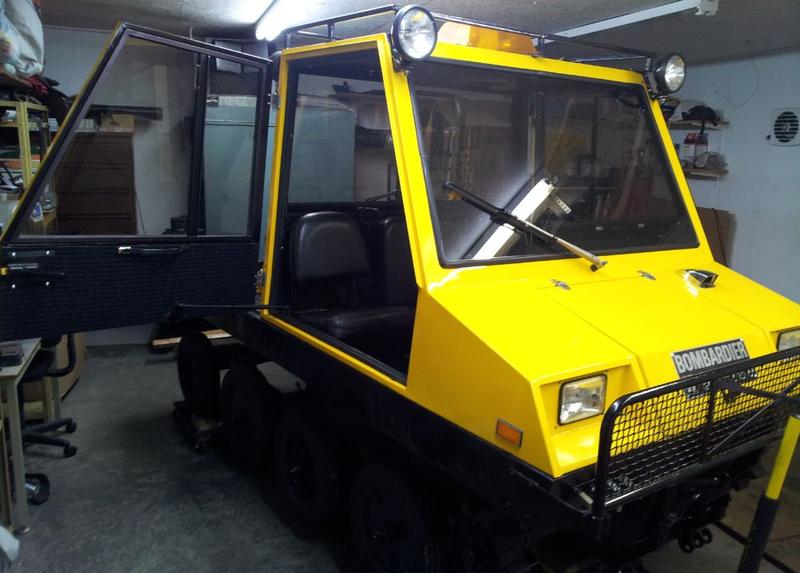

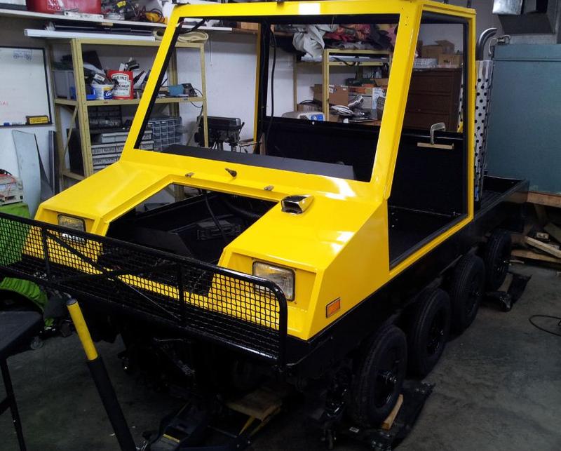

photos before putting back the freshly repainted cab.

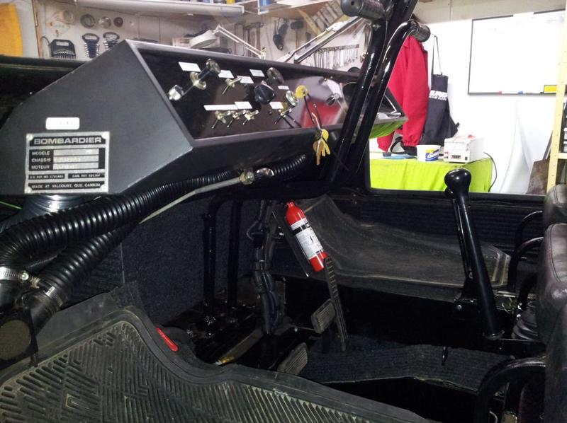

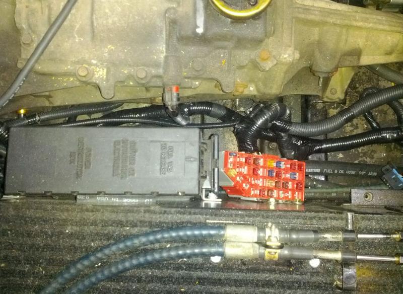

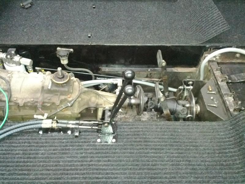

photos of modified shifter, new fuse boxes and adapted Ranger gas pump and gauge in BR gaz tank.

928mr2

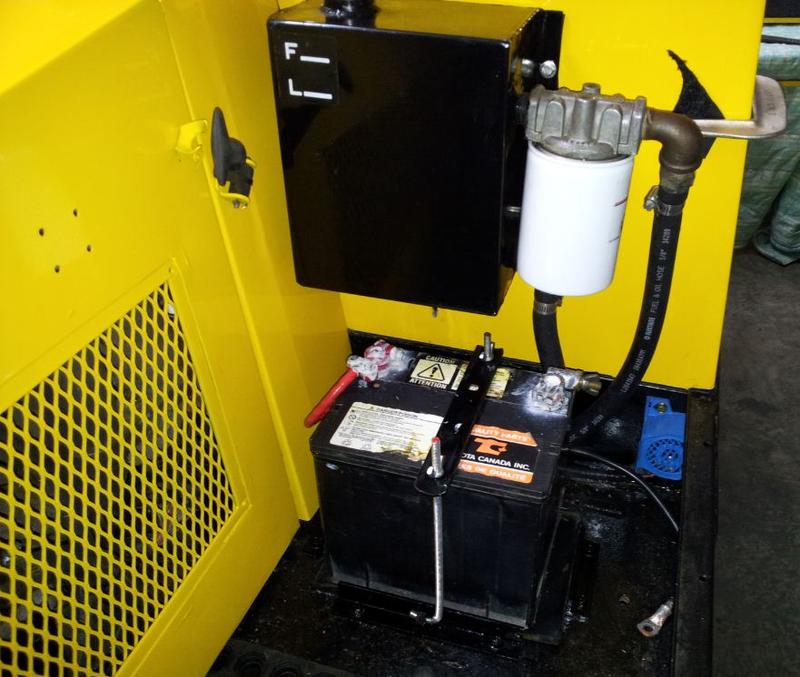

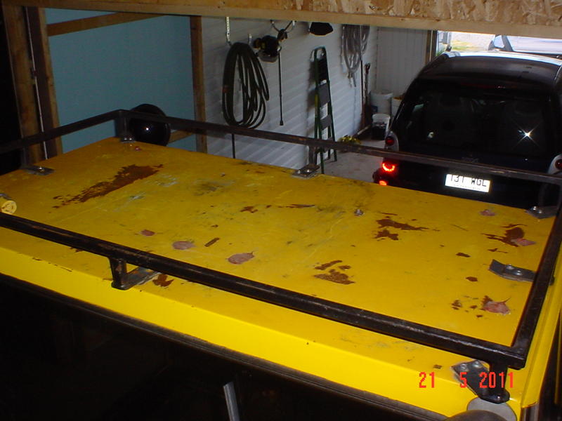

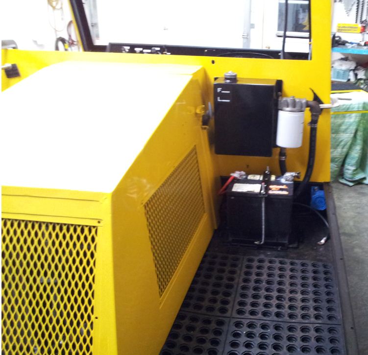

photos of new position of the battery, hydraulic oil tank and back-up signal.
Also muffler now on left side like a BR100+
rack on top and front protector.
Note that the engine compartment has been modified (longer)

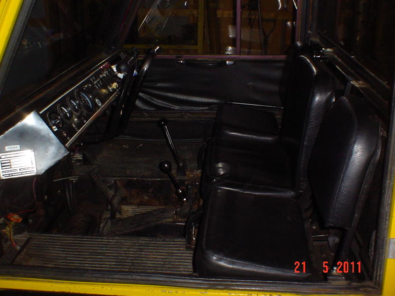

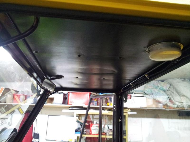

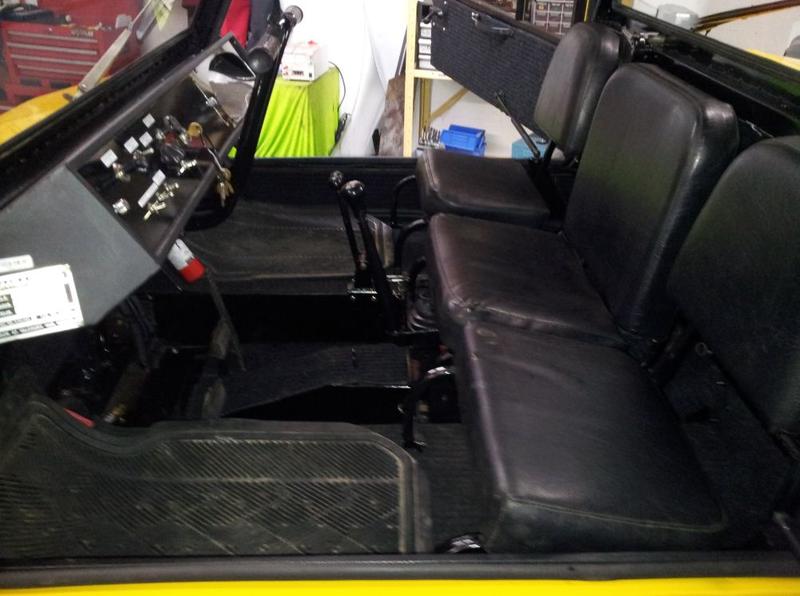

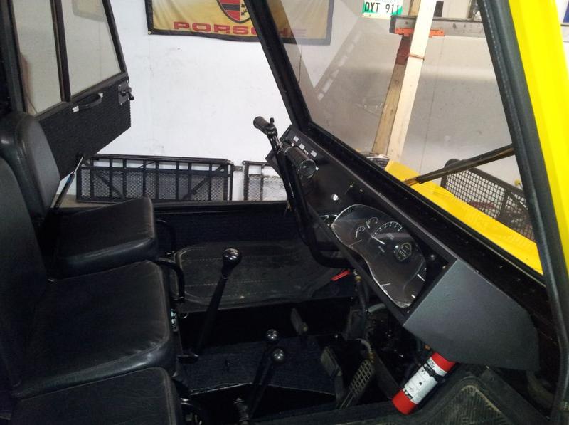

And now photos of interior. New upholstery and dash.
Doors, glasses and spots are back.

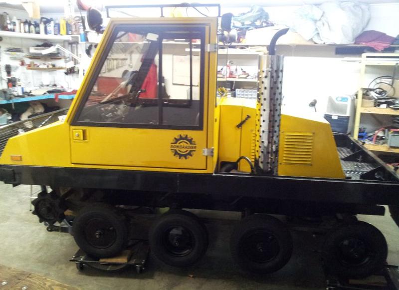

Snowtrac Nome
member formerly known as dds
now it's a br100 plus with the 2300 motor. i would love to test rrive it with that engine trans combo
928mr2
here is a photo of something I made to know easier the level of diff oil.
This photo was taken before paint and new upholstery,
I welded a dipstick on the diff cover and made marks
928mr2

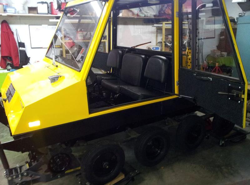

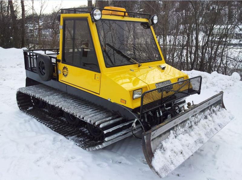

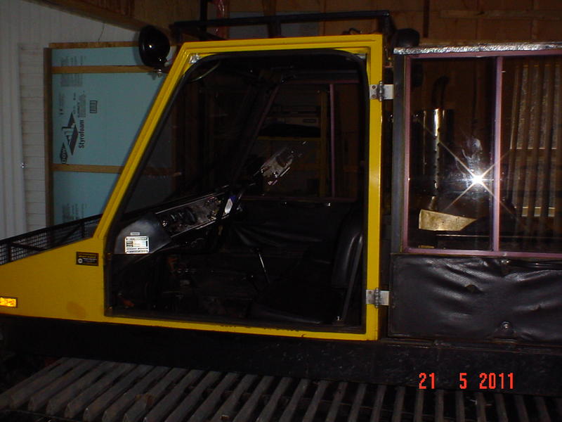

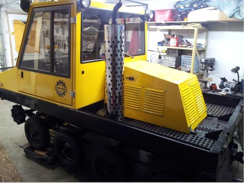

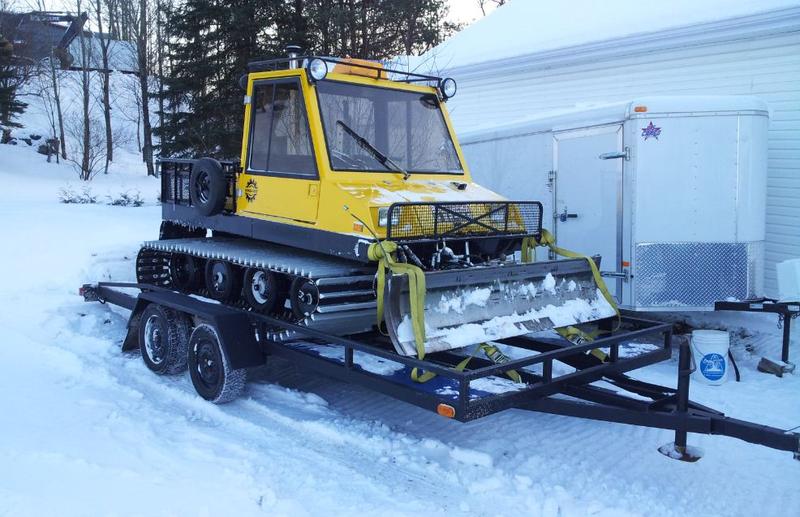

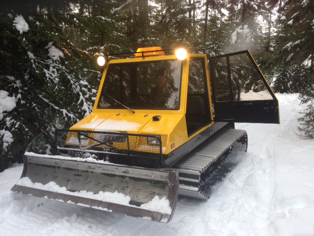

And now photos of the final product including on the trailer after road tests.
No major problem just a few dings easy to fix
928mr2
Exactly BR100+ but with manual tranny. It's very strong almost twice hp's and torque. Altough it stays a work machine, slow but strong and a bit noisy when pushed.:smile:

That wiring harness looks like a nightmare to deal with.
Congrats on a job well done :thumb:
928mr2
Thank's for your comments. For me it's not work but pleasure:wink:
I would like to mention that I had help from one of my brothers who's a top welder. Without him I could'nt realize my crazy projects :clap:
For the harness it was the easiest for me since i'm an electronic technician. I had to depend on no one for that step. It took a long time but went well.
