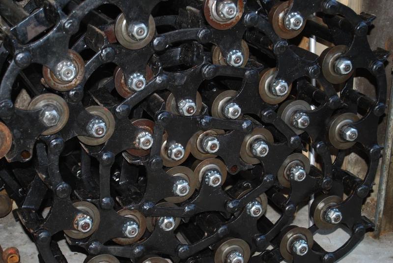

Until it got completely restored I would have probably paid more in premiums than what they would have covered it for.
For the time being.
Almost all of the money I had into the Tucker can be recooped in the pontoons & tracks anyway. Time, well that's a different story.:toilet:
So I'm sandblasting all four this summer, making any repairs that are needed to dimples, dents and cracks, then sealing them with some sort of water resistant primer. My plan was / is for Tucker orange, but I don't wan't to paint them that color and end up selling them off to someone that may need to change colors for theirs.
The tracks are taking around 40 man hours per set, so I'll continue to work on them as I can (read get re-motivated). Between the rollers I have and the ones I bought from Muley180, I hopefully will have 4 complete working sets that all roll. Some of the end caps on the rollers are open, but for my planned low use / low mileage riding it wouldn't have been a problem. If I sell them off, someone would probably have to swap those rollers for fully sealed units for heavier use.
