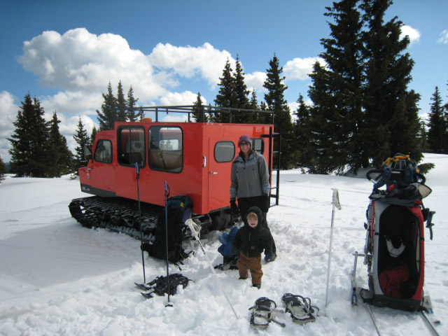

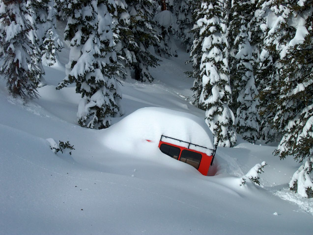

Hi all, I am new to this forum. I have owned a 1981 DMC 1450 widetrack for 7 years and despite feeling more comfortable with my driving skills continue to have difficulty in the deep, light snow we have in the mid winter in Northern Colorado. I spoke with a vendor who proposed adding another belt and longer, outer grousers to my tracks, to make an asymmetric track. Any thoughts?

Thanks for your thoughts here. My difficutly is with uphill climbs in soft snow. I find driving backwards I can usually clear the climbs more easily (trick from Snotrans--Thanks Bill Guthrie!) The tracks are the stock widetrack-so 31 1/2 inches. A place in Utah will add a 5 inch belt and the grousers but it is an $8000 job. Seems like a lot, but I have never done track work before so perhaps they are just expensive. I did find a similar thread about 4-5 years ago, someone called "snowcat operations" who was looking at the same issue. I will try to track him down. Here are some pics, and yeah, we get a lot of snow here......

wider tracks will just make it worse as it is underpowered now the reason it goes better in reverse is reverse is a lower gear than 1st only cure is to put in a under drive (transfer case with low range)to gear it down
looing at where you are stuck you are asking a little too much of it be advised that steering is going to take a lot longer in those conditions as you will dig in the the inside track and spin the outside about the only thing that belongs there is a snow master or some other super wide track rig that for skislope grooming that can inch it's way through the hill climb
