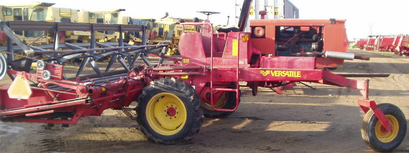

I bought a Versatile 400 swather at auction for 200 dollars. I planned on using the hydro components to convert a Thiokol over. I figured if it would move the swather in the field at close to 10 mph, I would have no trouble with a 1200 series Thiokol geared to about 15 mph. In my opinion, thats fast enough. I think that I have pretty much everything I would need, except for the time! Has anyone else looked at using a swather for the components?

I need to go to more farm auctions if those old haybines are hydro, I thought they were variator driven.......
