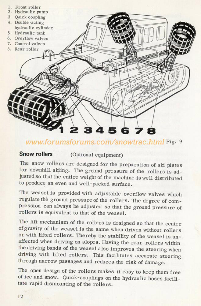

Below are 2 pages of the newest Snow Master Manual that show the hydraulics hoses, connections, routing, etc.
I will add more to this thread as I sort through the pages of the manuals. The first image is the diagram, the second is the parts information. I'd like to end up with a thread that shows all the various components of the Trac Master & Snow Master hydraulics. Eventually it will be composed of pages from various manuals.

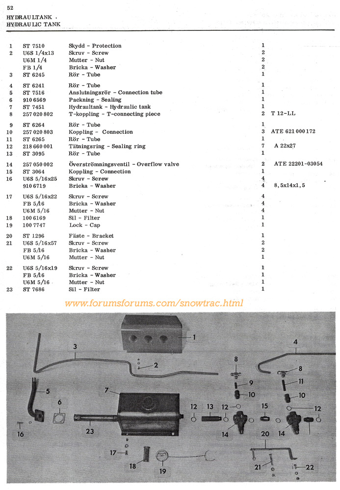

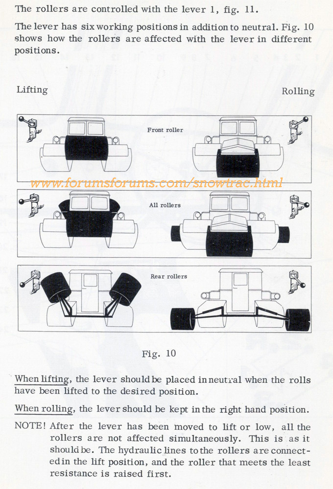

Here are a couple more. These relate to the grooming rollers, but as with any hydraulic set up, you can attach any hydraulically controlled device to a basic hydraulic pump and operate it.

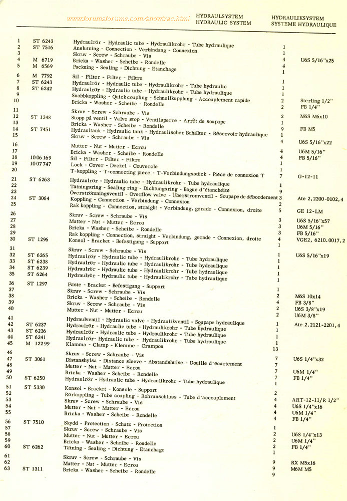

More hydraulics, these came from another manual. So far 3 manuals have been used in this thread, all 3 obviously are different. None of them seems to have the same information!
