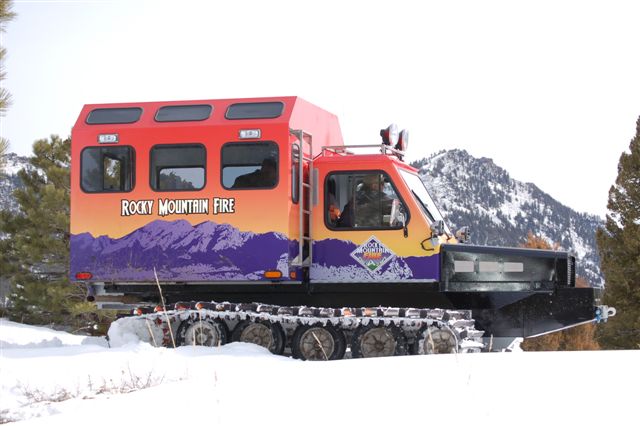

The original condition of the Thiokol, purchased by a local FD, from a seller in Carbondale, CO; And now after a serious restoration completed yesterday (finally!). Overhauled the engine, built the rescue body, refurbished cab, new hood/winch mount...

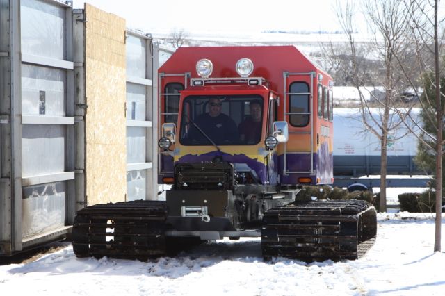

Still trying to dig up other in-process pics...The rescue body is all aluminum, insulated, lined with reefer wall. Rear door wide enough for rescue litter.

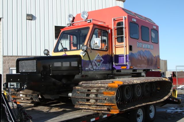

A few more pics...We did the restoration here in Lafayette, CO (Ionex / Iomergency). Typically we build wildland fire vehicles, but this build was for a department that has provided A LOT of technical assistance to help build the business and participated in this particular build through completion. Hopefully another department in the area needs one since this was a kick!

Very nice job and it will likely be a welcome sight to anyone needing rescuing.
I notice the oversize load sign. Is that a state-to-state variable as to regulations and cost? My snowcat barely fits within what I think is an 8 foot wide limit and doesn't have very wide tracks.
It does vary from state to state and from road to road... we put one on to cover our bases. If not being used in an emergency then a permit from the states DOT is required as well.
You should post your contact information...website, phone, etc... in this thread and also list it in your profile... with work displayed like this I'm sure you'll get some interest.

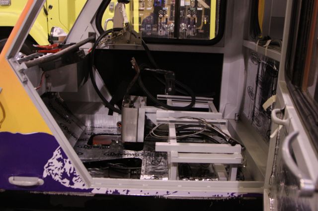

the entire cabin is insulated and we added a separate rear heater as well, runs off the hot water. The floor panels are hinged to allow access into the guts of the brakes/tranny. Will post a pic of the rear interior...bench seating around 3 sides with dry storage underneath...as soon as I find it.
