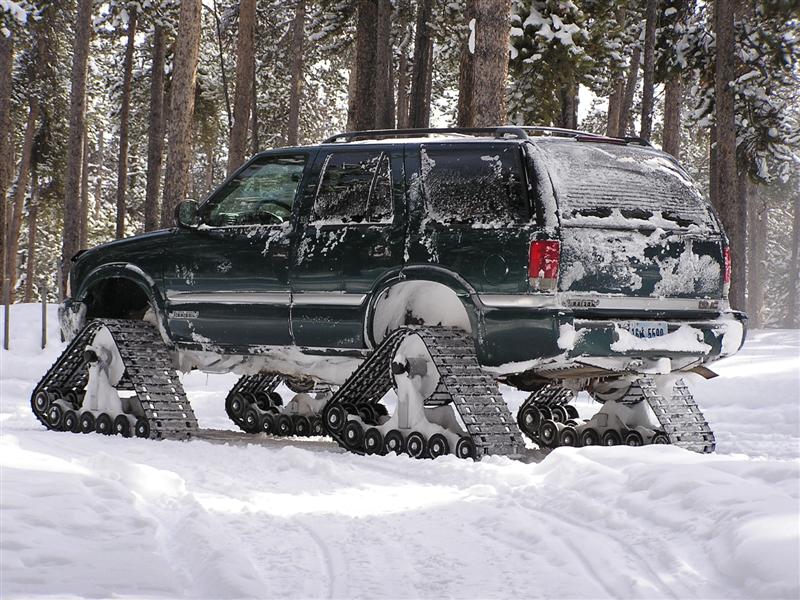

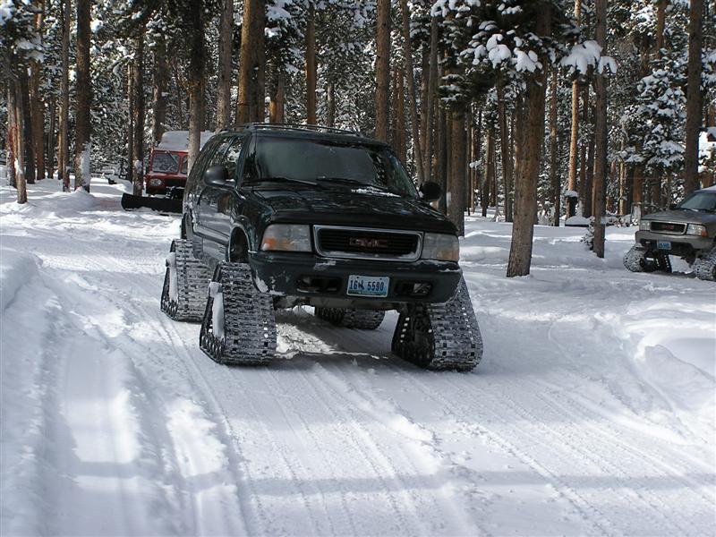

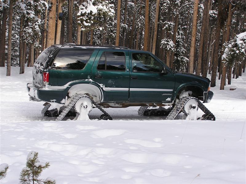

"Mbsieg" finished some mechanical work on the 1998 four door tracked Jimmy and brought it up the mountain to our home on Saturday. It is set up with tracks like the 2001 2 door but Mike (Hi Plains Repair) added steps to make it easier to get in and out of which my wife appreciated as the vehicle sets up high. We now have two completed tracked 4X4s and they do very well in the snow. I lost Mike for an hour or so as he and a friend cruised around the mountain. He finally arrived at our home via the back snow cat trail so I think he may have some comments on the ability of the Jimmy's with tracks.

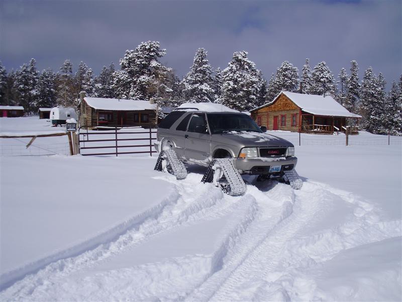

On Sunday the wife and I drove the 2 door Jimmy down the closed county road to the old town of Hazelton WY. The sun was out and we were the only ones on the road as it is pretty well snow packed and not usable by wheeled vehicles.

All I can say is :a1:. That little Jimmy surprised me. QUITE!!!! comfy, warm, QUITE!!! Almost a snowcat but all the creature comforts. 2.5-3ft of powder/ Bighorn sugar with little to no base. Jimmy sunk in 10-12in. Having a quite SMOOTH ride. Lots of power. Something to be said for blasting across a snow filled meadow at 20+ mph just floating. And grinning from ear to ear!!! With the longer tracked version this would put some snowcats to shame!!!!
I'd still be very concerned on the strength of the axles and suspension on these little trucks. They are very weak and prone to breakage with only slightly larger than stock tires.
There has to be even more stress put on them by a track system.
The tracked Jimmy's and Blazer are even being used to groom snowmobile trails pulling fairly large grooming drags from Maine to New York. The price of maintenance and fuel cost has prompted many clubs to use these vehicles in place of the larger snow cat type equipment of the past. The clubs using them are very happy with the results and efficiencies.

This belonged to a friend, but has since been sold. He builds them him self, and does some great work.
