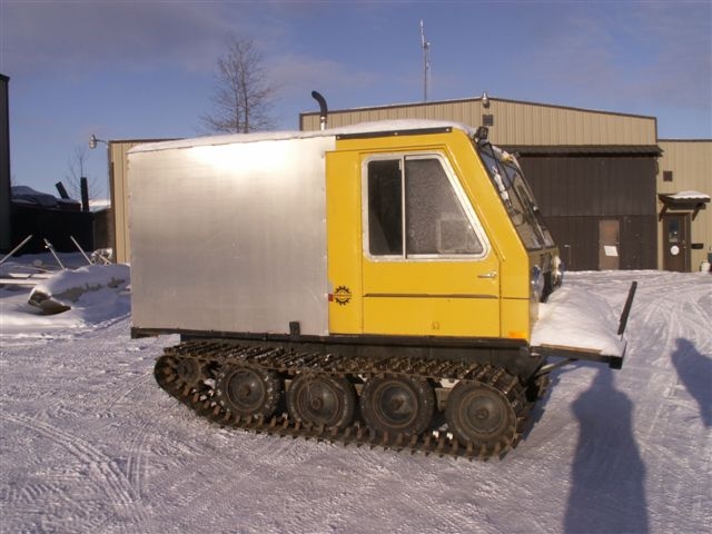

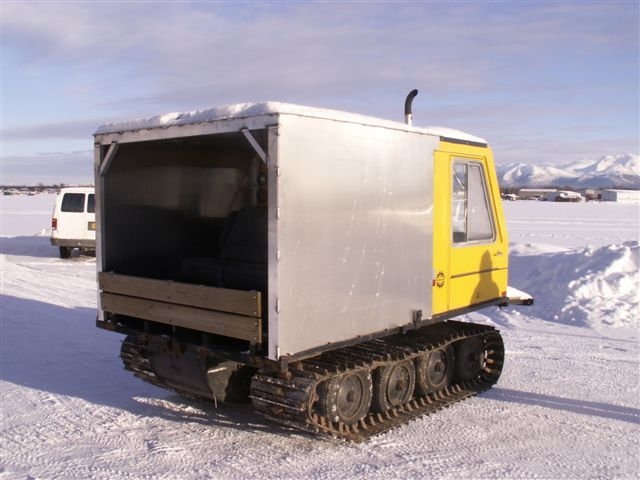

Here are pictures of a 250 with the narrow tracks. A little smaller than a 252 but basically the same. The key to any tracked vehicle operation when going over obstacles is to go slow and try and approach it head on. Driving over at an angle puts stress on the tracks and is a good way to walk out of a track. The big disadvantage to winter stacks used in the summer is they have a higher profile plus being wider making it more difficult for the machine to turn. The tracks need to slip on the ground so if it is primarily swamps you are crossing they slip pretty easy. You can usually cut the winter tracks to a narrower width. Do you have pictures of the ones you are looking at?

Here's a pic of one of the units.

Those are the summer tracks and will work just fine. It's hard to tell for sure from the pics but it looks like the rig will handle the wider aluminum or steel symmetrical winter tracks that extend both inboard and out board of the bogies. The blade is also very handy for GENTLY moving downed trees out of your way. Honestly from what little you have described of your needs for a track rig, this looks like a good choice. Price and availability seem to be on your side?
