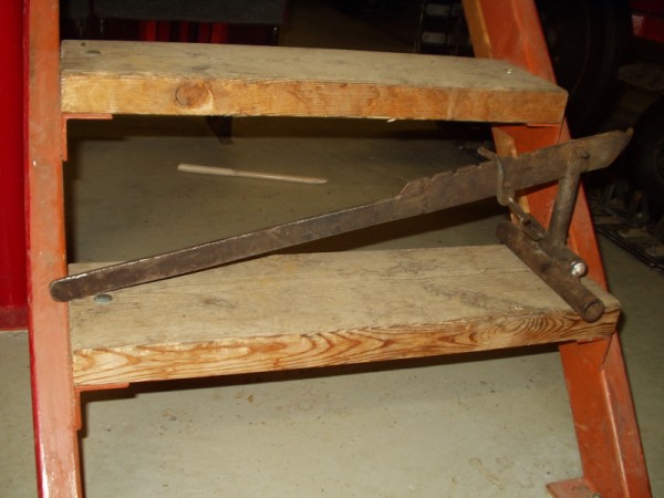

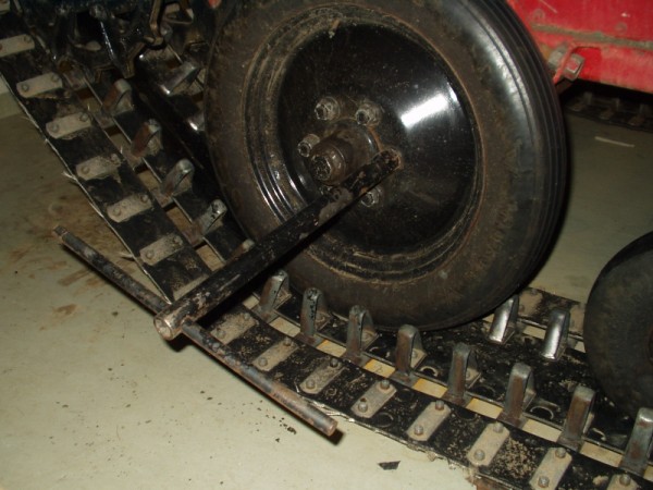

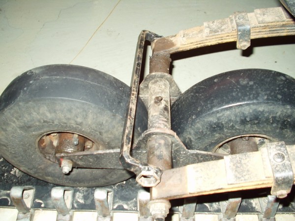

this is very useful tool in Snow Trac

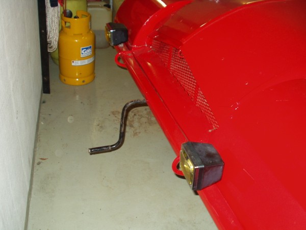

orginal tools in Snow Trac
Re: Snow-Trac from Iceland
Villi, did you make that tool? Is it used for changing the bogey wheels? Or is it something to do with adjusting the tracks?
In your LAST photo you show the ORIGINAL tools. One looks like a crank to start the engine. What are the other pieces?
I also have those tools and another one (No boggie tool though). I do not know what they all are for. The one with the spark plug by it is of course a spark plug wrench from Activ. The rest I dont know yet.

Hi Bob

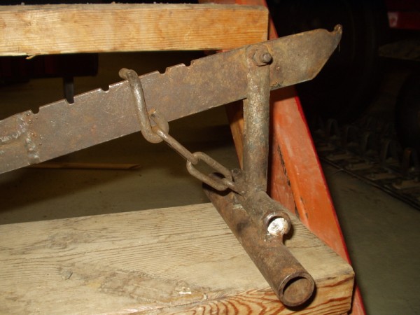

old Snow Trac operator did make this tool for changing the bogey wheels.

villi what a smart design , i like how it locks into the track to keep it from twisting or slipping out.... thanks for sharing your idea / plans...

hmmm!! the 1. pics is not right use of that tool , this tool I think ,is for adjusting the variator belt

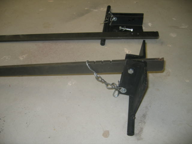

Well I just came in from the shop where I finished up making 2 "Villi Tools" for changing bogey wheels. One is for me, the other is for Mike/Snowcat Ops as he and I are doing some horse-trading on various parts so this is part of the deal.
My tool is a bit different than Villi's tool because I didn't have any pipe, so I used solid rod, angle iron and a nice piece of cold rolled steel for the lever arm. It works the same, looks similar.
I'll post photos later . . . after I stop bleeding :pat:

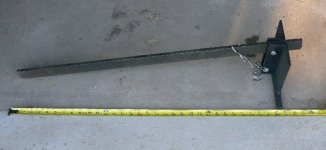

Here is my version of the Villi Bogie Wheel Tool.

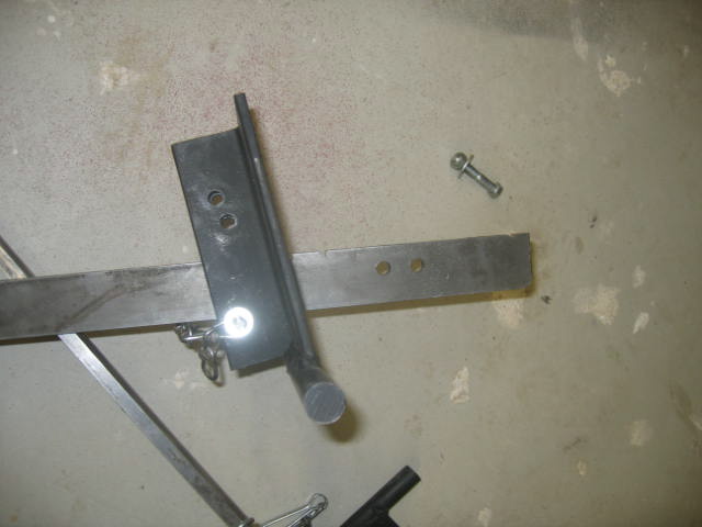

Villi used pipe, but I didn't have pipe laying around so I used what I had. The bottom is a solid steel rod, 3/4" diameter by about 10" long. To prevent the tool from slipping in between the grousers when lifting, I used 2 pieces of 2" x 3" angle iron that I welded to the rod. The also form the support for the lifting arm. I was VERY SURPRISED at how easy it was to lift bogey wheel using the tool. I'm not sure how long the lift arms are, but they offer more than enough leverage to do the job :thumb:
Picture #1 - My tool shown in action. :applause:
Picture #2 - The 2 tools I made (one is for Mike/Snowtrac Operations)
Picture #3 - This is Mike's tool disassembled. As he has a Snow Master, I made the tool adjustable by drilling 2 holes in the lift arm just in case he needed a slighly different amount of reach, I also drilled 2 holes into the angle iron to offer 2 different lift heights just in case the Snow Master is slightly different than a Snow Trac. (if you have sharp eyes you can see that Mike's tool needs a stout hook on the end of the chain, I only had 1 and put it on mine, so he'll have to add that when he gets his tool)
On both tools I cut the notches with a vertical front side and an angled back side to prevent the hook from slipping out of place. I also rounded off the corner of the lever arm where it might come in contact with the rubber tire. Instead of welding the chain in place as Villi did, I chose to drill a hole in and attach the chain with a stainless steel screw/washer, it is just another way to allow for adjustments if Mike needs it on the Snow Master, but I just set mine so it would work and it should not need to be adjusted again.
THANK YOU VILLI, the measurements you provided really helped :a1:

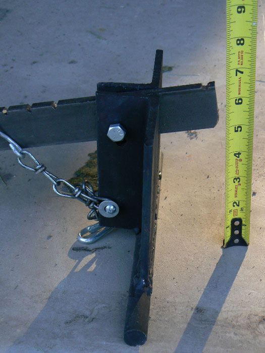

Mith needed measurements for the Villi Tool but couldn't find this thread. I shot new photos of my tool and posted them for Mith in another thread but figured it would be good to update this thread with the photos because these new photos have measurements with them.

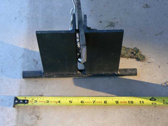

And the final 3 photos of my Villi Tool
Bob, thanks, this is the thread I was looking for. The pictures you show should make it realatively easy to build.
Remeber last night I said I would be doing it today? Well its 5pm now, and I havent done anything I planned. ;)
Ice, If I hadnt have done the cutting yesterday that messed up my hand then I would have made the tool.
It was too hot yesterday to do welding anyway, but today, just right :D
I've started it!
Only tacked together becuse I want to check that I havent made any mistakes before I weld. So, reckon it'll work?
Bob, I put 5 holes in the main beam, reckon that'll be enough adjustment? They are aranged in the pattern like the 5 dots are on a dice.
Looks good. Finish up the welds and it should only need the locking chain and some notches.
One thing that I can't really see in the photo, but the lower edge of the very end where the lifting is done needs to be rounded off or cut back a bit. Villi cut his back at an angle, I used a grinder and simply rounded the lower corner back a bit and made sure there were no sharp edges on the end. Either way will work, Villi's way is probably a bit better. But you don't want a sharp lower edge poking into rubber tire of the bogie wheel.
Bob, I was going to cut a 45 degree angle on the bottom with the bandsaw, forgot to do that before I took the picture
I don't recognise the double box end 90 degree wrench. The axel where it is being displayed is usually 15/16, the only other nuts this size that come to mind are the ones that hold the Variator/Transaxel in. I believe that the adjusting nuts for tensioning the variator are 1", not 15/16 and the 'throw' doesn't look long enough to use on the lower adjusting spring assembly. You might try quizzing Christer Morlind as to it's application. If he doesn't know ask Harry Dewent of BC Tell or Roary Corniel (retired, lives in Vancover BC) of NW Tell. There were a bunch of mechanics that worked for NW Tell, out of Whitehorse in the Yukon Territory that all worked for Roary Corneil that probably knew Snow Trac's better than the factory. That service center has since been closed down, but the guy's were not that old and Whitehorse is a small community that one might be able to track down one of the mechanics. The parking lot for NW Tell's service center, right off the Alaska Highway(ALCAN) was very likely the only place in the entire world where 200 Snow Trac's were parked together at one time. As this accounts for roughly a tenth of the total production of the machines and no other user in history purchased this many machines it's probably a "One and only time in history" event. Roary say's there were pictures." Whitehorse, Snow Trac Capital Of The World"
Lyndon, Villi thinks the odd tool with the double box end wrenches was made by a prior owner of a Snow Trac in Iceland. Villi also lives on a farm near the northern coast of Iceland and received the tool from the prior owner of the Snow Trac. Somewhere he wrote that he was not sure what the heck it was for!
Bob I too have one (see my picture #5 post middle tool). It was in the spare parts / tool holder under the seat. It looks factory to me since it is the same original paint job as the other factory tools. I am wondering if it does go to the variator?
OK I'm stumped.
I supposed that one day I'll have to dig through the stack of manuals I have and see if it is mentioned in any of them?
