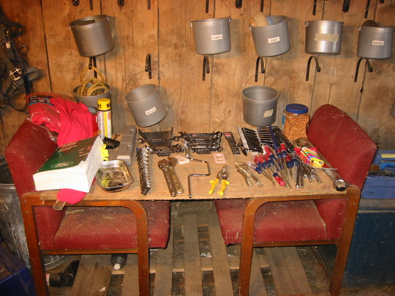

Te second picture is my "workbench". Two old chairs and a piece of OSB that was laying around. I left my big tool box in the workshop, since there is about 300 ft' of mud between here and there, so all the tools are just getting layed out on the workbench.

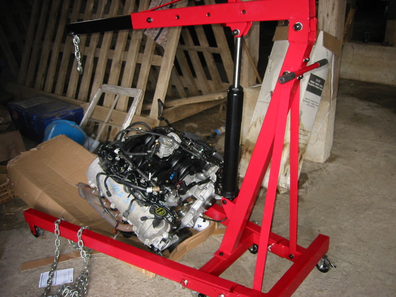

Next up shows the engine and the hoist waiting their turn.

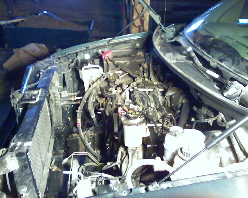

Then a closeup of the truck before I started taking it apart, with the hood off (had a buddy help with the hood a couple days ago.)
Finally, I got a couple of hours work done this afternoon after dinner with the MIL. Air ass'y, and radiator are out.

Nice start Dave. Are you keeping a notebook as to exactly what went where? On my first, um, dozen or so, engine changes I used some masking tape to number wires and mark where they went as well as logging in my notebook where they went. I also used several baby food jars to hold clips, nuts, bolts, etc., and also labeled the jars with masking tape with exactly what was in the jars written on the tape.
I'm sure your memory is better than mine, but I often got pulled away from the job for periods of time to do other things and, without my notes, would have been lost. Good luck!!

Everything is going into Zip-loc bags labeled with a sharpie marker. I haven't thought of doing a notebook, but that's a great idea, I think I'll start one right away.

Excellent idea with the zip-loc bags. You're well on your way to becoming an ASE certified technician. When you finish the job do you wanna take the ASE test? If I passed it, I'm sure you could.
Unfortunately I wasn't close to being an ASE "Master" certified tech though. Apparently that takes more than my 30 years of fixing what I've busted to be able to pass that test.
