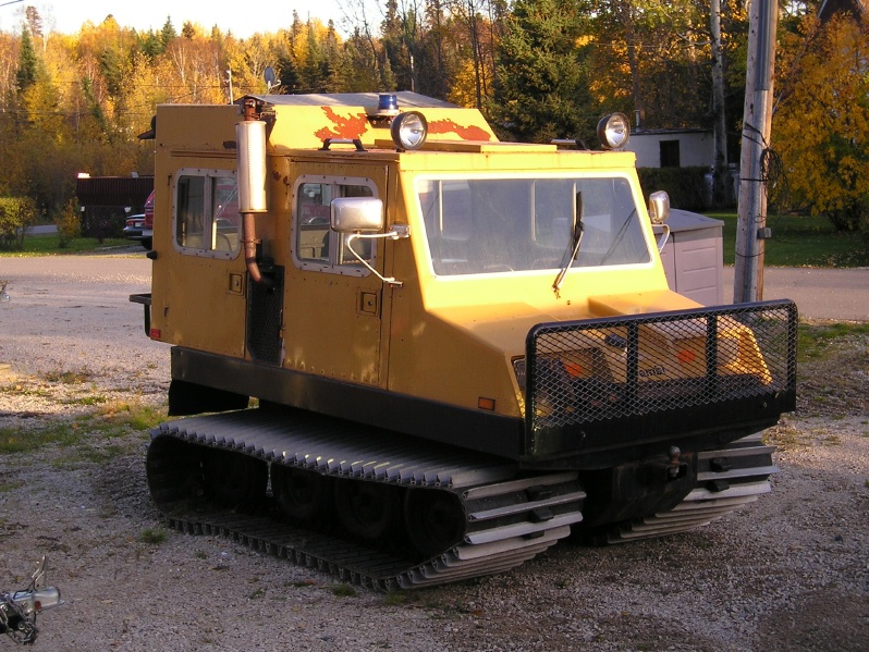

Hi, everyone likes pictures so here is a few of my bombi. I'm using Por-15 silver then I will be top coating with their hardnose paint. Wire brushed, sandblasted, washed with Por's marine clean, then etched the metal with metal ready. I have never used this product (or any kind of autobody products) before so hopefully it turns out!

Nice job, does anybody ever powder coat their cabs?

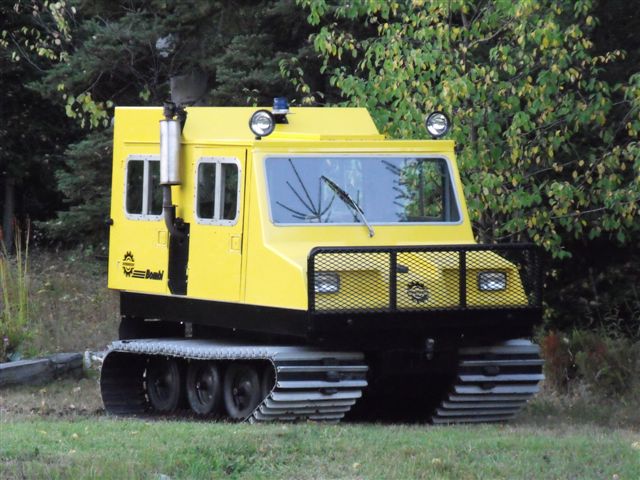

It has been a long process but the Bombi is finished. I'm getting my pics in order and will post more. Here are some of the body work. I used por-15's restogrip body filler and their straightline body filler. The restogrip filled in the corner welds and gaps very well. Then was topped off with the straightline which sanded very smooth for a nice smooth edge. Both products are very strong also.

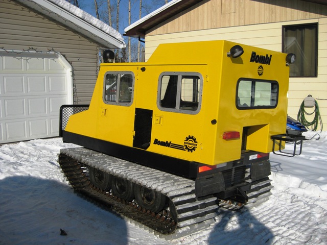

Sorry for the long delay but here are the pictures of the finished Bombi. The sound proofing I added - helped alot. You can now have a conversation inside while you are driving. I am going to close off and sound proof the open area under the dash, as there is still some noise from the differential. Thanks again for all the info and help during this project.

Looks super! It appears to me it could have just rolled off the assembly line you did such good work. Hope you enjoy it in the snow.

where did you get your sound proofing i have been looking for that same style rroduct for my snow trac the best price i can get is $12.00 a linal foot which i estamate will cost about 5 bills imight have a hard time justifing $500.00 to pimp my cat when i can use 50 cent earplugs
