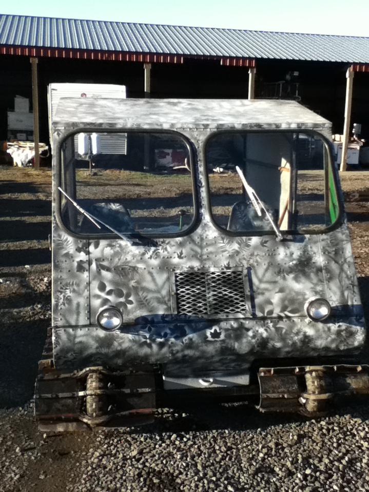

Great thread !:biggrin: I just replace my master cylinders . I had to grind them down to fit . The sticks are too narrow to slide forward over the master cylinders . With a little paint they look great ! Not sure what to do with the old ones . If there's a rebuild kit guess I will buy one and keep the otheres for spare to the next owner !
Going to bleed the system today will check the slaves

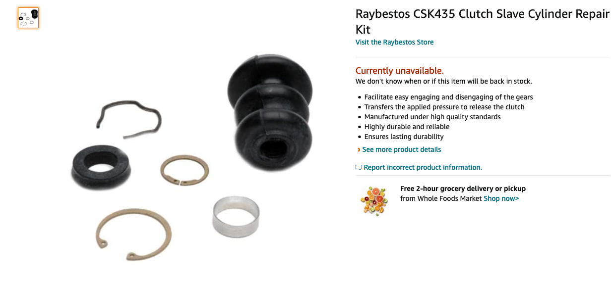

The rebuild kit numbers I found were Raybestos CSK435 and, a long time ago, Napa 435. The Raybestos kit comes with more items than shown above. The Napa number for just the cup is 14451 - 10 cups for $3.
You might be able to gather the kit parts for less than the Amazon price. I bet the retaining rings are standard sizes and the boot was probably used on other cylinders. The only unique part is likely the aluminum sleeve in the Raybestos kit. Does anyone knows the individual part numbers or specs?
Having a rebiuld kit when the cylinder walls are pitted only goes so far -
