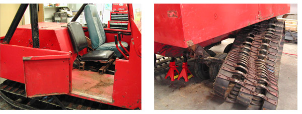

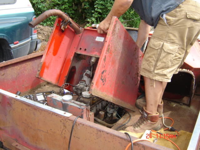

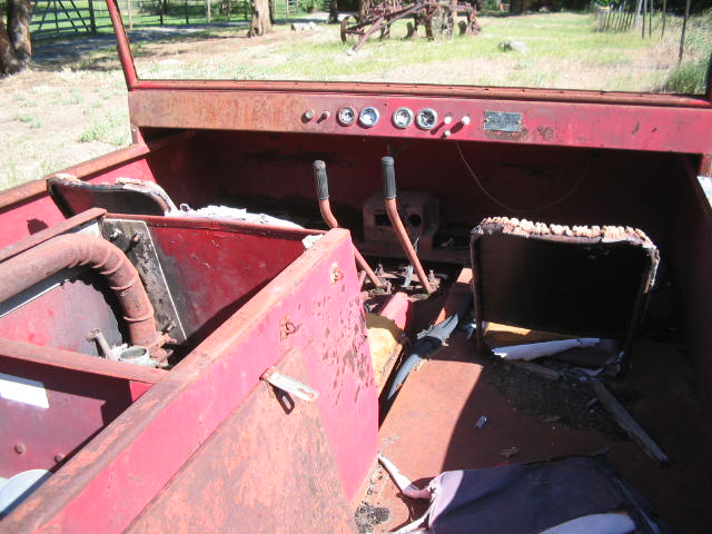

[FONT=&quot]Hello All

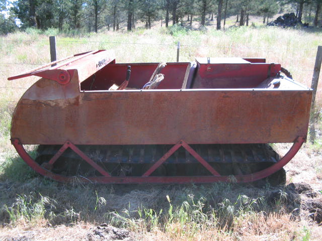

My name is Paul and I live Vancouver Washington. My friends family gave us this 1961 Bombardier “BB Carrier”. We have decided to restore it, any information would be very helpful. Engine: Simca Flash Special 1290cc 57Hp. Transmission: Simca ??? Four speed. Thank's [/FONT]

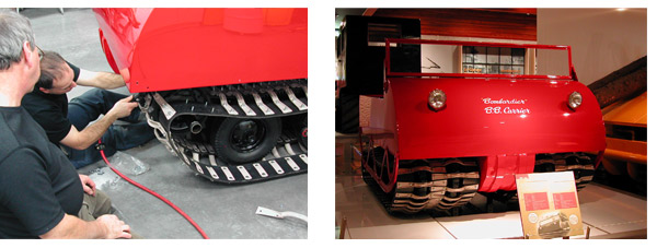

Bombardier BB Carrier 1
The Bombardier BB Carrier 1 was acquired by the J. Armand Bombardier Museum in 2005. It was restored by the museology department and in 2007 became part of a new exhibit entitled Joseph-Armand Bombardier, a passion for invention and enterpreneurship. The 100th anniversary of the birth of the famous inventor provided us with the ideal opportunity to show off this unique vehicle to the public.
Historical background
During the winter of 1957, Joseph-Armand Bombardier was perfecting the invention of new types of vehicles which would move on very light treads. The end result was the Bombardier BB Carrier. From 1959 to 1961, L'Auto-Neige Bombardier Limitée manufactured 32 models of this three-seater, amphibious vehicle. The BB Carrier had many diverse characteristics. It was fast, mobile, light and economical to run. Most remarkable of all, it was able to travel along the water as well as on land. Experimental runs were carried out on lakes and waterways in Québec, like the Saumon River in Kingsbury. This remarkable machine was also used (among other things) for checking out telephone lines and travelling through the forest. Joseph-Armand Bombardier's experiments with light vehicles led directly to the invention of the Ski-Doo®2Snowmobile in 1959.

BB Carrier Interesting find.............. We will have some spares for the machine but no literature. not sure how many were made It could be one of very few. It does resemble the old Muskegs but the tires are smaller and the center of the tub is narrower too. but the sprockets and the cleats are still made.
The cleats are the same as the early snow buses and the the sprockets are same same as the early Sidewalk plows of that era.

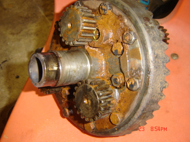

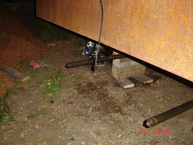

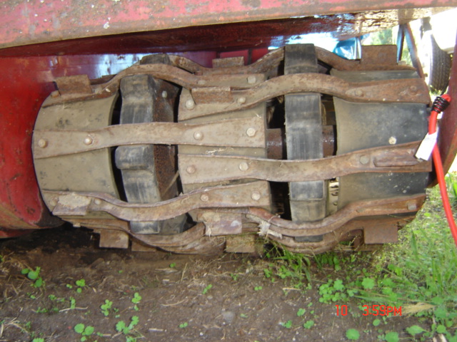

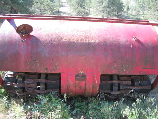

I will post parts list when I get my scanner fixed. Thanks for the link Boggie, very helpful. We have pulled the tracks, wheels, the walking beams were seized, a little heat & a improvised puller. I pulled the differential plug and four gallons of water ran out. We removed differential cover, does not look good. Are any internal gears available? The ring & pinion may be ok. The differential carrier is welded into the center tub and is built differently than the drawings depict. The brake rods come up through the top cover not the front. I don’t know if can see this in the pic’s… Paul

MNoutdoors RIP
BB Carrier, We have all the parts for the Diff,The only thing that looks a little different is the thickness of the Ring gear. Is it a 9tooth or a 6 tooth pinion looks like a 9? 35 tooth Ring? Someone said they may have spot-ed another one of these in Minnesota just lately we are checking into it now. Yes the steering band levers oscillate between top or front on different versions but the chunk is the same.
MNoutdoors RIP
Looks a lot like the diff in the J-5. Casing is slightly different though.
picture.php
picture.php
Yes, you are correct the Chunk on the SW 48,54,64,J5,All SV Models,Muskeg
And even some of the Go-tract is the same with few exceptions the ring and pinions. 9 or 6 tooth pinion and most are a righthand ring left hand pinion but a few are left hand ring and right hand pinion. some of the Go-tracts have a different axle gear but in nutshell most parts are the same.

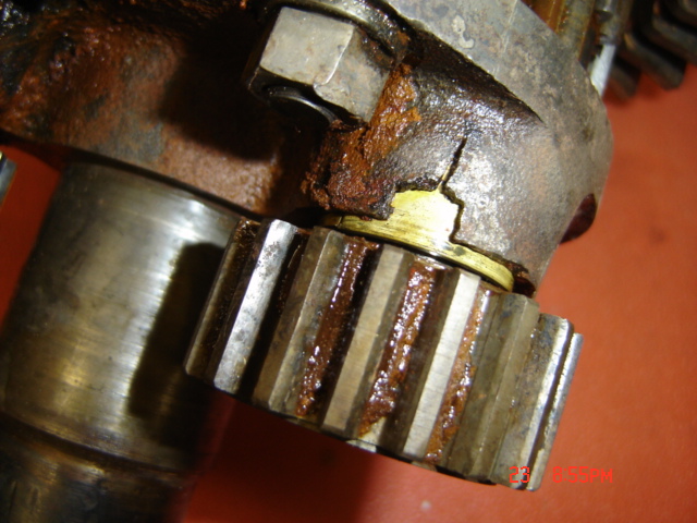

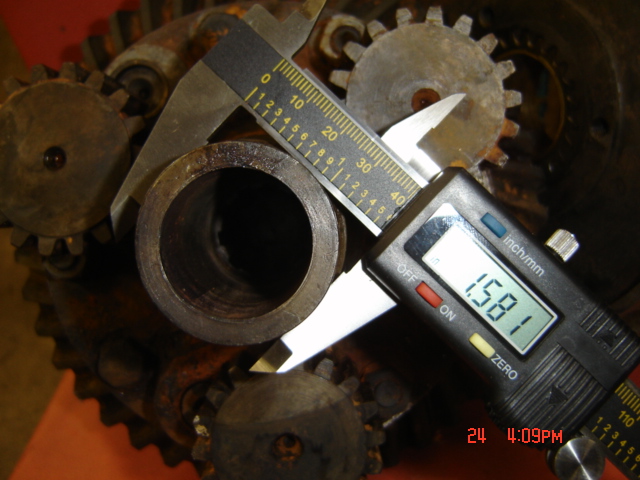

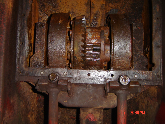

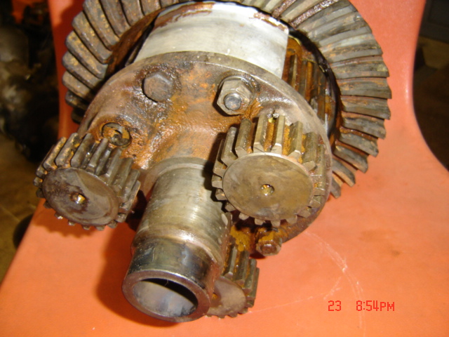

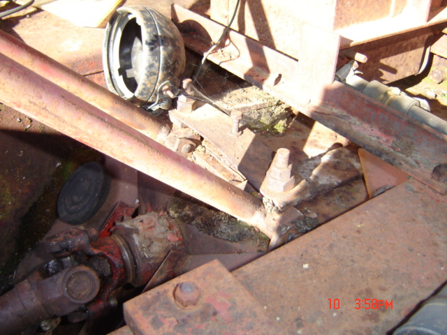

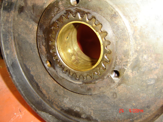

[FONT=&quot]We need some advice please… After six hours the diff is out. Not very easy working under the dashboard. This unit is quite a bit different from the drawings at Boggies site. The planet & pinion gears are one piece. They wrapped brass stock around the shaft and pressed them into the end piece… Are others assembled this way??? All three bosses on the small end are cracked. Side play on planet bushings .125in. The big end is in better shape, but still to sloppy. The ring and pinion gears are Dana, 43 / 8. Are parts available to update this to the two piece planet, pinion? Thanks, Paul[/FONT]

MNoutdoors RIP
That is quite different than most. can you get a shot looking into the case?
what was the bearing number on the ends of the chunk? I'm hoping that you can update it with the modern chunk. if not it may be really hard to find those parts. normally there is a bushing around those shafts.:chris:
BB Carrier
Correction on the end bearings: Cup, Timken # 28317, Cone, Bower # 28156. On this unit the bushing is presses into the brake drum gear. Paul

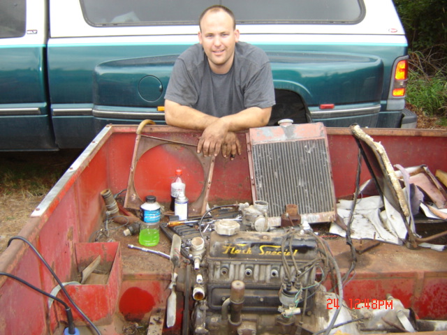

BB Carrier
Hello All, Just letting you know were still at this... but slowly ...
P60 is all rebuilt & runs nice.
Started working on the tracks, a lot of sandblasting.
Paul

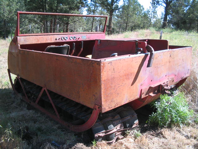

I wonder if I am number 12 or one of the 10 remaining.I am also planning on fixing my B.B.up.I just had it shipped from Halifax, N.S.to Winnipeg, Mb.glad I found this forum.

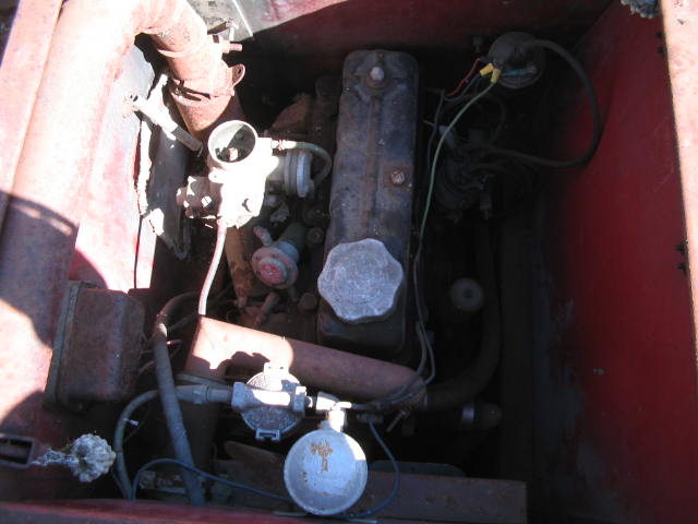

I know this is an old post but I joined just so I could post on it, any updates to it,
I found this ,I was trying to find some info on the BB carrier, as to what it was, I found one here and I'm trying to buy it, I had no idea what it was( I knew it was a Bombardier snow cat but that's all I knew, Its a basket case but its there, if I can make a deal on it I will post it , this one has a flat head straight six in it, hi to all
