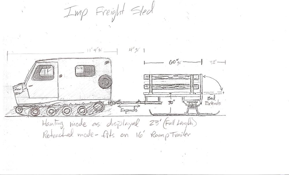

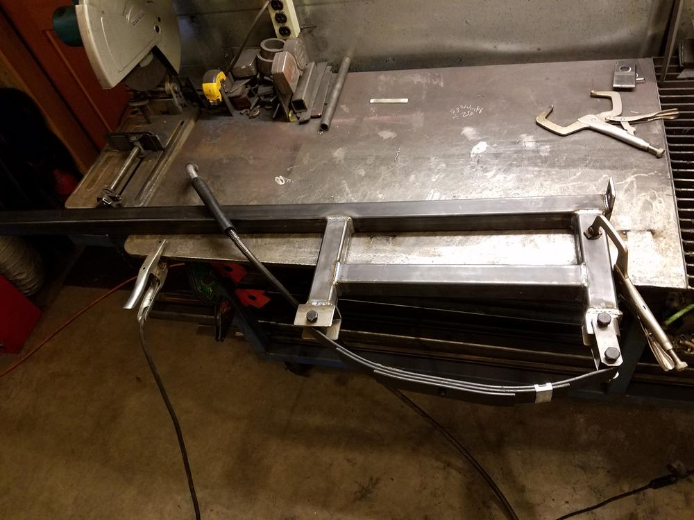

After many hours of looking for the right freight hauling setup, I gave up and went to the drawing board.. We use our cat for cabin access, and are going to be needing it for hauling building materials as well, in order to extend the building season.
Needed something lite, tough, large enough to really haul, yet small enough to get on the ramp trailer with the Imp. Also wanted it for potentially hauling friends, dogs, friend's dogs, kids, grand kids, snowblowers, broken snowmobiles, running snowmobiles, etc. etc.
After more thought, need it for hauling fuel oil, so a transfer tank is in the plan, and also need it after the snow is gone, so trailer axle and wheels is also in the mix.
Below is a sketch of what I came up with, and progress pics. (Can't seem to figure out how to put photos within my text??)

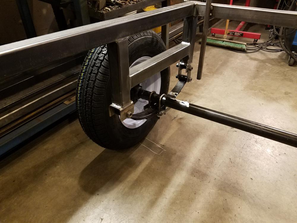

Now that I am underway (Too far to turn around), I have a concern. The skis are approx. 10"x 66", so fairly large. My worry is the large surface area (much like a really large tire) and the sideways strain of turning it in wet snow. The axle is a 2000# (1 3/4"). I guess it is similar to a Tucker pontoon being mounted to a straight axle, only the bearings are not the size of a Tucker. 1320 Sq. In. of float and only 300# of constructed weight means only .22 PSI, and with freight, say .66 PSI on a heavy day, so pretty good flotation.
The question now is do I have a problem? Thought of maybe running a diagonal arm from the ski tip to the center of the axle, so sharing the same pivot point. Can't think of another way since the ski is mounted to the axle hub, and needs to be able to pivot at that point.
The overall width is well within the tracks of my wide track Imp. The skis will be skinned with 1/2" UHMW, so really slick. The deck is all aluminum Perf-O-Grip, so really light.
What you engineers think? Thanks for looking

I'd put some scags running the length of your skis or it's going to want to go sideways on a side hill. I've also noticed when pulling a dead cat with a tow bar they really push hard behind you going down a hill and want to jack-knife more than you would think. Unless you have almost level road be careful with that 1404. A couple loops of chain you can slip over the front of the skis to induce drag when needed might be a good idea.
mikemikelle
Thanks for the thoughts/ideas.
Tongue weight-
The axle location does look far back, in compact mode (see drawing), but is at proper 60% when expanded to hauling mode. That being said, I won't be hauling huge loads (weight wise), and I'll need to load appropriately, both for balance and 1404 considerations.
Skegs/Chains-

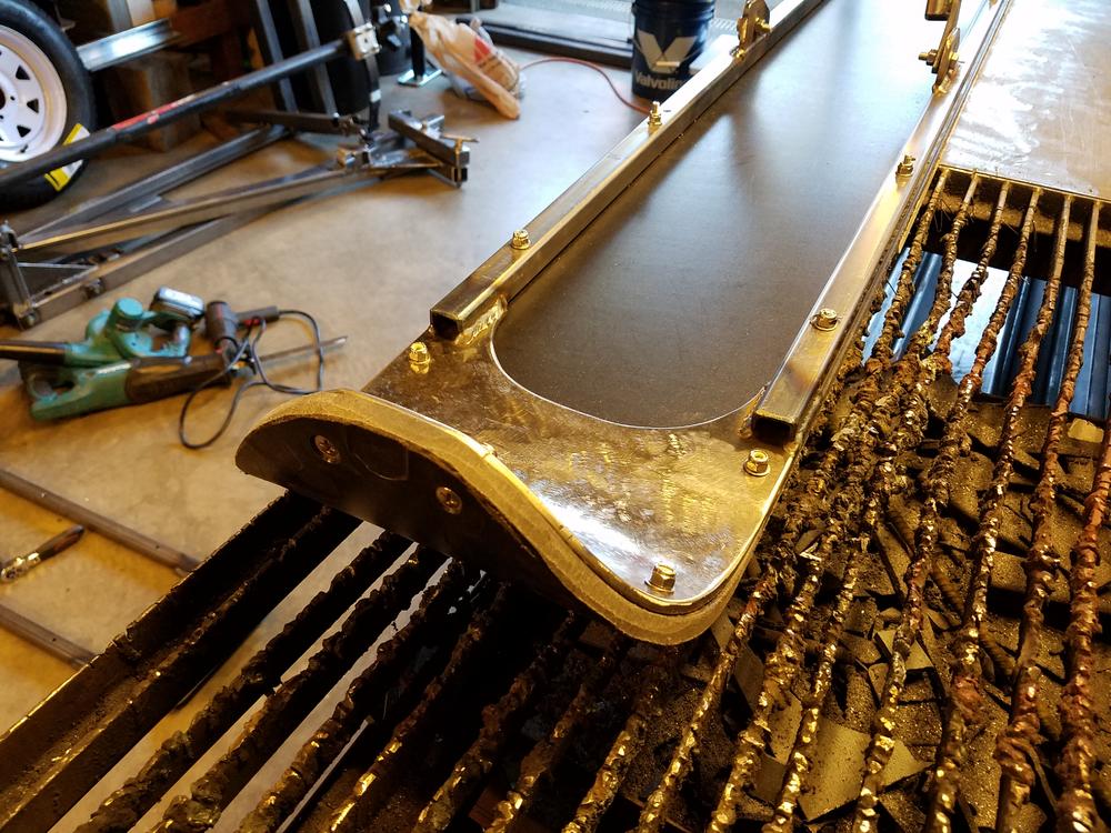

I have UHMW for the ski bases, and was mounting UHMW ribs for skegs for side slip prevention, and to serve as a wear strip for inevitable asphault, etc. I really like the ides for chains underneath to add downhill friction. Wonder what they'll say when I ask for those at Les Schwab?

Just go buy two 12" lengths of chain at any hardware store then tack the ends together to form 2 looks of chain. On steel hills, loop a circle of chain over each ski tip and tow away. It works great. Another option that is lighter, quieter and won't scratch stuff is using old snowmobile drive belts. Probably free from any dealer. Same idea and in my opinion, creates even more drag due to the shape of the belt. They are very tough and will not break.
undy
When I've skied out of Salt Lake City, we catch a city bus up one of the canyons. Those buses have chains for the rear duals which they can deploy automatically with the pull of a dash lever. (In that case, the chains are let out from between the duals.)
Perhaps a person could build some chain loop that could be deployed over the front of the skis via an actuator (electric or hydraulic or ?) to work as a brake?

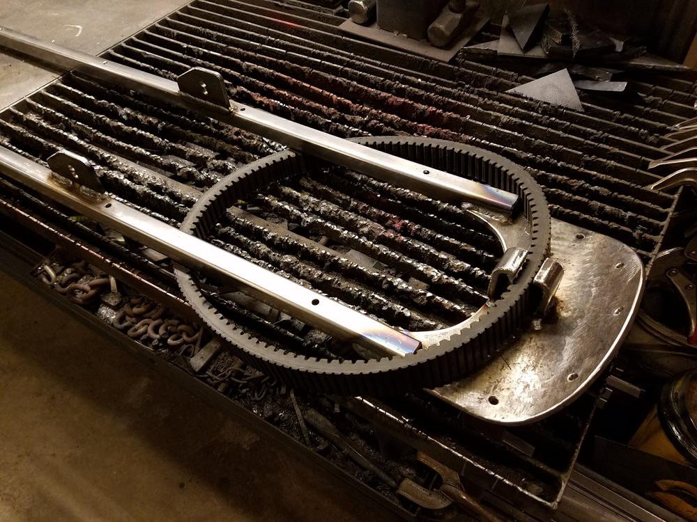

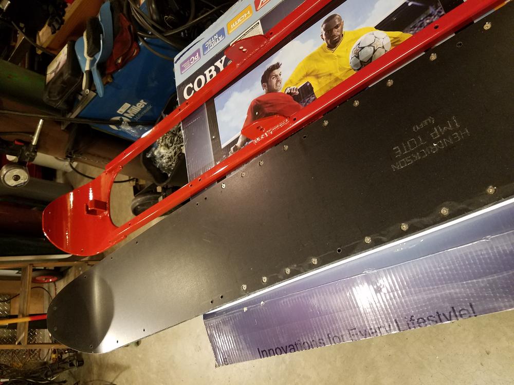

UHMW skins mounted and bent to the ski frames
Sacrificial skegs/skags (whatever they're called?) mounted to the bottoms for side slip prevention
Skis done!!

For those of you trying to put the brakes on my project (you know who you are!), here ya go.... :pat:
Snowmobile belts it is!! Thanks for the great idea
Made the notch slightly narrower than the belt, and ground a small area of belt for install/removal
Belt stores nicely between the rails too
Put one on the back also, to use as a parking brake when unhooking the trailer
Simple, clean, cheap (free), and non-scratch. If needed I could install some bolts for icy stuff
Thanks again for the input

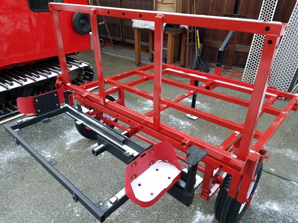

Progress, though mother nature is conspiring against me-
We got 6" of snow, and I didn't see it in the forecast! 2 canopies toasted
The hitch carrier is one I built for the jeep, but additionally fits the cat or the trailer. Below is a photo of it with the cooler
The pulling hitch is stowed in the upright position in this pic. A smaller hitch allows it to fit behind the Imp on the ramp trailer.

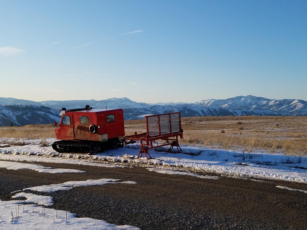

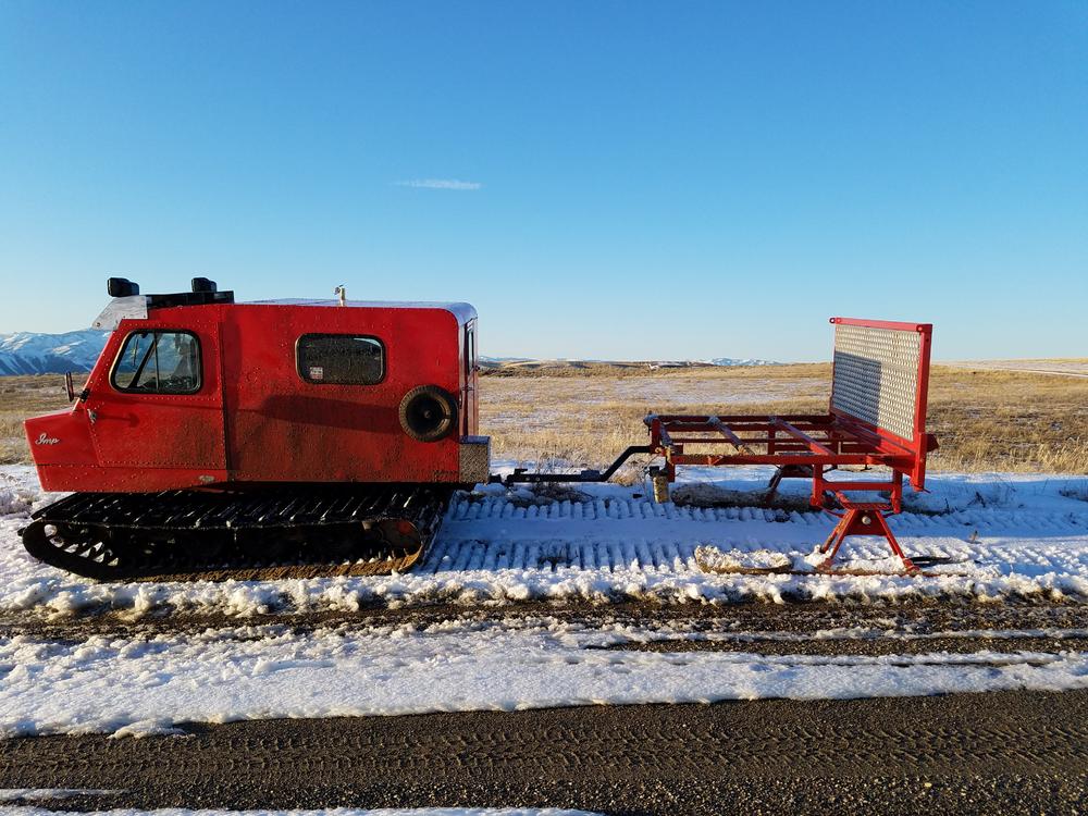

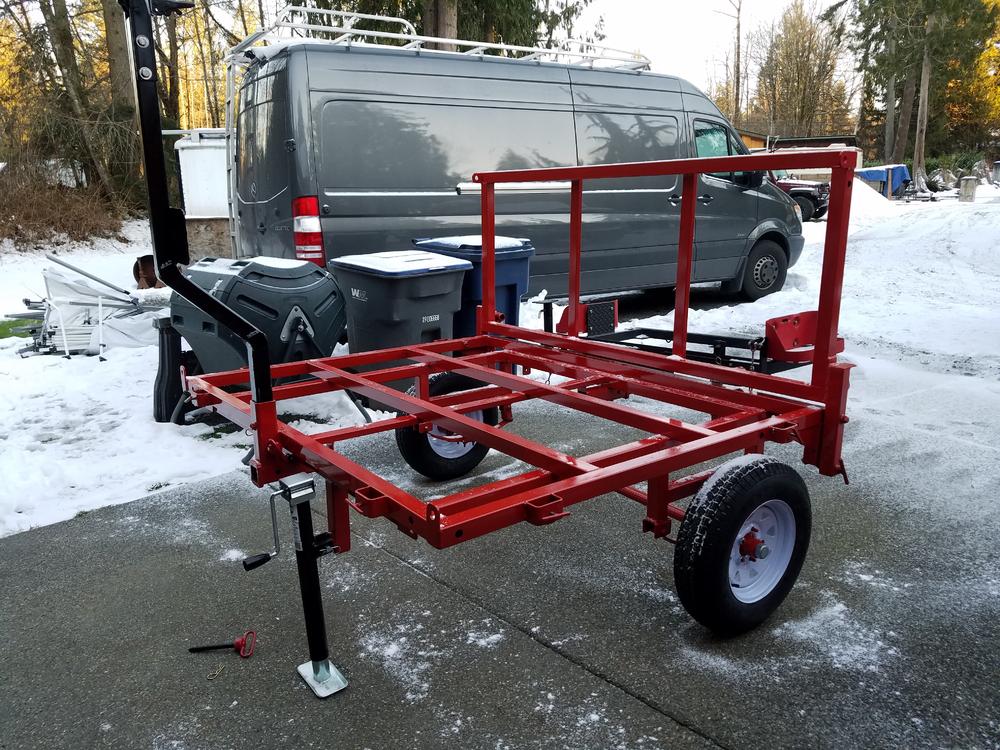

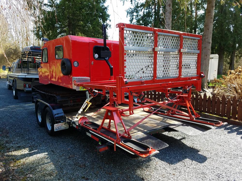

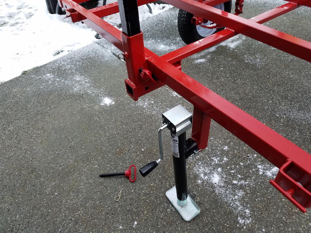

Trailer fab done, painted, and time to check the fit on the ramp trailer, before I get all the small details done. Better to know now if something needs tweaking. Going to haul the trailer up to the property for "snow trials". Hoping it all works as intended.
The trailer has 3 modes (hence the "convertible" title)
1) Compact mode- For fitting on, and hauling on the ramp trailer with the cat. This uses the "short" hitch, which is placed in the receiver backwards, and wraps back under to the front, allowing up-close proximity to the cat. You can still get in the back door of the cat, and you can still turn slightly while positioning during loading.
2) Hauling mode- Either 6 ft length (folded up) or 9ft length (folded down into a flat deck). This involves replacing the "short"hitch with the vertically stowed "long" hitch. Later on I'm going to incorporate a snap-on seating bench (against the upright back 1/3 of the deck), this will be for extra seating/sleigh rides (snow cat rumble seat).
3)Ramp mode- The back 1/3 of the deck can be dropped down to a 22 degree ramp, and rests on large rubber bump stops. For hauling snow blower, quad, snowmobile, etc. (sorry, no picture yet)
Have all the Perf-O-Grip deck panels done, but still needed to finish securing them, so they were left at home.
The picture below shows "Hauling" mode (6ft), with the "long" hitch installed. (over 90 degree of turning clearance due to length).

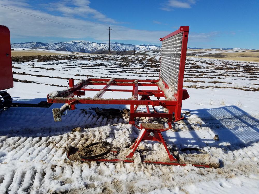

Trial by Fire- The snow conditions were less than ideal. I expected a bit more snow. The unexpected melt off turned the 4 mile approach road into a quagmire. My 10,000 lb truck, and combined 5300 lb trailer load were not going to make it. Had to unload the cat, and start a real-life worst case scenario for the actual maiden voyage. I was intending on putting it to the test, but slowly (It's always tough that first time you're going to hammer a freshly painted project. OUCH!!) Felt like one of you Tucker-ites after freshly painted pontoons!!
Hammer I did! Combined several miles of gravel, mud, wheat stubble with plow mounds, ice, rocks, some snow, but overall a true workout. Lots of turning to try and stay on snow patches, and all done at normal travel speed.
Trailer pulled perfectly. Didn't even know it was back there (with an under powered Imp) Never bucked, never submarined, never jolted the cat. Granted this was done without a load, but any load will most likely be on better snow.
