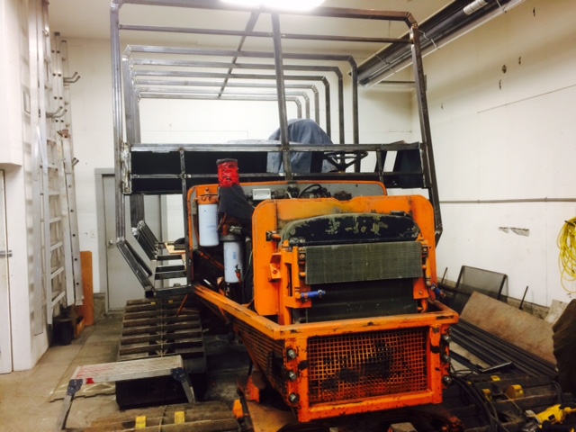

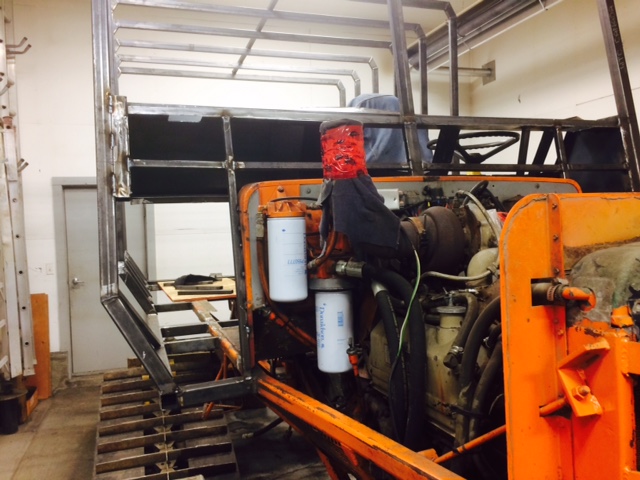

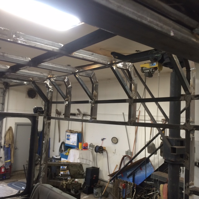

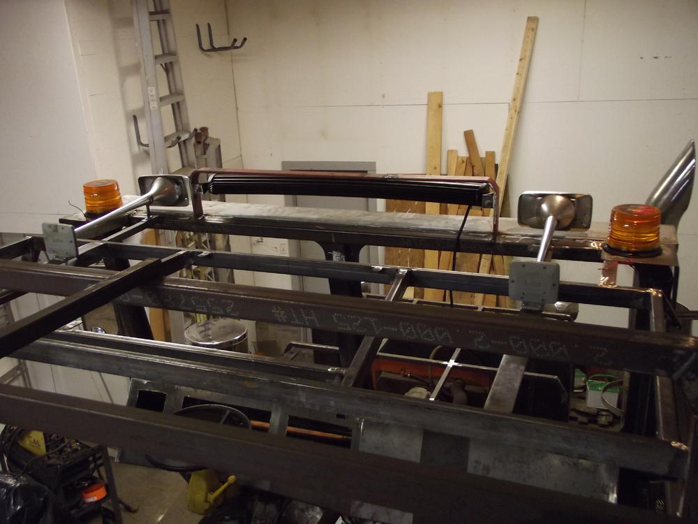

I've had a few days to work on my project. I know that at this time it looks like a grain elevator on tracks, but when I'm done, it will look more proportionate, I hope. Also please remember I'm building this to fit some one over 6' tall and I like things that are user friendly. The cab was 51" wide, it's now 86". I can't remember how high it was, but it is now 6' inside. The drivers seat runs at 23" high to fit me and the front passenger seat will be at 21". Both these seats a from a T800 Kenworth and the drivers will be air ride. The tilt steering column is out of a New Holland combine. I broke the dash up to what I think will be comfortable and user friendly. There will be 7' of room from the drivers seat back, which will allow me to install 3 bench seats, from Dodge Caravans, in a U shape. This gives 8 adult passenger capability or at least a dozen kids. The front windshields will measure 28" high by 36" long x 2, so it won't be like looking out a port hole in a ship. The drivers and passenger door windows are 48" long by 26" high. I have 4 windows from Duetz tractors that I'm going to install along the sides in the rear passenger compartment, and I'm unsure if I'm putting 1 window on the rear or 3. I'm now going to start working on the engine compartment, air cleaner and exhaust stack. I'm using all 100 wall tubing and the body will be skinned with .040 powder baked aluminum, so it won't be as heavy as it may look. If we don't get anymore than the 8" of snow we have, weight may not be a problem.

At the risk of offending some here, it won't be any more custom than some straight from Medford. Knowing the 'why' behind the changes is 90% of making successful modifications in my opinion.
teamster
You are correct, a lot of the things I'm doing are straight from the more modern sno cats as well as some personnel preferences. Unfortunately I have a very limited budget for this project, so there's a lot of recycled materials going into this one.

The only things that will be using compressed air are the drivers seat and the air horns. My plan is to use a 12 volt air compressor, with a pressure sensor, connected to a small 2 gallon coolant tank from a Western Star for reserve. I've pressure tested the tank to 150 psi, and the tank has numerous pipe fittings already welded into it so I can inject alcohol if needed. The air line system will be fairly short, so with alcohol and the short system I don't foresee a problem.

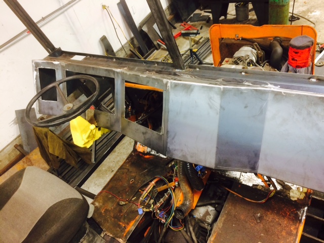

I've had a bit of time to work on my project, so I thought I'd share and update. I've been called a fabricator and a recycler. When I bought this Tucker I immediately started collecting parts for this project. I was given 2 rolled cabs, both with integral sleepers. One of a 2006 Western Star and a 2007 T800 Kenworth. Then I bought some windows from a tractor wrecker and an old RV. I found a tilt steering column from a New Holland combine, and 2 side windows from an old street sweeper. I stripped both of the truck cabs, keeping anything I thought I might need, from stainless nuts and bolts to air cleaners, and sound proofing. The rest went to the scrap bin. I'm sure you'll spot some parts. I used the original muffler, from the Tucker, and modified it from straight thru inlet/outlet to side inlet. The mirrors are Motor Mirrors so the electrically move in and out as well as being heated. The little doors, behind the entrance doors are for access to the outside storage, the same as on the sleeper of a truck. I'm using one of the side windows from a Duetz tractor for my sky light, it fastens in with 4 thumb screws, and has a seal around the outside edge. It seems to take me a long time to get much done anymore, but I really enjoy finding cheap parts and building them into something, only problem is that I don't usually keep things to long and then onto something else. This is my 6th Snowcat and I'm building this one to fit me and my needs, so maybe I'll keep it, ( probably because no one else would want it.)

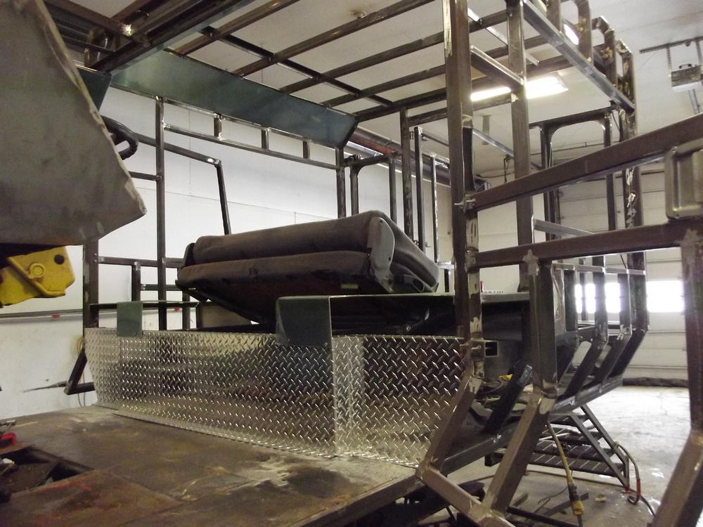

I've been working on my cat a little lately. I told my wife that unless I'm dead, or there isn't a get together in McCall in 2018, I'm going to be there, she told me I better get it finished before she cremates me, because what the heck would anybody ever do with a project like mine. I told her that if I kick the bucket, find this post and give the project to someone, and then she won't have to worry about it. Anyway, I know the rear steps are a little over kill, but I like things that are user friendly, and if I ever find a place with lots of snow, they come off by pulling 3 pins. They hydraulically raise to a vertical position. The 2 small steps, underneath, are in the receiver hitch, for when the large ones are off. As you can see, I've started to fit the aluminum for the kick panels, seat consoles and speaker areas. My next step is to mount the hydraulic controls, park brake and shifter between the front seats and then enclose the area with an aluminum console.

That is looking great!! do you have any idea what the weight will be when you are done? Those back stairs seem like massive overkill, but I figured out a long time ago that there is no one right way... and lots of better ideas than the ones I come up with! ;)
I am really liking what you did with the dash and seat, that is going to be a really comfortable machine to operate. Looking forward to seeing how things develop!
I was thinking I might still have an old Western Star grill emblem around here somewhere:wink:
teamster
I'm not sure what it will weigh, I know it was quite heavy when I hauled it home. The club I bought it from had put a lot of heavy iron on it, such as the battery boxes and the gooseneck ball system they pulled their groomer with. I must have cut off a couple thousand pounds off it and I haven't bought 2000 lbs yet. because I'm going to skin it with light aluminum, it needs a fairly strong skeleton to support it. Also I'm going to insulate it with 2" to keep it warm and I like music, not machinery noise. The rear steps do weigh a couple hundred lbs, but we haven't had enough snow around here to stop the cleats from tearing up the grass. If I think the stairs will be too heavy for the machine to pack them, I'll kick them off.

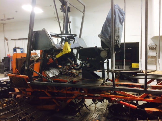

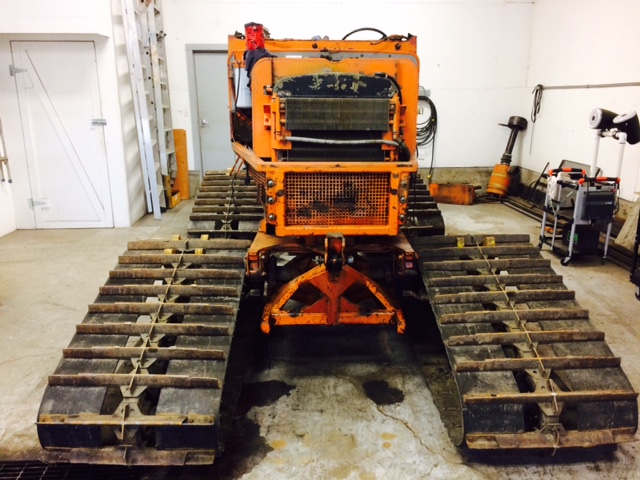

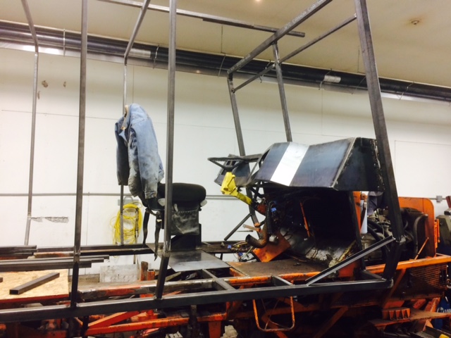

teamster
I checked my old day timer and the day I hauled it home, as in the pictures, it weighed 11560 lbs. The blade adds alot. We will see what it weights when finished.

teamster
Well. the fabricating is done, the dismantle ling is done, the fab shop is converted to a paint shop, the sand blasting has started, and the painting has started. No the slimy green is not the color, it's Endura primer. McCall 2018 here I come. Sorry if I double posted.

Blackfoot Tucker
I've followed your progress and I'm very much looking forward to seeing this machine completed. Will pictures be posted prior to McCall?
teamster
I better have snow flying off the tracks prior to McCall, so I can see if I have to throw it in the scrap yard and start over. But yes I will post pictures as I put the skin on it and reassemble it.
