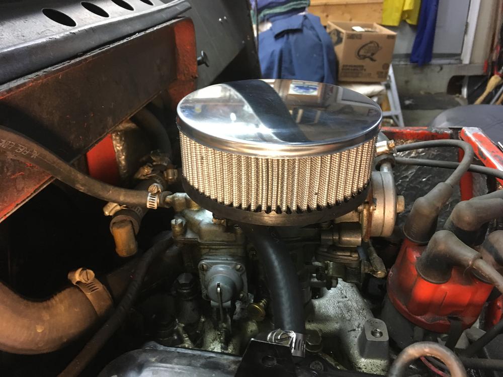

Thebartman
So...here's what I'm going to try. An air cooled VW air filter. Fits perfect.
I don't think intake air in the "doghouse" will be any warmer than the air from the heated cab so I'm not concerned.
Seems like it is quieter already. If not the aircraft intercom system is on the way anyhow.
Test drive today. Boondocking in deep fresh snow.
