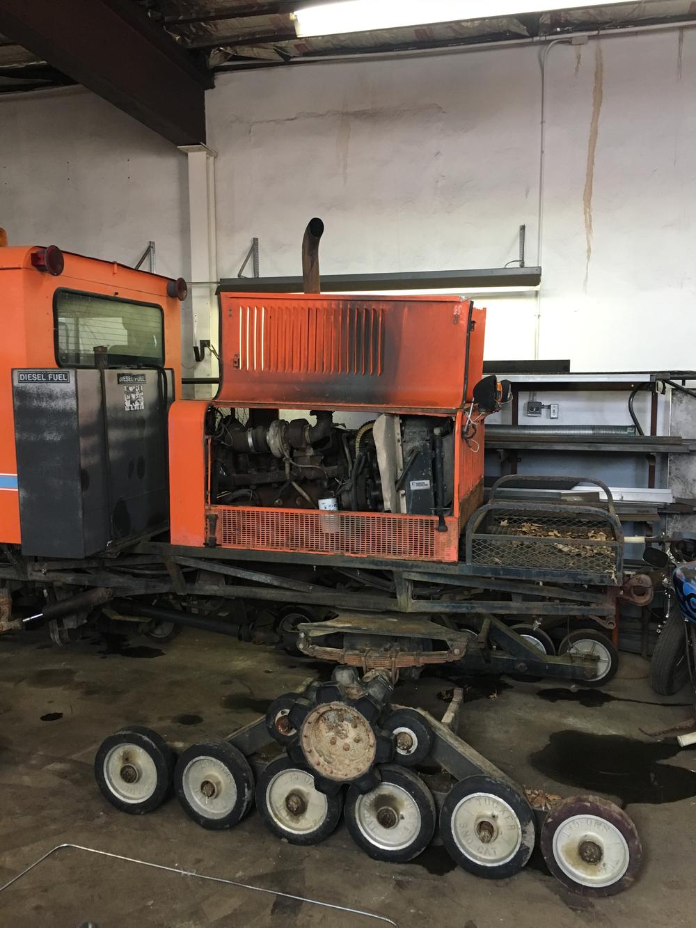

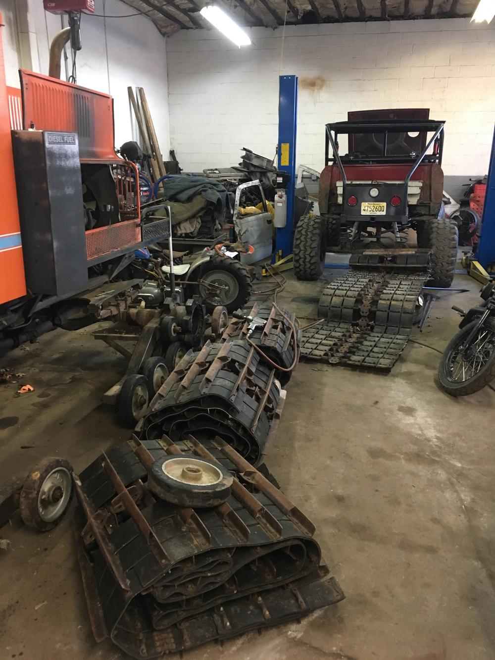

Hey guys so I couldnt pass on this deal and ended up with my first Tucker.. Still looking for an older steel track machine but this is the newest to the fleet. And its got the 12 valve cummins with allison auto. Basically i want to cut the tracks down so transporting is closer to 102" wide.. Is that ok to do on such a heavy maachine and is it nessacary to cut the outside and inside belts and graousers or can i just Take off the outers to make more narrow? I am also in need of a solid rubber wheel complete And 5 sets of bearing for the bad existing ones. I have a manual with part numbers but was wondering if anyone had numbers that the auto parts store would know. Thanks

I had a 1990 2000C with the same track configuration I also was going to do the same thing trying to get it narrower to transport, but some quality time with the ye old tape measure still showed that cutting the outside belt off would still leave it over width. So i opted for still getting a permit and leaving the tracks full width and keeping the flotation. Just my .02 and there have been plenty of them cut down, but that is a heavy machine, mine was 11,700 with the blade and a 360, so more track the better in my opinion.

thnaks for the info. The tag on it says curb weight is 8607 lbs.. if i cut the outer belts off it brings width to 107 inches.. id rather not take the tracks on and off when transporting or dealing with permits, so was thinking 107 will only hang off of our 102" width trailer 2.5 on each side which atleast will almost look legal. ha ha . if i do cut the outside belt down can i leave the extra inner belt or will the track ride funny with the extra weight on inside of track? thanks

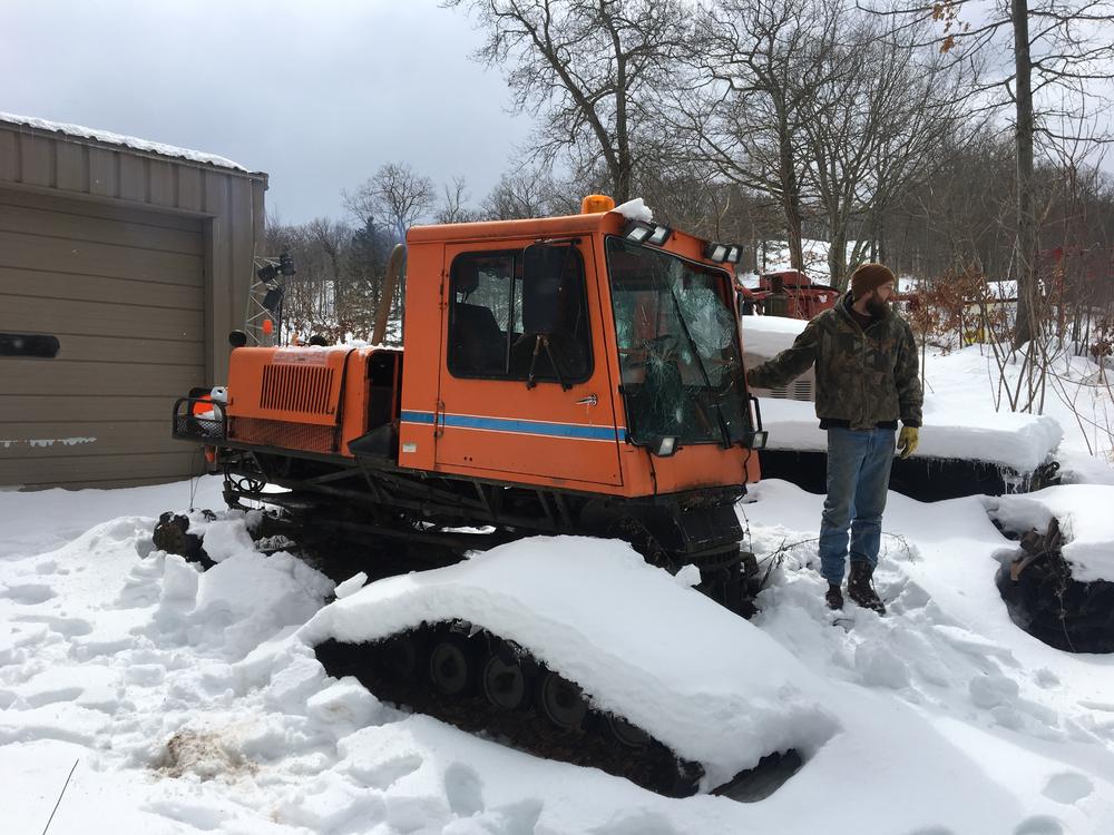

Nothing new under the sun/snow. Wide stance- narrow track, dun there been that.
