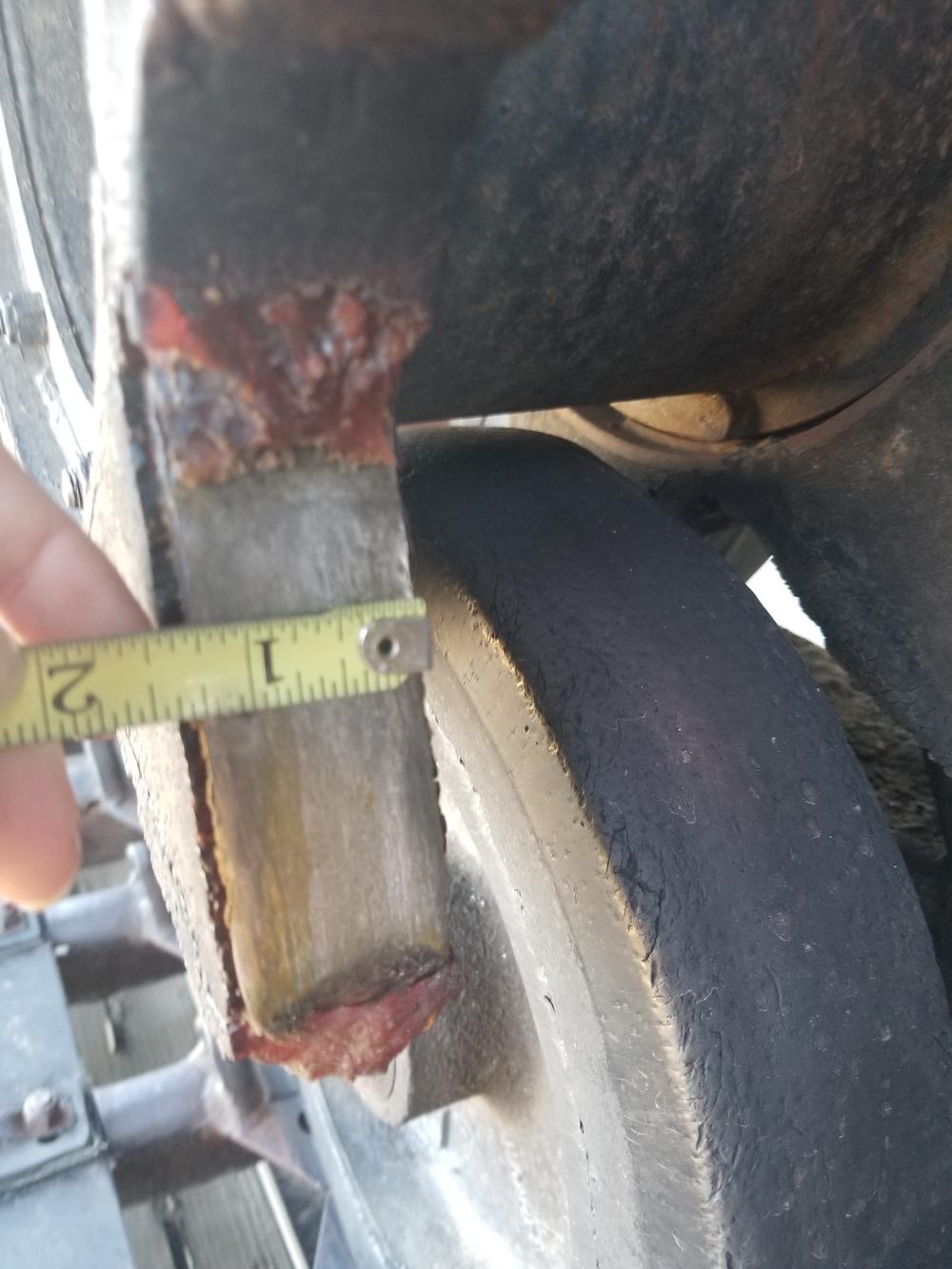

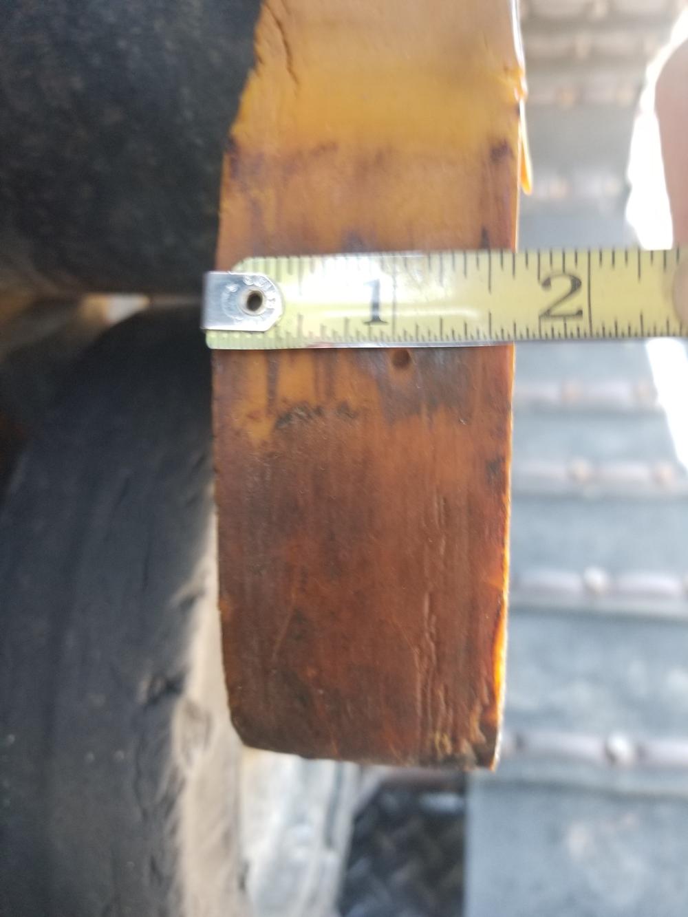

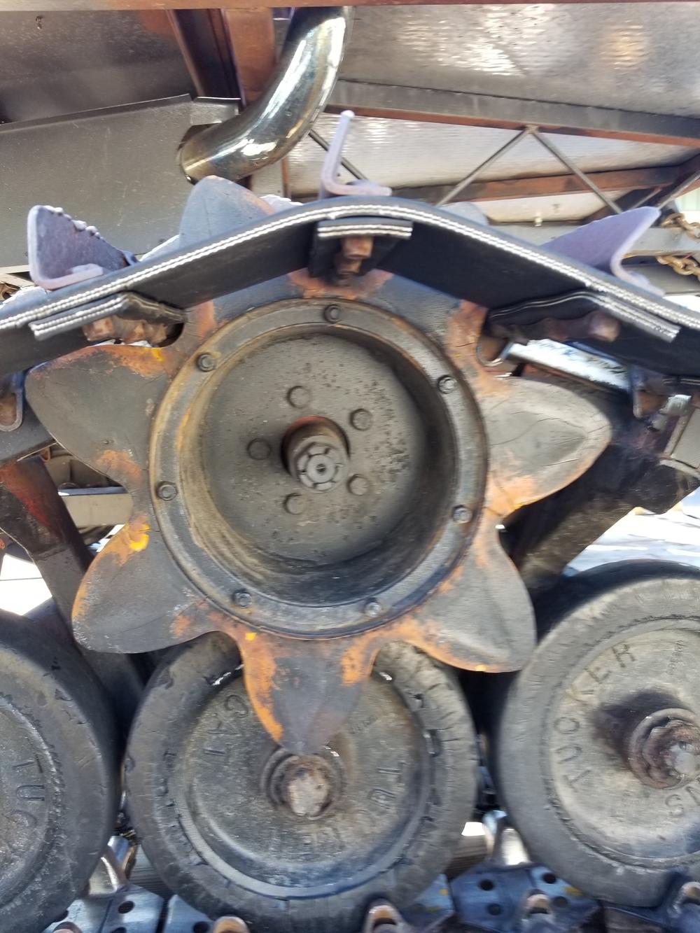

I thought it would be worth a try to see if anyone has a set or two of drive sprockets for our Snocat. If not will be sending to falline to have them recoated. Any info on life expectancy on recoated sprockets would be helpful.
I hope pics came through first time user
Thank You

Get prices from falline, and then call tucker if you haven't already. Before you make decision.

There be wiser and more reliable sources of info than I. But, call tucker and ask. I'm pretty certain though that your track assembly is much later than original equipment. They might be able to help you with that as well. Have data plate info handy when you call.

Welcome, good looking cat most of the parts are readily available at any good parts store, mostly swap over to Dodge pick-ups of the same vintage.

I agree with Tom that the tracks and carriers are likely from a later machine. My impression is that as Tucker transitioned from pontoons and steel tracks to rubber belts and carriers they also changed from using Dodge 1/2 ton corporate axles to Dana 60 axles. Some machines were hybrids in that they used the Dodge axles, but also carriers and belts. I think Track Addict's 1443 is one of those.
I'm reluctant to offer an opinion because I'm not sure what you have, and I hope you can understand that. Generally, having the data plate information handy when you call Tucker is helpful, but as the machine has probably been modified from its as-built configuration, they will likely need some photos and measurements to get you the right parts. I recommend you speak with Jeff Godard at Tucker. Though he works in sales, he was the parts and service manager beforehand. He is hugely knowledgeable, and very generous with his time. In short; he's a great guy!
I've never bought parts from Fall Line in Reno, however based upon recent reports from other forum members, I have enough concerns that I won't buy from them.

I have the same sprockets with 6 boogie carriers on my 1981 543HD with the Dana 60ís but have the 4 band setup. It appears that the worn out sprockets were recasts and I havenít seen any worn that bad before. It doesnít look like there is enough material on the back side to rotate them inner/outer.
The cat had a few new recasts sprockets when I bought it so I made a template for future use.

Thank You, info helps a lot. I asked my co/worker to visit Tucker Medford in a few weeks to pick up a set. We will also have a set recoated just to have spares in the shop. We are new to the Snocat world and only have had the cat for a year. Our first long haul to the cabin we discovered some mechanical issues, so it is getting an overhaul at a local shop. (Lost clutch in a snowstorm Medicine Lake Highlands makes its own weather :) I have a feeling if someone has spares you hang on to them

That cat has the same Tucker carrier upgrade I have. I believe the cat was originally a groomer in Bow, NH and was converted many moons ago. Went to the prior owner's shop for repair and they decided that it was time for a new groomer vs investing any more money. Tom eventually did the work and got it to the point you have it. Dodge 8 3/4 rear end with the short axles.
One thing I thought he told me is he changed the gearing in the differentials for running on the lake for more speed. That cat may not be geared as low as it needs to be for your use. Thinking on hills you would have increased clutch work vs an icy always flat lake.
This is a link to the parts manual that will have the carrier and axle parts. Once you get to the clutch and master that might be more along the lines of a 442 Manual. Both are here:
Track and carrier first few pages: http://www.goldcordmine.com/manuals/...201342(75).pdf

Another thing to look at is you carrier wear. As they wear the sprockets go into the track grousers at and angle. Eventually they rub the edge of the track which would wear down the side of the sprockets. Check the axle end play make sure the sprocket does not move in and out.
