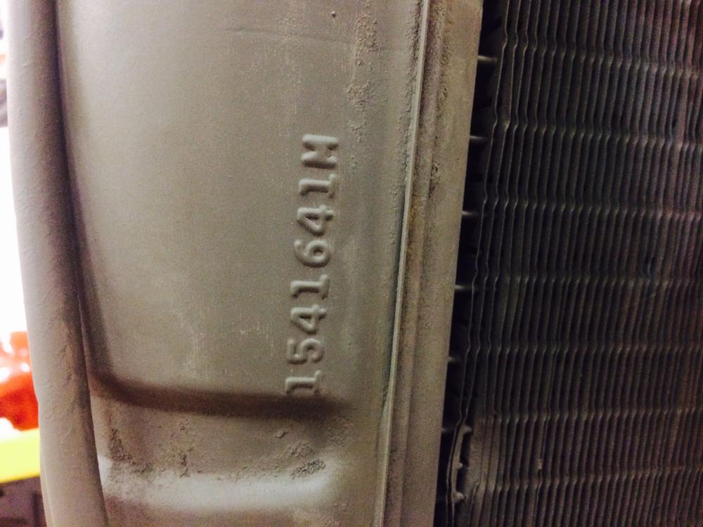

I am painting up my radiator which did not leak but looking at the repair jobs it will.
From what I have found it appears to be 50's chrysler 300 part number for radiator wo
Ac.
Can't find a replacement . D 100 radiator pics look close.
Help
I just had the radiator for the '59 restoration we are doing recored. Cost $478. This way all the holes still line up and the outlets are in the right place as they use the old tanks and side flanges.
I will be out at the shop we use and take the no. you show and let them see the radiator and maybe they can come up with an answer for you. Tucker used many Chrysler parts, but with the Chev engine, all bets are off.
We were using Lowell Radiator all the time until everything switched over to the plastic crap in use now. They still do re-cores on some of our older stuff. So, if you can't get a complete unit, that would be the way to go. And since you aren't going to be out in the wilderness, I would just run it until it pops then have them fix it at that time since they are close.
That's what I am thinking. I spoke with rogers and lowell and they said few day turn around but if I can not spend 400 or 500$ that woudl be great. Tucker still needs quite a bit more $$$$!
If it does blow apart, or you just want it changed out anyway, let me price it out thru here on our account. Should (better!) be a little cheaper.
