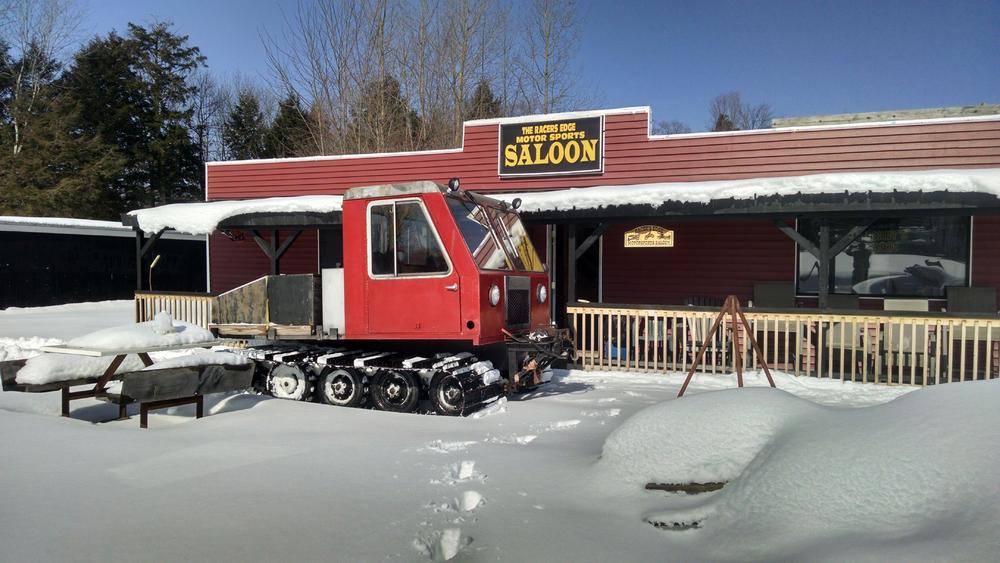

with ya----------on being lazy--------I have 2 fab shops with every tool a man could want-----but iam getting burned out----and than what did I do---go buy this ugly sv200 that needs a new cab----o ya and the wiring---I carry a fire ext.
