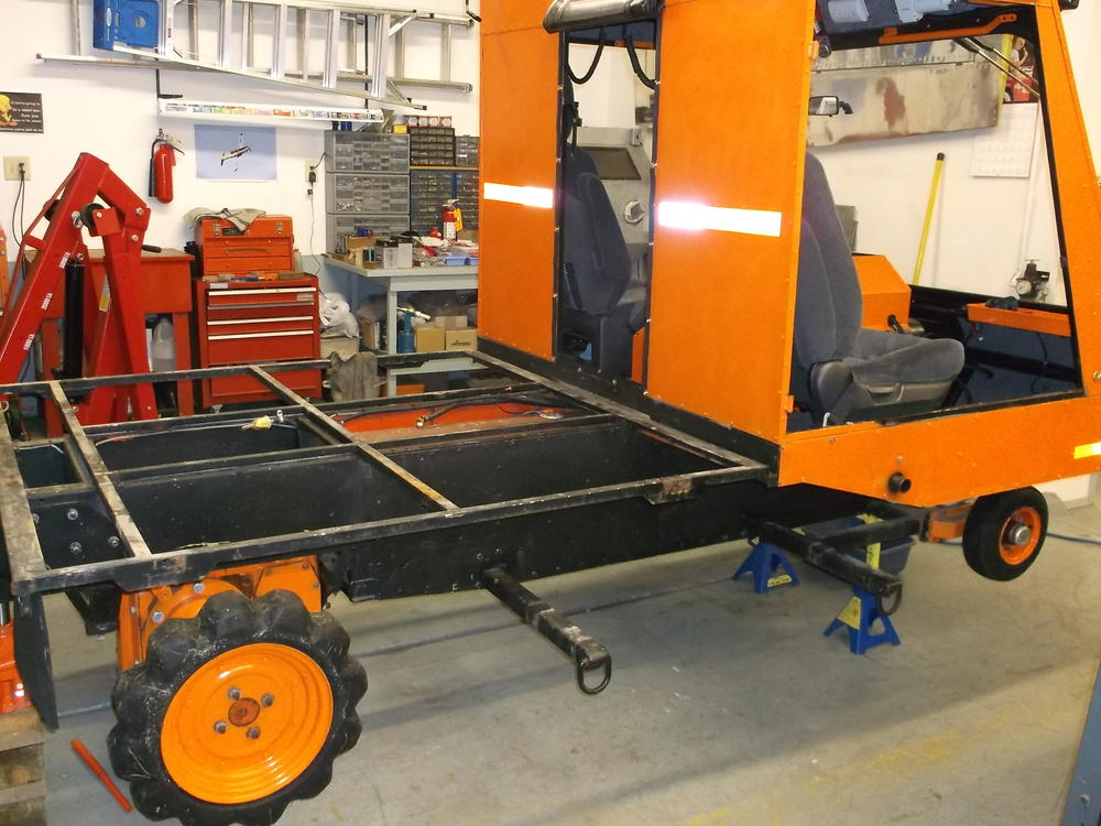

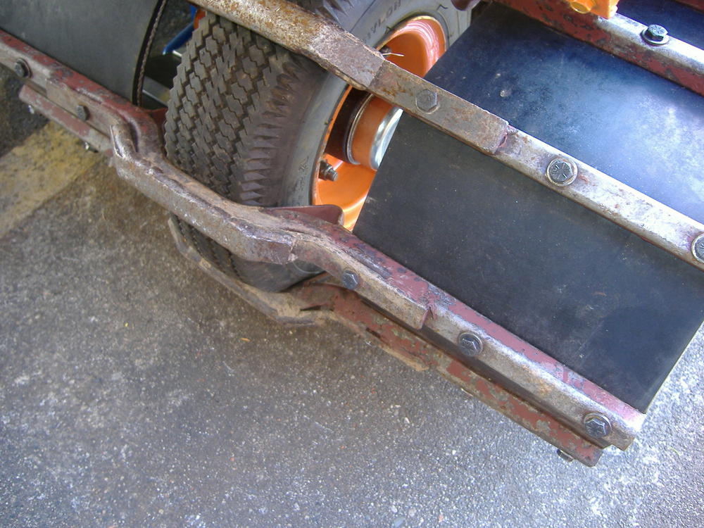

I have the same problem with my Imp when going downhill, especially when turning. No problem going uphill.
Here's my theory: On a rear sprocket machine when going uphill, the bottom of the track is tight (top is slack) and stays at its correct pitch for the sprocket, so it rides correctly in the sprocket teeth. (Unless it is really loose) When going downhill, the bottom of the track is slack, (top is tight) and tends to bunch up which shortens the track pitch slightly, causing it to ride up on the sprocket until it is tight and then jumps into the bottom of the tooth. (Like a bicycle with a worn chain) This more pronounced on the side with brake applied.
I keep my track fairly snug but it still does it. The 1402 uses a 3 position adjustable front idler which is then inflated to 65-70 psi to maintain track tension. When going downhill there is more visible "squish" of the tire than when going uphill.
The imp manual says that tooth jumping is normal and not a problem, and in fact cautions against running it too tight.
My imp has the 12 tooth wheel sprocket which doesn't have very deep teeth, so I thought that was the part of the problem, but apparently I am not alone.
