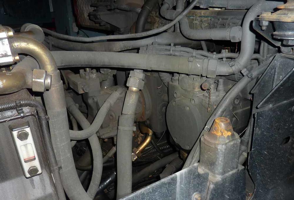

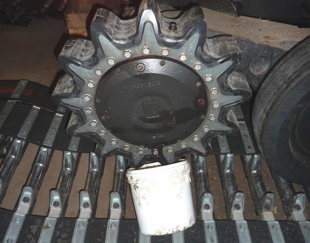

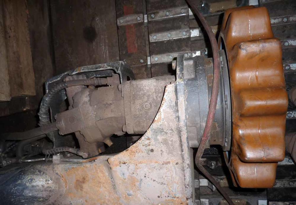

The idlers came off for grease time. New drive sprockets already installed. These machine have three pumps, as seen in the bottom photo. They do break torsion bars and occasionally the forged idler arms.

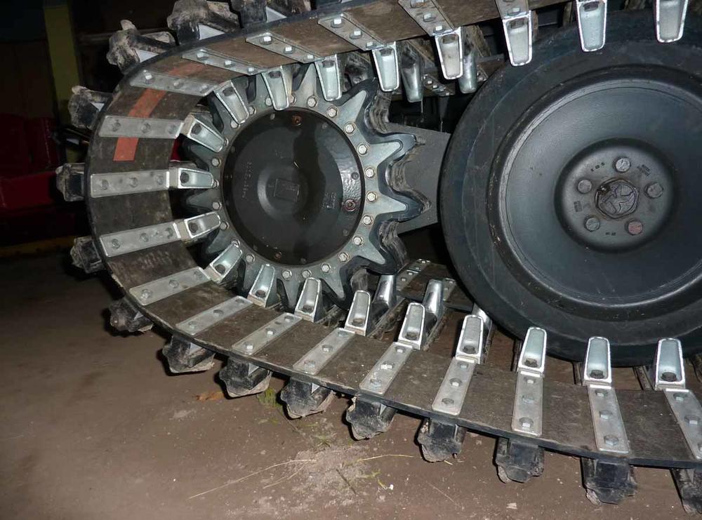

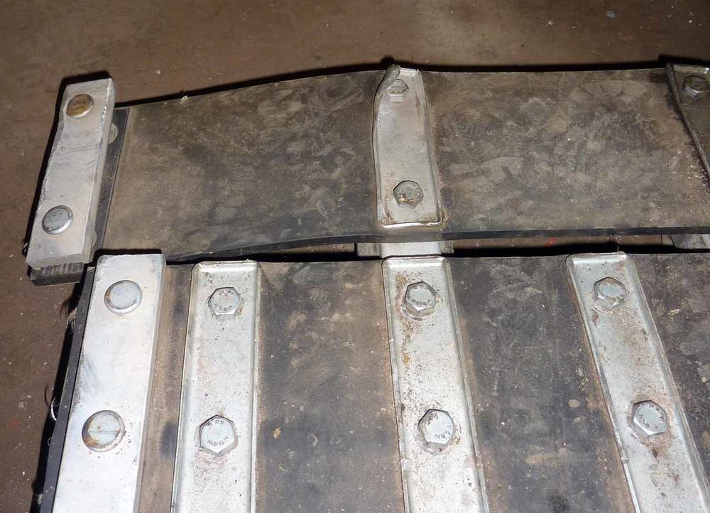

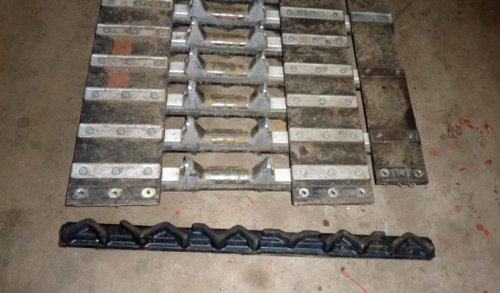

I had been tasked with replacing the inner most track washers that were bent. Of course I added a few extra photos of the track for fluff effect. These were remove via grinding the curl off to access the bolts. The water bottle is for cooling. Can you smart fellows tell us what the bottom photo shows?? :thumbup:

the inside track seems to be hitting . replace that white roller guard . could it be the tracks needed to be run tighter?
jim
alryA
I'm told those track plates only get bent when the operator has run off trail or gets stuck. :smileywac

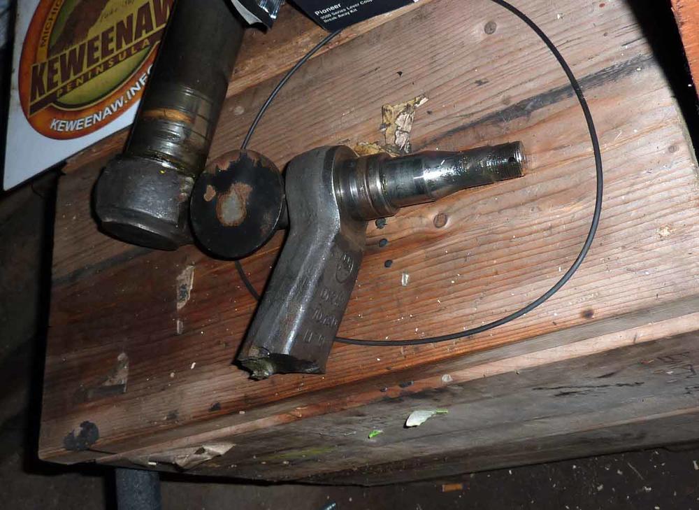

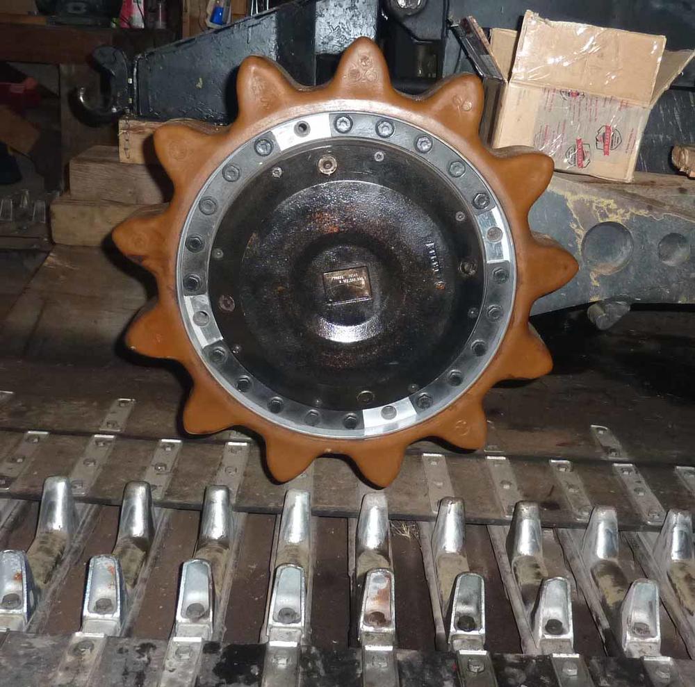

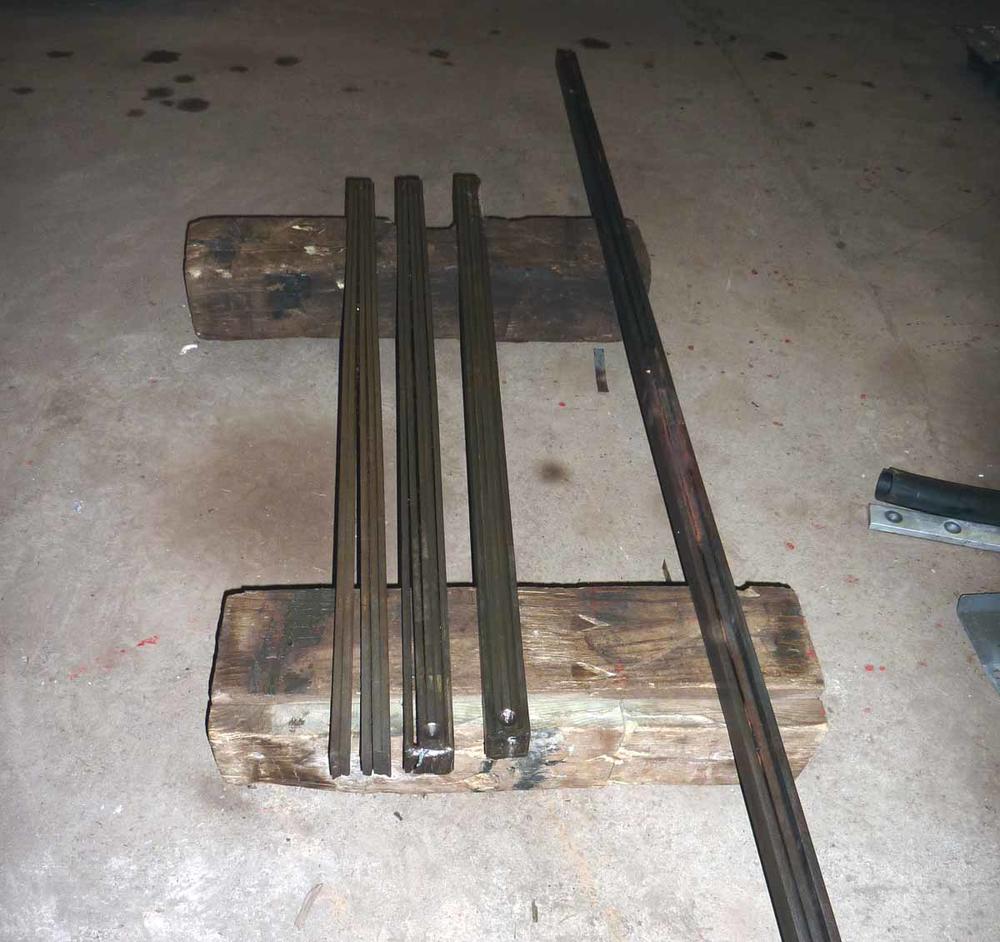

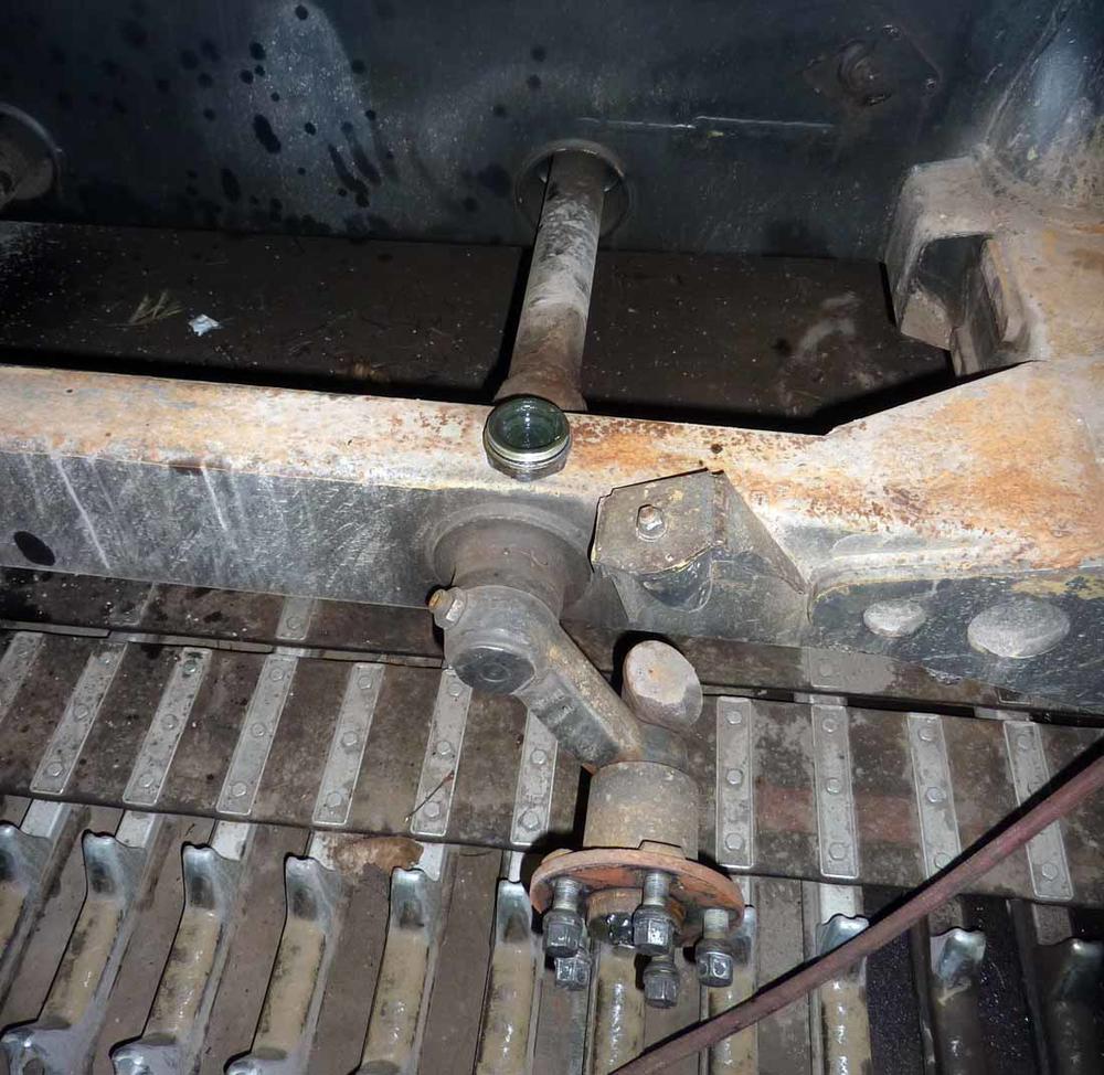

Here are photos of some of some suspension components and drives sprokets taken today.. The 1st one is part of the torsion bars used in each machine. Do note, 2 of them go all the way across so they are longer. Next are 2 sets of driver cogs on machines that are in the shop today. Yes they are different. Then 2 idler arms and yes, they do break.
Last one is a welder working on suspension breaks.

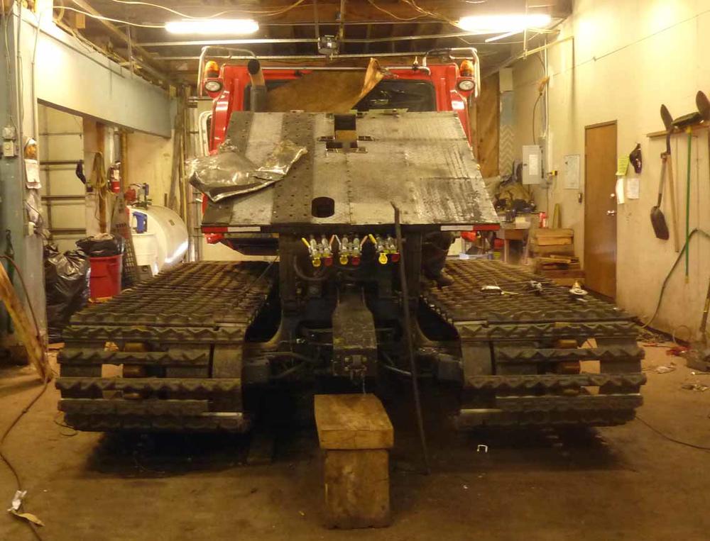

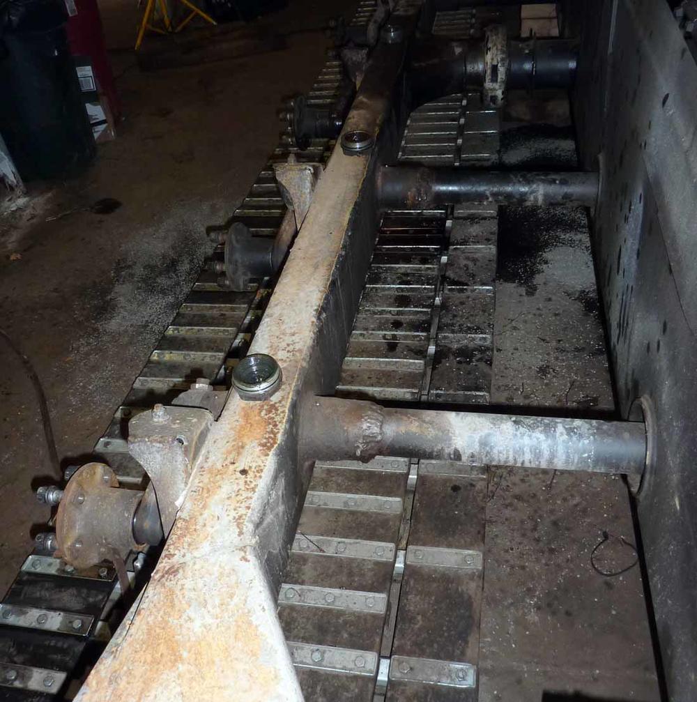

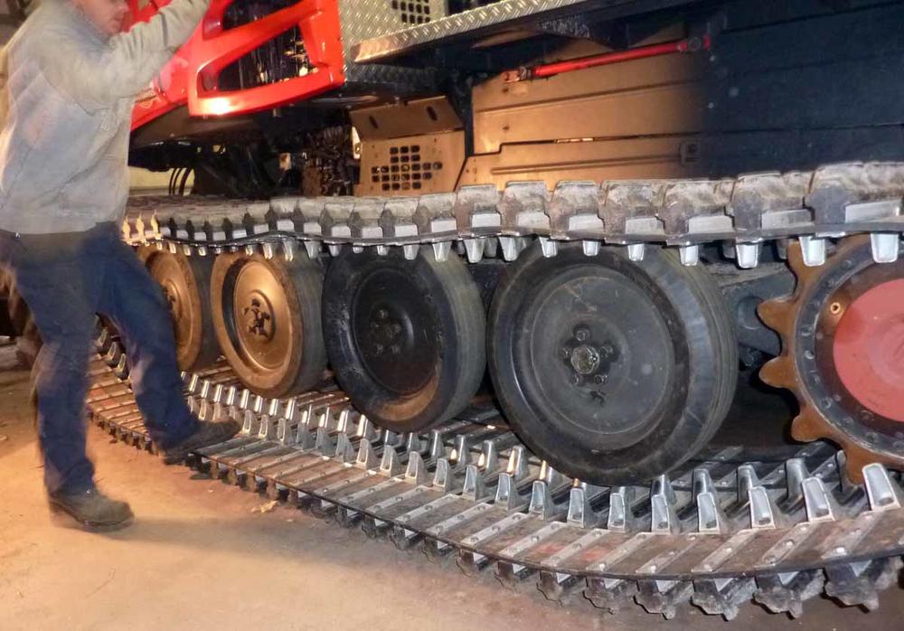

The tracks on the 2nd PB-400 were dropped today so as to service the hubs and replace one torsion spring and its idler arm.. In the 1st photo you can see its up on blocks and the tracks are lose. The operator has used this machine for two years and this was the 1st suspension grief he'd had. As stated earlier, this machine has over 8000 hours on it. First thing was to replace the gear oil in the planetary drives. These are two speed type drives.

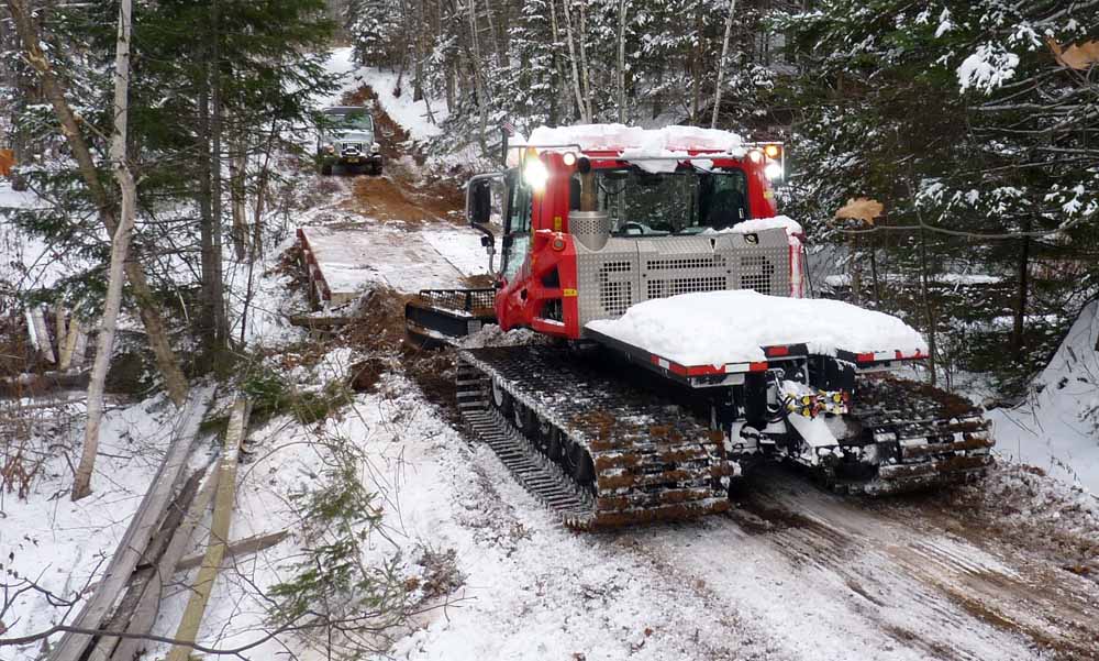

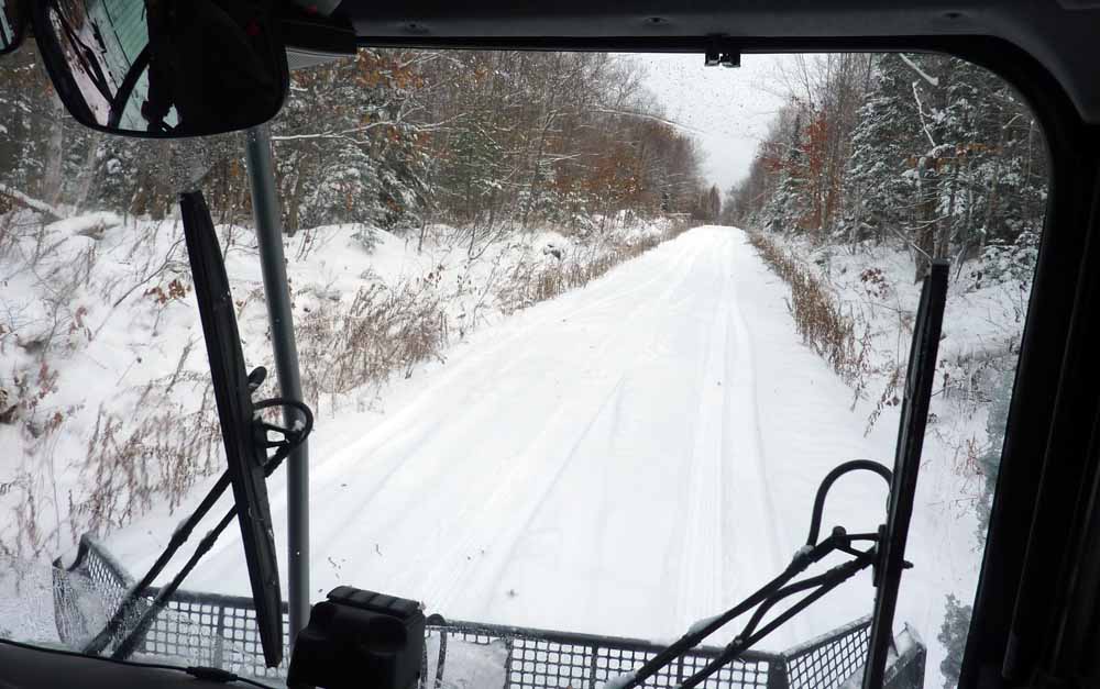

We had a Bully out doing work on the trails today. First one shows the heated wiper blades someone mentioned. Was that here?? 2nd is the operator carrying snow along the trail. This helps to knock more air from it. The real reason we were out was to help with a bridge installation. The bully pushed the temp bridge around, then dozed dirt in. There is not enough snow here to safely groom.

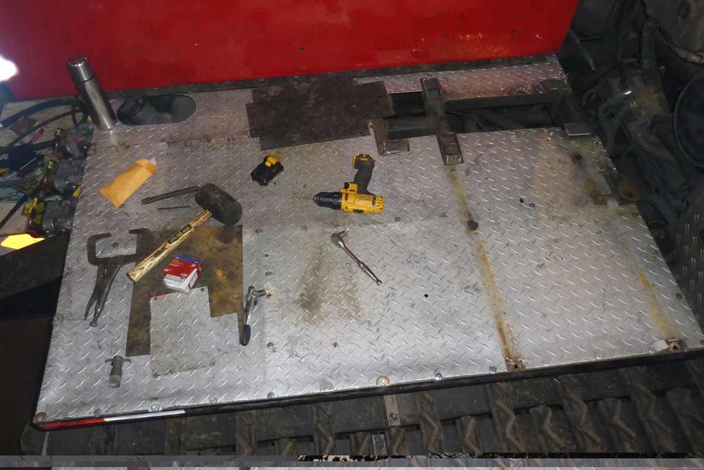

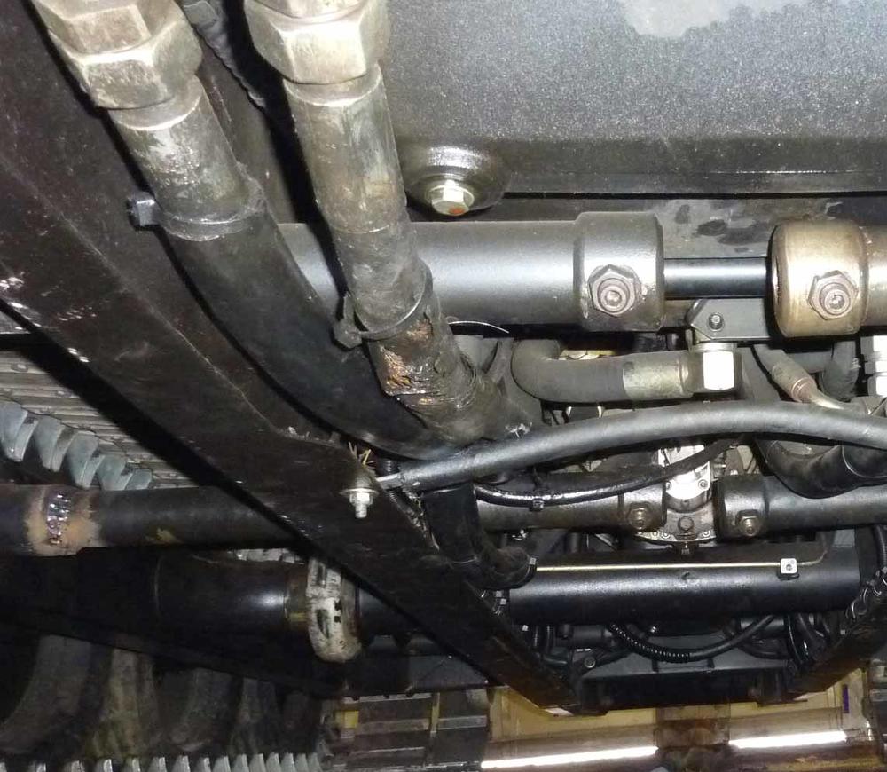

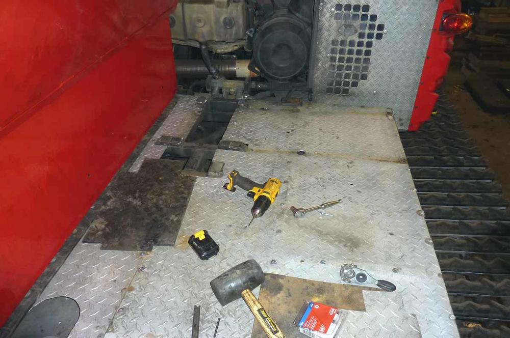

More "less than exciting" photos from a bully shop. First 2 photos is plugging holes in the deck that were created when the goose neck hitch was removed. Plus replace the 50 loose decking rivets. Gee this decking is beat to death. The red thing is a tool box we added. Kind of a poor photo of it!
The last 2 photos shows a blown drive motor hose to be replaced next. :smile:
