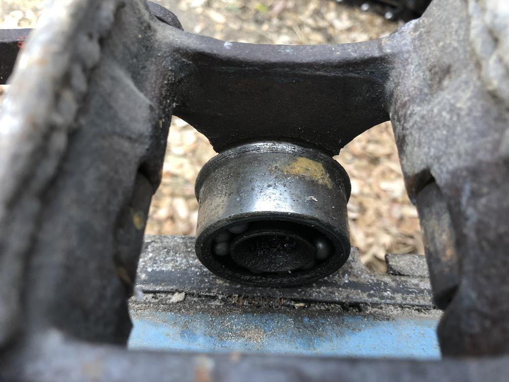

I could use about 20 rollers about 10 need to be changed and 10 for spares, the problem ones have the flange worn badly but otherwise ok. is there a fix for that or are they junk?

well you have more than a worn flange issue, the end cap are gone also, thus, when you grease them, the grease just comes out the other end and water gets in and then you have a RUST issue, looks like the grousers may have issues also.
so, 10 dollar or 80 dollar roller?
fyi, no good fix, just paper weights

thats one I changed already. What does 10.00 roller look like? Between 0-100 0 being like the roller in the picture and 100 like new. Marty

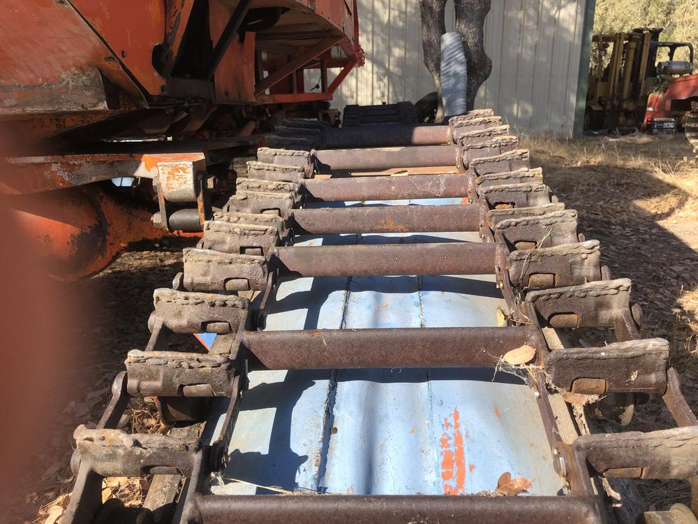

what do you see wrong with the grousers, I'm a Tucker newbe but a quick study. Marty

yes, the roller in your photo is a 10 dollar one,
as a newbie, we can help with understanding the complex issues of the tucker tracks, the grouser looks like it has been welded on, first issue, the grouser is hardened to Rockwell 44 and welding destroys this and next why was it welded on?, the link rollers/spacer that go through the spool need to turn freely, if you can, post more pics of the tracks and rollers. see what advice can be offered,

I think the welding on the grousers is ok, someone in the past built it up for wear or to make them more aggressive, I have had the links apart and they still fit snugly without any ware shoulder where the drive roller rotates. I will give Clyde a call, this old Tucker came from Tucker in the recent years as a project from the guy I got it from not running, he got it running and made some improvements now its my turn. I will be using it for cabin transportation give or take 60 miles a year 10 miles at a time. Thanks for the input and the help with the rollers it is much appreciated. Marty

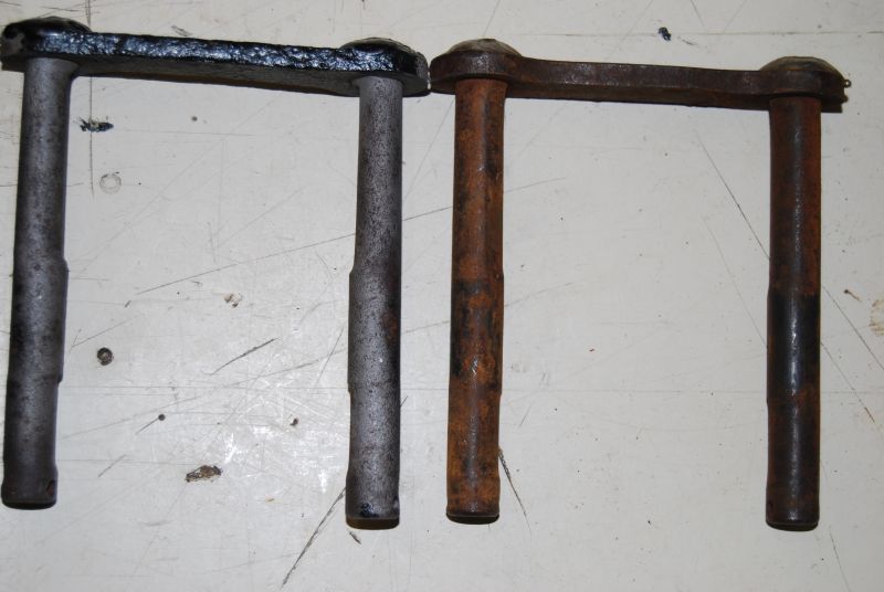

Almost all of mine have weld on additions as well. Any non-snow contact will eventually wear the grousers flat. A couple have the wedge cuts like yours (my welds are amazing given when it was done, and the metal is definitely harder than yours!) while the other pair have a rectangular 'tab' welded on to create the same high point. That is almost a necessity for east coast Tuckers needing to stay planted on ice.
The wear on the links won't occur where the drive roller rotates (the only time it has pressure is the 8-10" while in contact with the drive sprocket). The issue is everywhere else . . .

The links that I have pulled on mine fit the chain snugly and do not have the ware that is shown in your picture. I was thinking about lubing them with graphite to give them some lube without grease as I think grease would pick up dirt and be abrasive? Marty
originally, the links were assembled with no lube of any kind,
you are right about grease and dirt, even with graphite, the link and grouser will still wear, they both are hardened to Rockwell 44
starting with cleaned link shafts and grousers holes for the links, that will do a lot to help them survive more than just about anything
