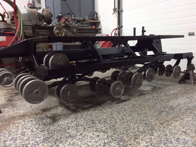

Steam cleaned the chassis and broke down all 16 of the spring packs for a soak in 'Evaporust' and sand blasting.
Overnight soak brought back the 'new' steel.
Got the chassis inside and removed the rotted sheet metal were the battery leaked and beef' up the frame work to support the back of the body.
Fab'd up a new support with a 1 1/4" receiver hitch.
Next will be a few brushed coats of POR-15 top coat chassis black on all springs and frame.
Mill666er
I got all of the springs painted and reassembled with new hardware.

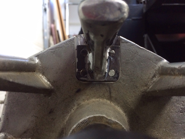

Had to make a replacement tooth for one of the drive sprockets. I wasn't sure of the material, it seemed heavier than aluminum so I make one out of steel that just slips on the casting.
Put the tracks back on but will need to adjust the mounting angle of some of the springs to get all of the bogie wheels with equal pressure.
