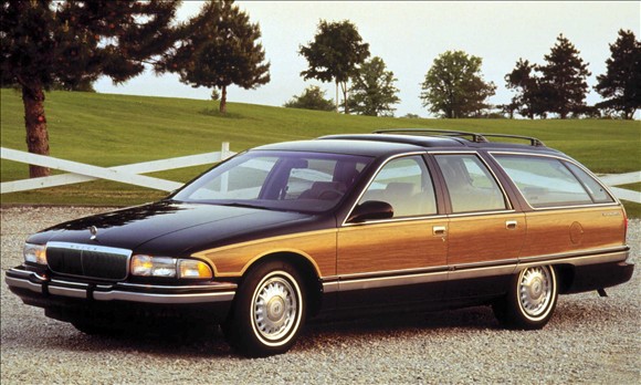

It's a full sized GM station wagon in near perfect condition (the ones from the 90's that looked like stretched out Taurus wagons), even the engine looks brand new. It looks good and sounds good, and the price is right. Many of the similar ones I see advertised claim 24-25 MPG highway.

Andy, is this the model you are looking at?
