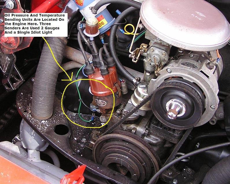

But to test when your engine is cooked, special modern digital thermometers are best: See Photo #3.
In fact, for safety you might want one of each. I'm sure that should be sufficient for your needs. :moon:
