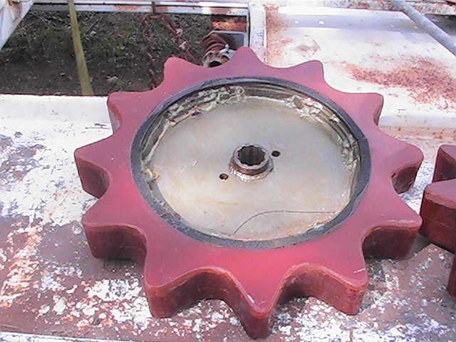

I did get them back will take a couple of pictures today and post....they're a lot heavier and beefier than when I sent them down.
mtbxdrew
Boy they look nice, can't justify the price tag tho on a machine I got for nothing
