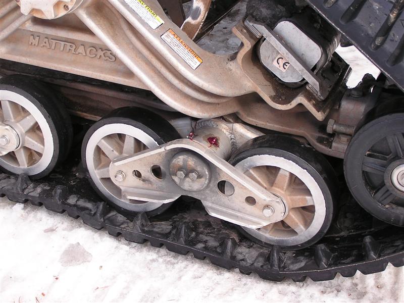

Today I was greasing the mattracks on the F250 and found a broken idler wheel bracket. This is the 150M1A2 model track set made for up to 12,500 GVW vehicles. They are made mostly of aluminum including the main frame supports and other parts. I ordered the broken bracket replacement and the nylon inner bushing for a total cost just slightly under $200.00 for both. Shipping 2nd day UPS so I should have it back in the snow and fixed by the weekend. I have no idea why it broke as I have been very careful with these and try not to abuse them. It may of been cracked slightly when I got them from the prior owner. That is all the damages we have had on these so far this winter. We will replace some idlers and check the tracks over througly at the end of snow/mud season and reinstall the regular wheels. We average about 18 miles per week of use to date since early January.

Looking at the 2nd picture it appears that the inside flange of the side frame is not continuous. This allows the side frame a weaker place to bend or flex between the flange end and the tube the shaft goes thru. Alum. doesn't like to bend much or often before it cracks. The bottom of the outer frame appears to have a noncontinuous bottom flange also. These alum. frames would be expected to fail from repeated side loading.
Think about the side load imparted to both the front and rear frames when turning.
Just my 2 cents worth.

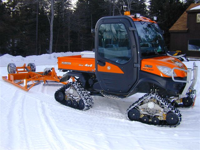

Our FIRST problems happened on our Kubota RTV1100 when the nut on the driver side front loosened up and it wiped the bearings out with just 30 hours on them...But Mattracks gave us the parts to fix them.

Our SECOND problem is the 3/8" bolts on the large idler wheel are sheering off, And sending the connecting link into the aluminum drive sprocket. rear tracks this is the rear idler, front tracks the front idler. This is the new m3 version track system. the" lite foot "used to be one piece. Mattracks sent parts, but no solution to the problem yet. The other three tracks are doing this too, as I took the bolts out and they are all bent.

The outer bracket is stronger the way it is designed and made. The inner one that is cracked has a cut out to allow clearance for the main bracket and pivot movement. I can probably continue to run it and it will only break but not actually fall off. It will load the other side and possibly make it fail sooner. The front tracks on the truck going down hill or turning do take much of the load and you have to be careful as they will try to dive in and the weight of the vehicle is mostly transfered to the front tracks with a long wheel base truck like mine. Thanks Gypsy for your comments as they do parallel mine on what is probably happening to cause the failure.

I agree it does , but...we explained to mattracks what we wanted to do, and they advised these new m3 design tracks,which are the ones we purchased thru a state grant. The drag is only 460 lbs. and you can pull the tongue around by hand . The problems we are seeing is nothing strange to mattracks ,so they have seen these things happening before.
If sidehills and snowdrifts are a problem for these , then where should you use them? maybe ice fishing or something? I know this doesnt compare to a snowcat but I think people think they should be as good as one and its never going to be.period.
