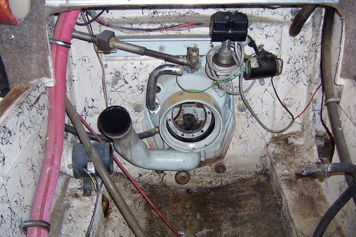

Well, I ended up not going anywhere for easter so I decided today would be a good day to remove the 4 cyl from my boat. Not a big project but I figured maybe we could get the boat area a little more active!!!!:wave:
First pic, Great little fuel efficient 4 cyl Just does not have enough power!!!! Its gotta go!!!!

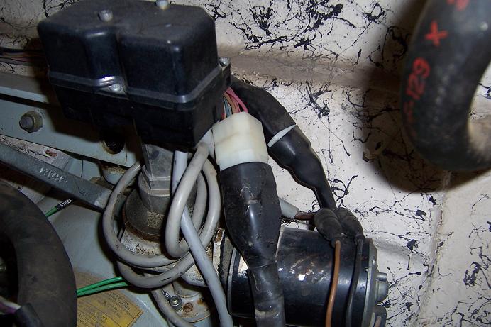

Close up of throttle and fuel connections. Electrical connections in next pic.

Here is the 280 out drive. Remove this bolt, flip the helmit out of the way, and remove bellows clamp on both ends. Next remove four bolts that hold on the top gearbox, lift gearbox to remove. Constant velocity u-joint will come with gearbox.

Support engine from hoist, remove six bolts visible in last picture(Squeeze large rubber O-rings to seal out water). Remove engine, all took less than one hour!!!!! Now V-6 or V-8????????? Suggestion anyone??????:weneedpic Pics of the install in your boat would be great!!!!

There's no motor mounts ? Just the bolts to the outdrive ???
That's a little scary....What kind/size of 4cyl. is it ?
I have a nice 318 in the garage that came out of a boat. Boat needed new stringers and motor mounts. Boat is about 2/3 done and I've lost interest/momentum on that project.
No Pixie no motor mounts !!!!!!!:smileywac :4_11_9: It seemed a little wierd to me also?????? Hmmmmm 318 you say???? How about some pics!!!!!:wave:
