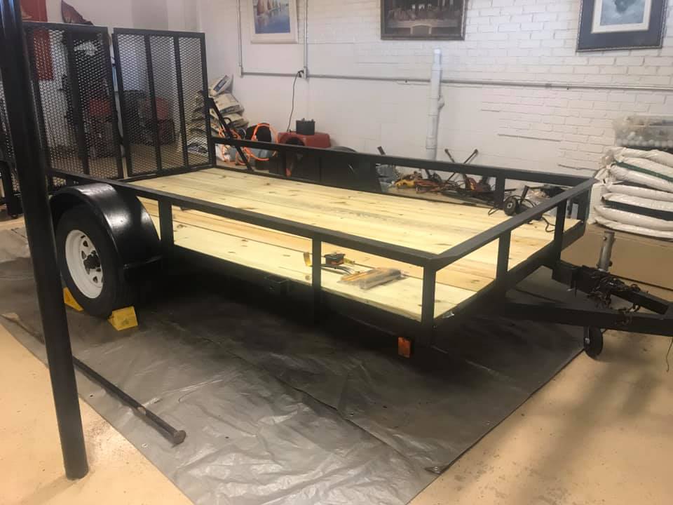

I finally got this project done with big help from a friend. He had recently done his trailer and offered up his heated garage to get er done. Together we made short work of it.
Saturday we tore off the 2 layers of old deck (I had put plywood over top of the original floor as a band aide. It worked longer than I expected but was in dire need of being replaced). Sanded and power washed. End day 1. Sunday, day 2, removed wheels and painted ...wheels off to get inside the wheel wells. Monday, day 3 ..put wheels back on, touched up hard to reach places with spray paint and put new deck on. Wa La ...all done (except for new lights to be installed later).
Looks like a new trailer but it's 20 years old. A big thanks to Jim W. who led the way on this project, and is in all the pics working while I took pics. Otherwise ...I did work. Honest.

Nice work. I replaced the deck boards on my 18 footer a year ago. I had a lip to hold in the boards. Had to use a jack and some ratchet straps to bend the last board to get it in. Yours looks much easier.
Might look easier but it was not. Mine has the lip at each end also. Tried to bend the boards to force them into the lip to no avail. Ended up cutting an 8" section out of the front lip to set each board on trailer then hammer to each side till it was full then put in the last board. It worked.
