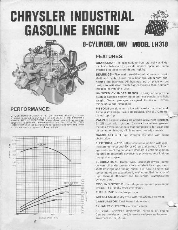

Here’s a page from a Chrysler 318 Industrial brochure. Note the numbers: It says 187 Gross horsepower @ 4,000 RPM, and if you continue reading, that number was obtained without even a fan. If you look down to the graph area and look at Continuous Horsepower you’ll see about 98 HP @3,200 RPM. Now reduce that by 30% for operating at 10,000’ elevation and you’re down to a downright measly 70 HP.
