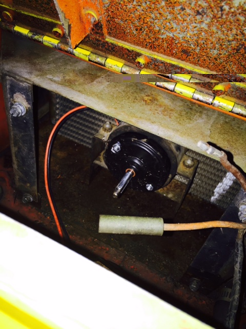

Also some pics of the fan under the "hood".
Anyone know is this fan to defog the windshields?
I replaced the motor and it blows forward.
Thought maybe it should blow back into the cab to defog the windows.
Just learning about this machine...any help is appreciated!

I don't suppose it's possible you replaced the motor with one that spins the opposite direction. ??
They are sometimes made in both directions of spin for different applications.
300 H and H
With DC motors, all you need to do to reverse directions is to switch the positive and negative leads. Or put the fan on the motor shaft turned around the other direction. Should be easy.

The photo seemed to show only one lead, so I assumed it was chassis grounded. If so, reversing polarity would be less easy, but still not impossible.
Reversing the blade may be possible, depending on clearances. The blade center does not appear to extend past the blades, so reversing it may move the blades too close to the motor. ??

OK, I'm assuming the fan is supposed to direct the air into the cab then.
Easy to switch polarity. Not sure if the old motor was switched or designed to operate backwards.
It's just weird that the fan is mounted this way.
There is not room to mount it blades in, the blades would hit the heater core
So I guess the air will be drawn over the fan motor, polarity switched and or backward mounted blade I'll see how it goes....

behind the fan is a heater core. The fan pulls outside air over the heater core and heats the cab. It also defrosts the front windows. If you have a shut off on one of the lines that feeds the heater core the coolant flow can be shut off. Now your heater core will cool and you can use the fan to pull cold outside air in to cool the cab. If you don't have a shut off, i would highly recommend installing one. a/c is very nice in a cat on a warm spring day.
THANK YOU for the clear explanation. This is what I suspected was the case. It's so weird that the fan is facing forward, I guess it'll be fine reversing polarity on the motor. Very interesting about the shutoff idea. I can imagine it gets pretty warm on a spring day with the heat from the motor. Thank you for that advice!
