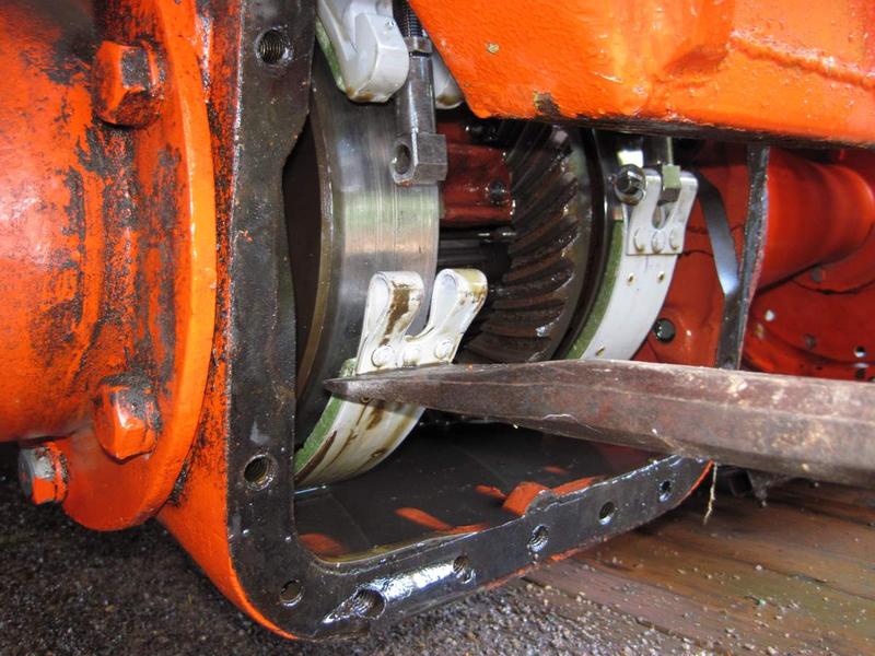

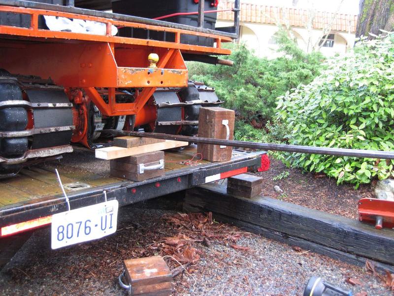

Allocate a day for the work the first time you do this, but subsequent trips into the rear end will only take a couple hours (you'll get speedier with experience). There are linkages inside that will allow you to further tighten up the brake bands. Photos below show how I use a 6' steel rod to lever the brake bands tight enough so that I can slip the pin back into place.

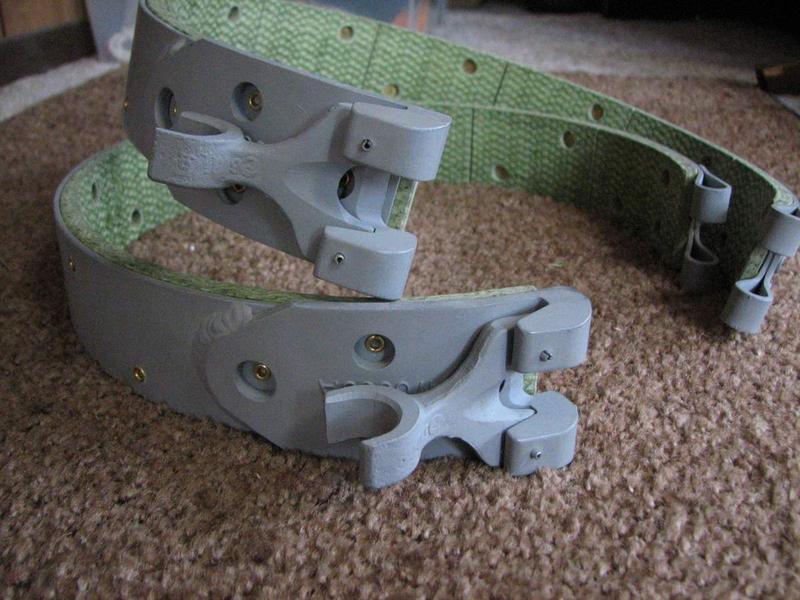

If you decide that the brake bands are kaput then you can get them rebuilt at Spryte Improvement -- Pat will take good care of you.
