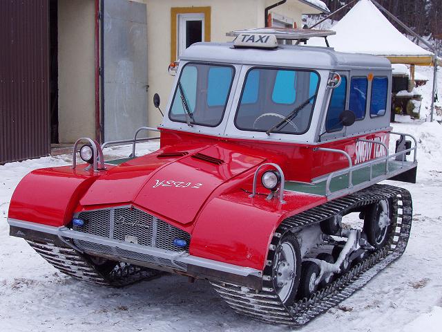

I recieved a parts request from a man in Poland. He sent along a photo of his Snow Trac and I was surprised when I saw that the Snow Trac was being used as a Taxi Cab!
His Snow Trac Taxi is a 1971, 1600cc engine, version.

He has a problem with his Variator Belt. Snowcat Operations provided me with this information about the Variator Belt.
http://www.gates.com/catalogs/file_...=gates\catalogs
Ok here is the info on the belt PDF file. Go to page 49, right hand colum and part #2926V616 Price is $147.42. Now I am told that this is thinner than the origanal but I am sure its of better quality construction. It says the O.C. is 63.3" inches and is 1-13/16" tall.

Wow, that is a nice looking snow trac! That's probably the nicest one so far!

He has upgraded his headlights, there are small fog lights added in the front grill, review mirrors and even a set of side warning lights. The metal is in better condition than mine too.
I like the two-tone paint job too. From the factory, the civilian versions came off the production line in a reddish orange color. Most of them seem to have had a white roof, but some roofs may have been painted the body color.

Very nice Taxi! I can get the original Variator belts if someone wants one. New old stock (NOS). Never used. I believe my source has 3 or 4 he is willing to let go. I will also be leaving for Canada now on the 19th depending on the weather. He is currently on a surpirse winter job and wont be back till then. So for the questions on the parts just wait till after then I will get back to you.

Bob is that also a diffrent steering wheel in the "Taxi"?

Mike, I want one! Send me an email so we can work it out. BTW I will be on vacation for a few days, leaving tomorrow about noon, back mid-next week. As for the steering wheel, yes it looks to be a different wheel. To my knowledge, all of them used a standard black 3 spoke wheel when they came from the factory.

Bob, could you ask him to post some pics of his interior as well? Sure is a very nice Snow Trac.

Hmm bad condition? Maybe alot of miles?

That's is a clean and neat machine.........:thumb:

That Snow-Trac Taxi is awesome.

sorry for late response but i was very busy last days. It nice to see to you like my friends snow trac. I have seen more of his works and he is really one of the best specialists and renovators of any wheeled or chain machines I have ever met.
BTW my friend has already bought the variator belt (thinner one). Unfortunately it is not working. It is to thin. We really need the original one: 1600x47x25 mm. We live in a hilly part of Poland. His house is about 800 m up to the main road. So sometimes he use his snow track to tow e.g. toyota landcruiser 80.
I will try to follow your advices more carefully now and take any opportunities to get the belt. and of course I send more pictures next time.
