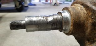

I need to plasma this one out and weld a new one in. Using calipers I am finding it is 1 3/8" at the part closest to the torsion arm and it tapers down to 1 1/4" closest to the threads. I am not finding a 1 3/8" taper to 1 1/4" spindle available online.
Can someone enlighten me??

………… how about a local machine shop,.... looks like the inner & outer brg. journals are the same,... with a new brg. & grease seal; you'll have your i.d./o.d. dimensions,.... ''whiz''wheel the welds & remove the old spindle,... :smile:
Snowy Rivers
As rough as that sucker is....smooth off the gnarlies and see just how well the bearings fit on the spindle.
You might be surprised, they might fit OK at the actual spot they sit.
Rather than cutting that stub off...possibly save it.
I have seen worse that ended up being quite usable....
These are not high load and or high speed...
If the bearings will (With some cleanup) slide back on and fit fairly well...they should be fine....
The seal surface has had a "Speedy Sleeve" installed.....get that sucker off and a new one will fix that area.
I am fussy about stuff, but years ago we had a bearing fail on a trailer and it was ugly.
After getting the old junk cut off and a bit of elbow grease later it still looked a bit abused....but was perfectly fine as far as being serviceable.
It's a shame that the torsion hubs were not manufactured so the spindle was a replaceable part.
(Slip into a keyed bore with a nut on the back)
