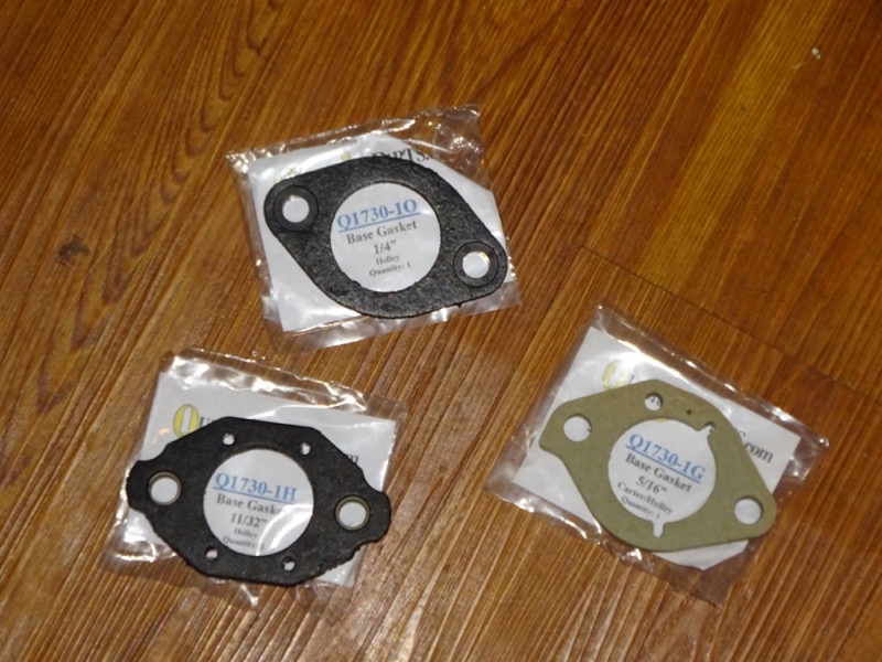

Spacers are $3-4 + shipping. Less than what an hour of my time would cost if I could find the right piece of wood.
These all fit my Ford 300/6. Carb studs spaced about 2.75". The one top/left is just like the one that was in there.
From QuadrajetParts.
