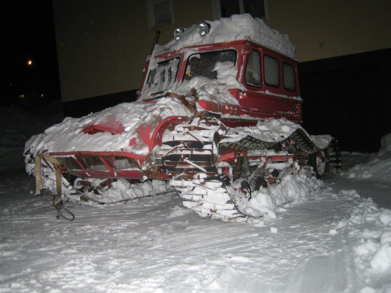

Here is the story of the restoration of my Snow-Trac.
I have lot of pictures so we take a little at a time.

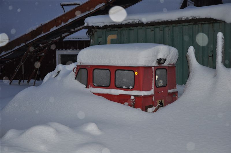

It all started almost two years ago when I bought this Trac-Master # 846
It had no registration papers, so I had to look for another machine with paper and use this for spare parts.
1. A lot of snow
2. ST4 B 000846
3. Home
4. Snowy engine. A spark plug has been out for years but the engine started anyway after some small repairs to the ignition and fuel system.

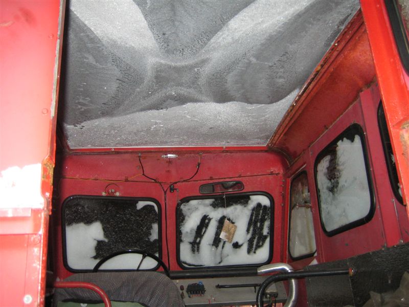

5. Inside
6. Sheet metal roof without roof hatch.
7. Rust and dents.
8. It fitted exactly in the doorway.
9. Ice scrapers is apparently unusual.

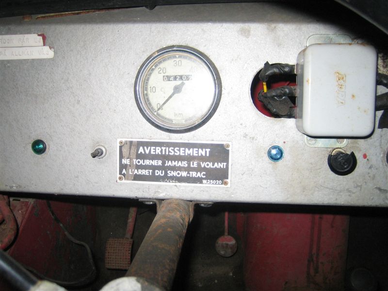

10. I have no idea why the warning sign are in French.

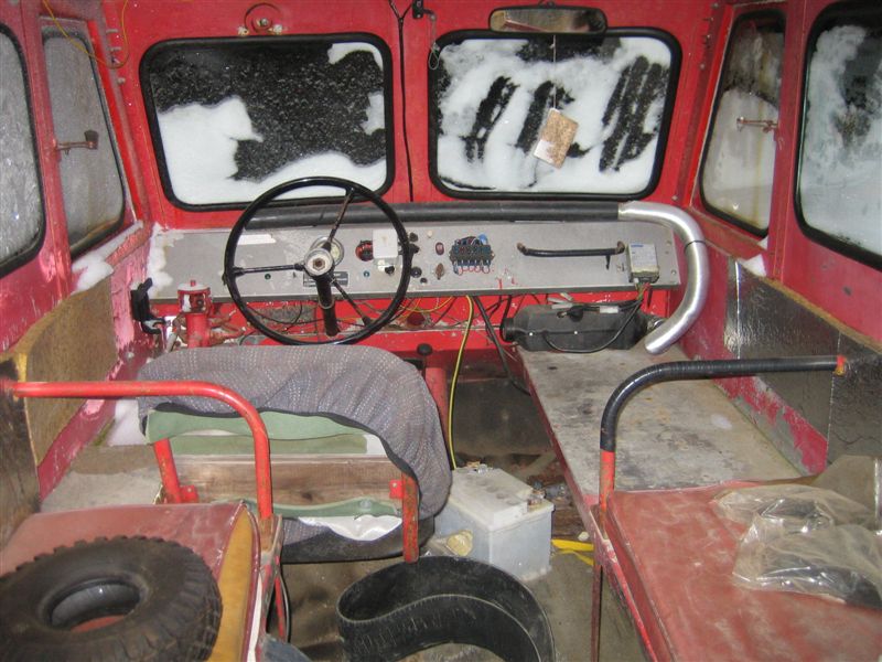

I noticed a heater hose running from the engine bay to your inside. Can you tell me more about it.
Snowtrac Nome
member formerly known as dds
the heater hose is comming from that wabesto fuel burning heater mounted under the dash which is a waste of gas because the fresh air heat thah engine has makes too much heat anyway
mackE
dds has the right answer but in this case, someone has cut off the heater boxes.

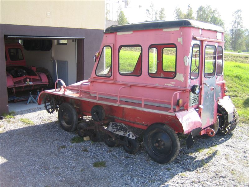

In September 2010 I bought this Snow-Trac # 1881
The previous owner had intended to restore it but it had been untouched for many years.

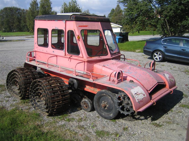

1. The new Snow-Trac...
2. ...with high cab...
3. ...the paint is coming off...
4. ...but the body is in pretty good condition.

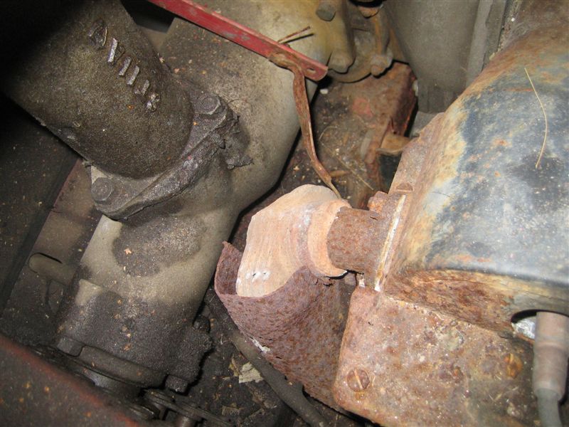

5. Engine is not working.
6. Rust on the variator system
7. Why is it always a big mess inside a Snow-Trac?
To be continued ...

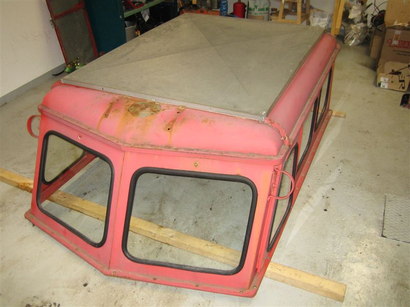

Since I do not like the look of the high cab the plan was to use the low cab from # 846
My friends felt I was insane who filled the garage and yard with scrap.
1. Here is # 846 now with the high cab.
To be continued...

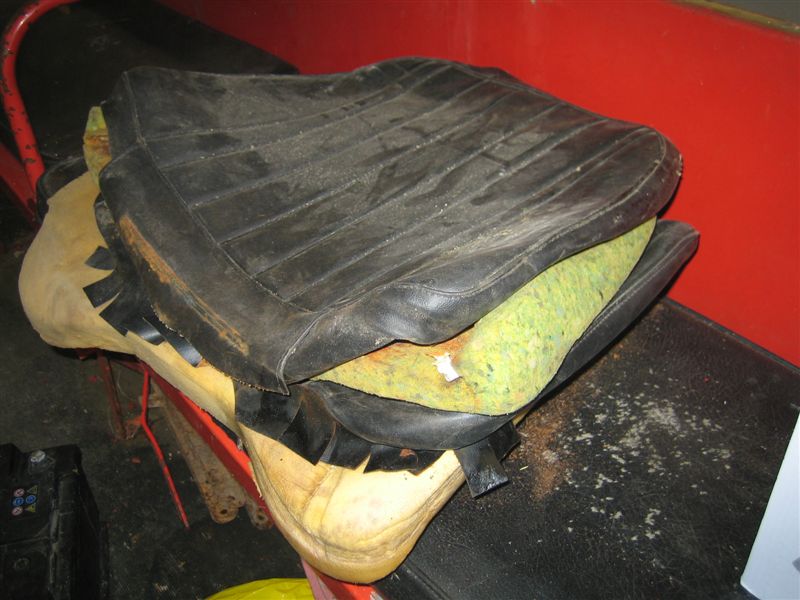

1. The seat needs a little work.

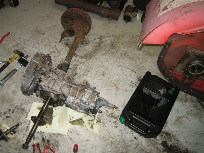

mackE
There was a lot of dirt in the engine compartment.
1. Too much grease on the chain sprocket.
2. This was nasty stuff.
3. Dirty, broken gearbox is finally out.
4. A little cleaning is needed.

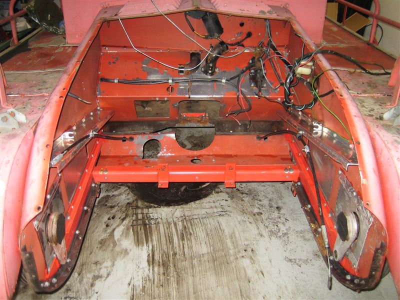

mackE

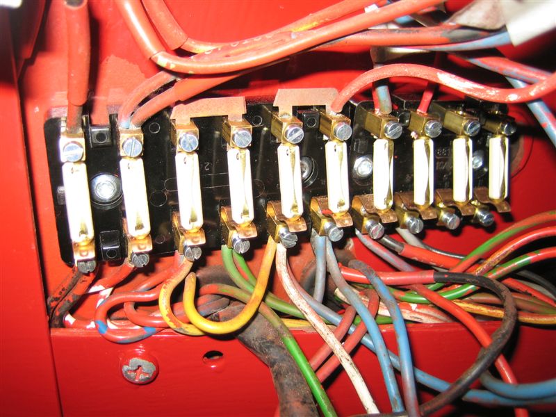

1. Now it's clean.
2. Some electrical wires must be replaced.
3. Beautiful colors in the fuse box but it does not work so well.
4. Dashboard removed for repainting.
5. Paint removed from the engine hood.

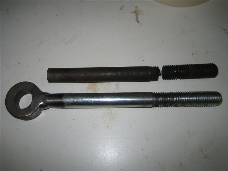

mackE
It was a pain to sandblast variator components outdoors in -20°C (-4°F)
1. Plenty of rust.
2. Everything did not come apart easily.
3. Finally got the piece out and got a new manufactured.

Snowtrac Nome
yes i have seen that broken eye bolt before mine came to me that way too i had a spare so i didn't have to make one

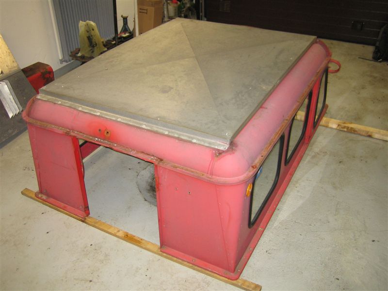

1. There were a lot of holes and cracks in the cab needed welding and some other small modifications.
2. Rear windows will be added. And a dent in the roof that needed to be straighten out.

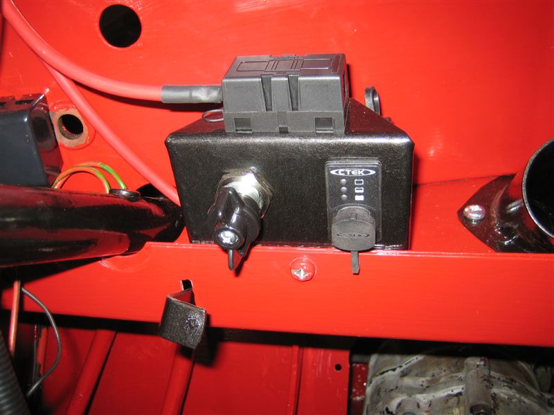

4. Main fuse, battery switch and Ctec comfort indicator panel.

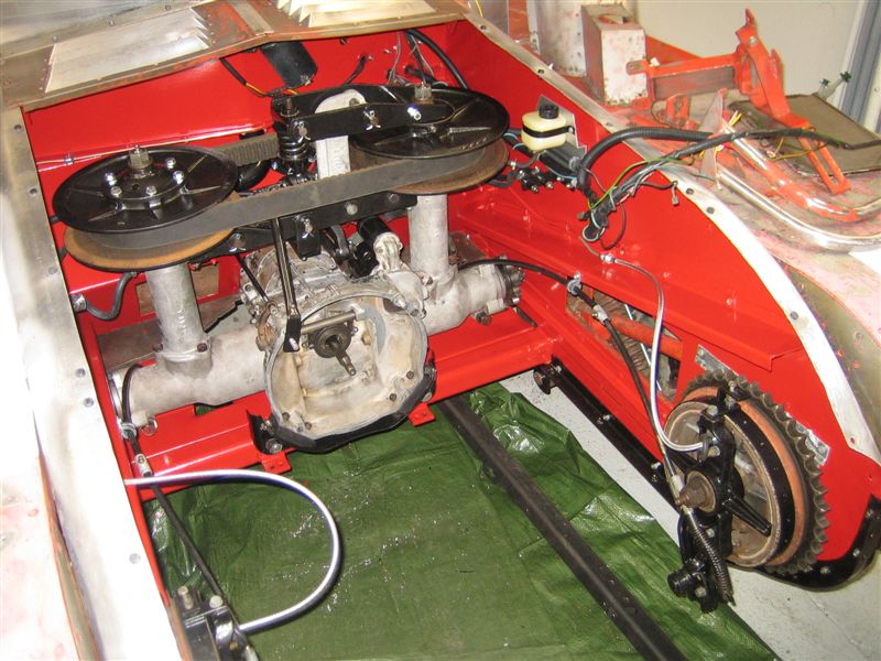

mackE
1. Ugly brakes.
2. Now it's better.
3. Brakes and variator assembled. The new front bumper lying on the floor.
