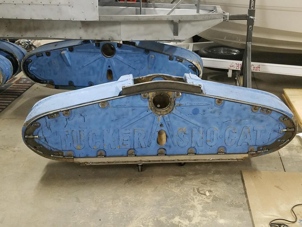

Just a little pontoon work. Trying to square up edges on the ends of pontoons. Then hopefully get to do some painting.

wakeupcall
great work and you are moving along quite nicely, good for you, can you post a picture of the nose rails?
Pontoon Princess, Here are a few pics of nose rails all of which are brand new !! Along with top and bottom rails and also new shoes made of stainless steel.
