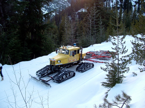

Greetings all,
I finally got my first snocat!! Woo Hooo!!:cool2:
I picked up this 1971 Tucker 1342 from a snowmobile club in BC Canada. They had been using it to groom trails. It is in operable condition now but could use some cosmetic repairs and TLC. I'll probably do some minor work this year and probably a complete restoration next summer.
I'm excited to get this thing on the snow!!! We NEED storms in CA!!:snow_smi:
Vance
Okay, let me try to add some pics:
1. Tucker in previous life in BC pulling a roller

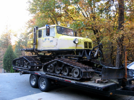

2. Just home on the trailer

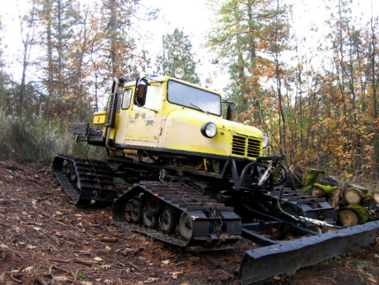

A couple more pics:

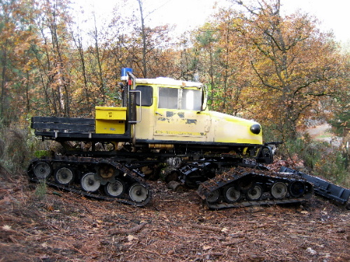

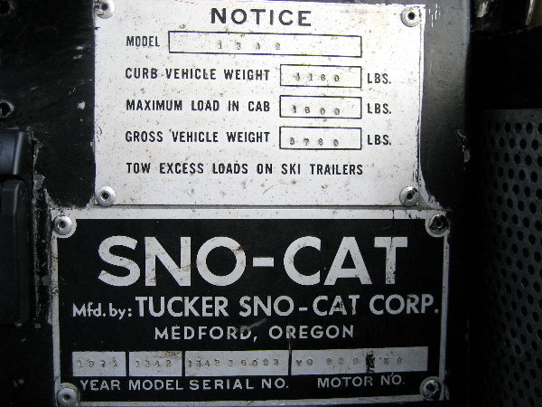

:applause: I like it, congrats.
Restore? well, I cant really tell the condition, But the yella paint has gotta go.:hide:
So what are your plans for this cat? Hunting vehicle? Cabin access? Scaring the heck out of the neighbors?

Yeah but he has a really cool blue light on top.
:spacecraft:
It probably spins around to confuse the Kristi owners (or at least BigAl) into thinking that an alien space ship has landed to return them to their planet. :tiphat:

Oh ya - that paint has to go. Not only is it faded yellow :puke1:
but the PO tore off all the old stickers to start getting it ready for paint. If definately needs paint now. As it is late in the year and I don't have a paint booth... I'll probably do a rattle can job in it for this winter and then a real paint job next summer.

I think there was an overlap. your ID tag says 1342... I would have agreed with the 442 identity:confused2:
I've seen newer style 'Cats with the steel tracks...like early 80's i think, but all the older ones like yours (and mine) I think came with steel only.

I understand the confusion over the nameplate (1342) and body (442) but have an explanation for that - the retrofit instructions end with the replacement of the nameplate. Seems odd but it is there. In the next week or so I'll scan the pages and post.

It may say 1342 but the track carriers are definitely 1500 series(5 bogie wheels). You can tell by measuring width and length of caririer track. Should be 28" wide by 84" long approx. Also count number of grousers..should be 26 or 27 of them. Nice retrofit.

The retrofitted tracks are actually 24in wide. You'll notice that these have only two belts vs the 4 of the 28 wide tracks. I've seen this style on other retrofits and early 1300 series cats. I haven't counted the grousers yet.
On the blade attach. Here is one pic but I'll take some more later. Yes, the blade frame is attached to the axle and the lift is from the frame. At the axle end there are plates attached to the axle perches below the spring pack. There are removeable pins that attach the plow frame to the axle. The lift assembly on my cat is really ugly.:pat: It looks like there used to be a winch plate and then someone added the hydro lift assy. I'm going to re-do this to something cleaner. Maybe even incorporate a winch back into the mix.
I'm still struggling over the best way to attach a blade to these small cats with aluminum turntables. On one hand it seems better to attach everything to the frame so the cats momentum pushes the snow. On the other hand, the tracks provide the bite so attaching to the axle may end up with less stress on the alum pieces. In any event, you don't want to push much with the blade on this small of a cat.
