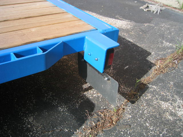

There license plate holder is rubber so it will bend & flex instead of bending the license plate. The tail lights are also attached to very heavy angle that protects them on 2 sides and extend about 3/4" wider than the tail lights to offer some protection to the side also.

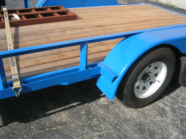

You will also see that the rail does not go all the way to the back of the trailer, it terminates at the rear of wheel covers, this is because a wide implement will be easier to load and pallets will be easier to unload without that rail going all the way to the rear. By terminating at the rear of the wheel covers, it provided a significant amount of protection from abuse and also offers rigidity when they are used as a step.
There are stake pockets and a reinforcement rail too.

The ramps are removable ramps instead of tip up ramps, I like them better because long loads can be more easily accomodated if the ramps don't tip up. I had considered slide under ramps, but it seemed to be overkill for my needs.

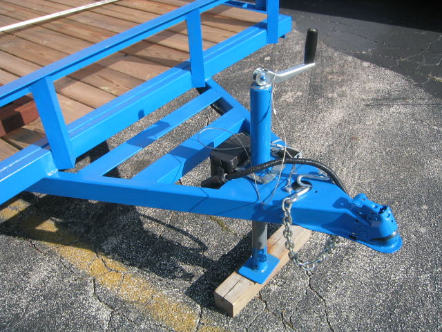

There is an LED marker light at the front corners for visiblity. All the wiring is heat shrinked at the connections. The hand crank is a heavy duty unit, much smoother and easier than the cheap-o one I had on my former trailer.
The rear is reinforced with a heavy wall box tube and the entire frame is made with box steel instead of angle iron. The only angle iron is the rail that runs around the front 2/3rds of the trailer and part of the tongue where I can drill and install a trailer box to hold chain.
I had the fenders reinforced front, back and under the center because people often use them as steps and the fender steel is pretty light and tends to bend.
The ball clamp at the front is a heavy duty type that secures and locks as opposed to the more common lighter duty types.

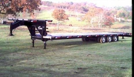

Bob, wanna use my new trailer? My old one was a bit too short. This one is 35' with three 12k axles. Your stuff would probably fit on it without and issues. :D

Very nice trailer and I hope that you get a lot of good service out of it. That is the positive side of my comment...... Now, not to be negative, however, I suggest that you visit this site and get all the lighting and reflector requirements implemented. The thing that I noticed immediately was the lack of reflectors and the red/yellow light on top of the fenders. One of the reasons that I mention this is because there was a vendor at the Carlisle PA swap meet that had a new home made trailer out for its maiden trip and he was pulled into the weigh station for inspection. The DOT guys gave him a whole bunch of violation summons for not having all the required reflectors, reflective tape, corner lights, etc. The fines totaled up to over $500. He said that he was going to go to court to try to get it knocked down, but it would have been a lot less expensive to check on the requirements and add the lights had he known........ Junk...

Junk . . . I'm guessing state laws vary? This trailer has 2 side lights, no reflectors. My old trailer had 1 side light, no reflector. Both passed inspections to get their license plates. But I will look into reflective issues because now you have me thinking!

The site that I referenced is the Federal Department of Transportation. Those are the basic requirements that all states must abide by. The individual states can require additional lighting for trailers that are registered in that state, but they can't enforce it upon trailers traveling through the state that are registered in other states. They can and do enforce the weight limitations and brake requirements no matter where the trailer is registered. Enforcement is selective, but you don't want to run into the guys that do truck/trailer inspections and enforcement, because they know all the rules and regulations. That is how they make the money for the state. You also want to make sure that the registration is for a high enough weight class for whatever you carry. Registration fees are usually based on how much weight you declare on the application that you intend to carry. Even though the trailer is capable of 7000 pounds, if you register it for 2000 pounds and you get caught hauling 4000 pounds, you are overweight by 2000 pounds.
